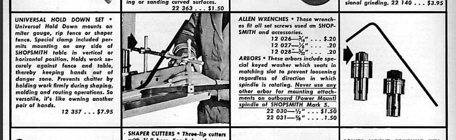

You say it is a bit shorter. How long is it? The current molder/dado arbor shaft is 1 15/16" long. The thick washer is 5/8" thick. How wide can you set your multi blade dado? The max on the SS dado is 3/4" with the stock set.
First, I think you are just missing the thick washer. As for the key way. Does anyone know if the 10ER arbor had a key way. Looking at the 10ER accessory catalog that arbor is basically the same as the current arbor but the catalog says the thick washer is 3/4". Does anyone have a known 10ER arbor and does it have a key way. It is hard to tell from the picture in the catalog but using a magnifying glass it looks like it has a key way. However, the catalog is dated 1953, the end of 10ER production. Maybe the first/early arbor had no key way.

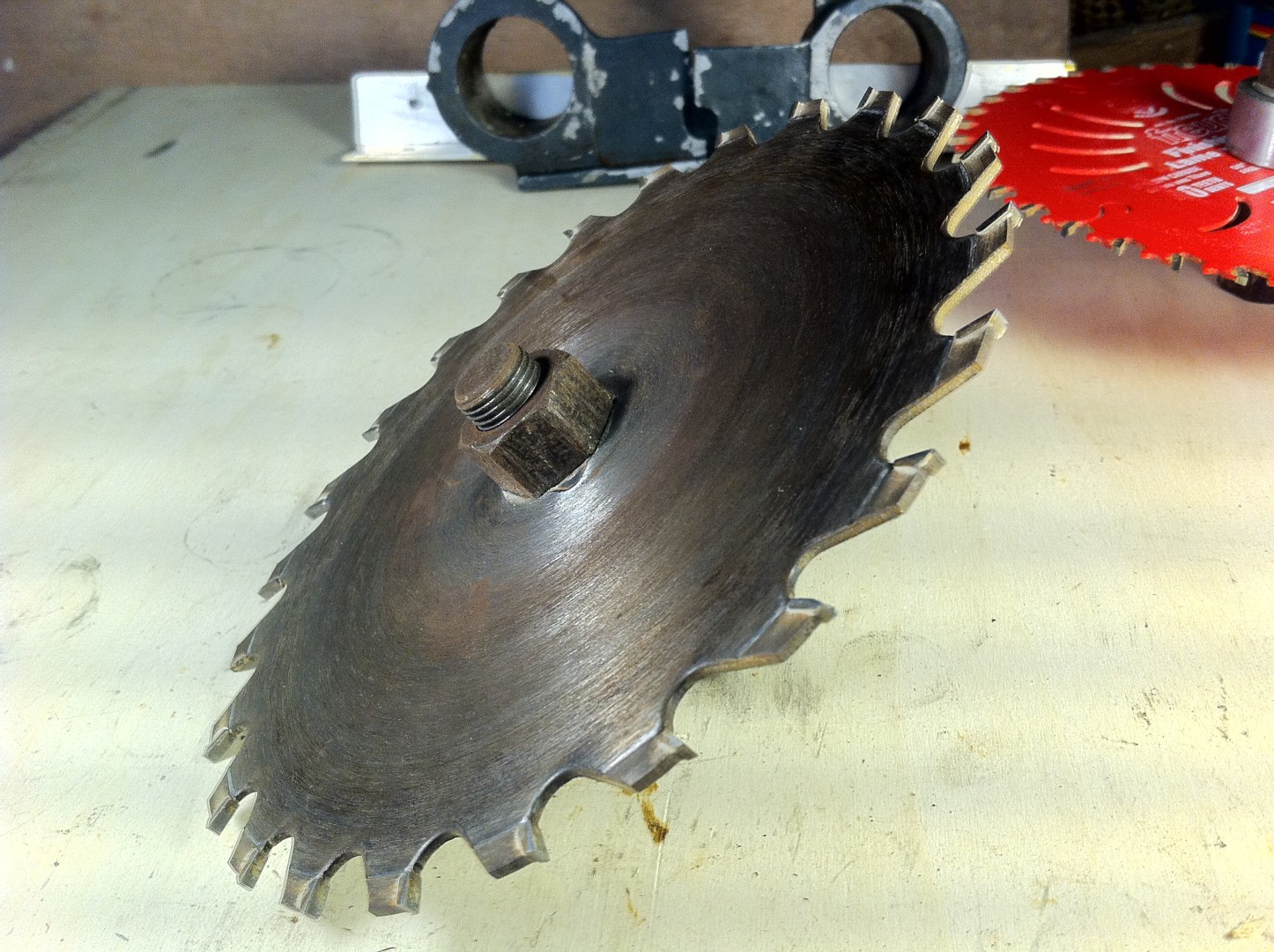

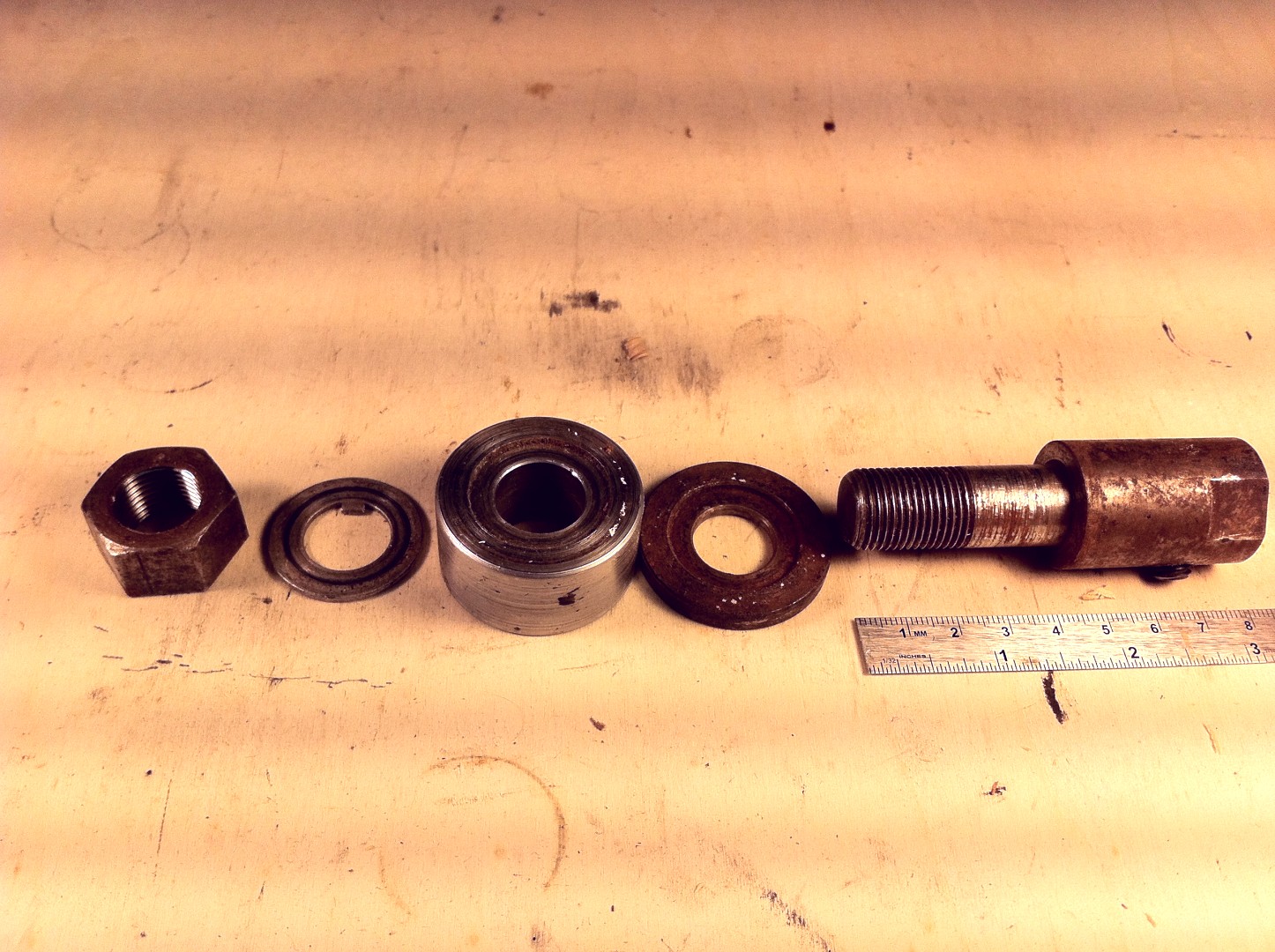

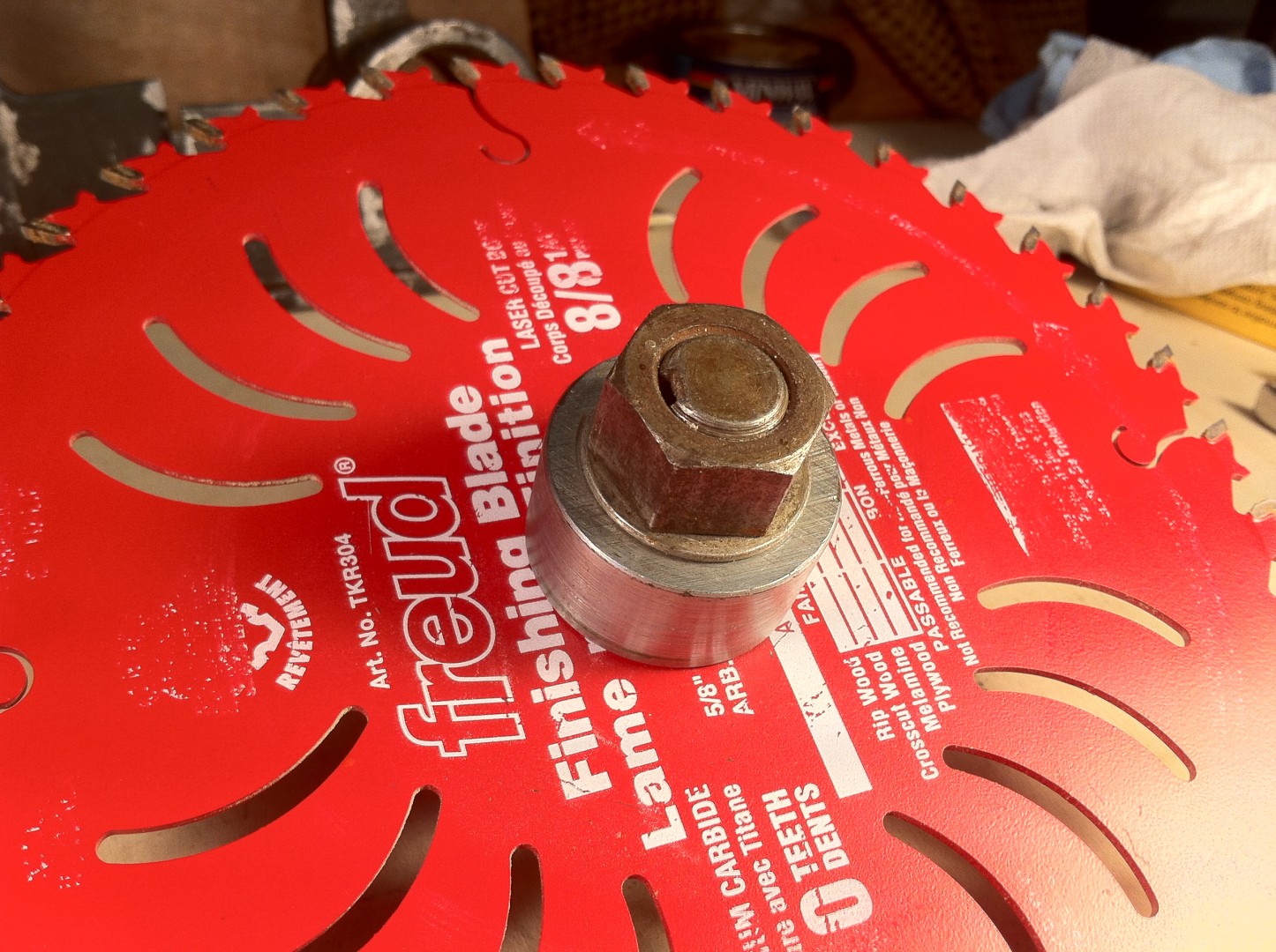

This is the arbor that came with my 10ER, it is what I use with my saw blade.
Total length 3 1/8, shaft length 1 5/8, keyed shaft and washer.
and with the blade mounted.

Interesting! The 1953 accessory catalog lists a 3/4" spacer and TWO 3/16" spacers. The two 3/16" spacers are clearly visible in the picture of the arbor.
To quote..."The collars, one 3/4" thick and two 3/16" thick, are machined and counterbored to assure clamping fit."
Quite obviously your arbor will not accommodate a second thin spacer. This tells me there are at least two different arbors for the 10ER. So again maybe the very first ones did not have a key way.

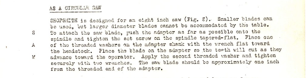

It would seem they changed the design a few times. I was just looking at the 10e preliminary manual and it describes the saw arbor as having two threaded washers.
The '52 catalog description is the same as in '53 that you quoted
The '54 catalog only shows arbors in the Mk5 section but under saw blades in the 10er section it says to use the 5/8 arbor , this is the first one that mentions the keyed washer, but the picture is the same as previous years.
Something to take into account is that they did not have separate saw and accessory arbors, so for saw blades you would use the 3/4 washer and one 3/16 washer, and for thicker accessories (wire/ buffing/ grinding wheels etc) you would use the two 3/16 only, one suspects that the unused one would get lost over the years.

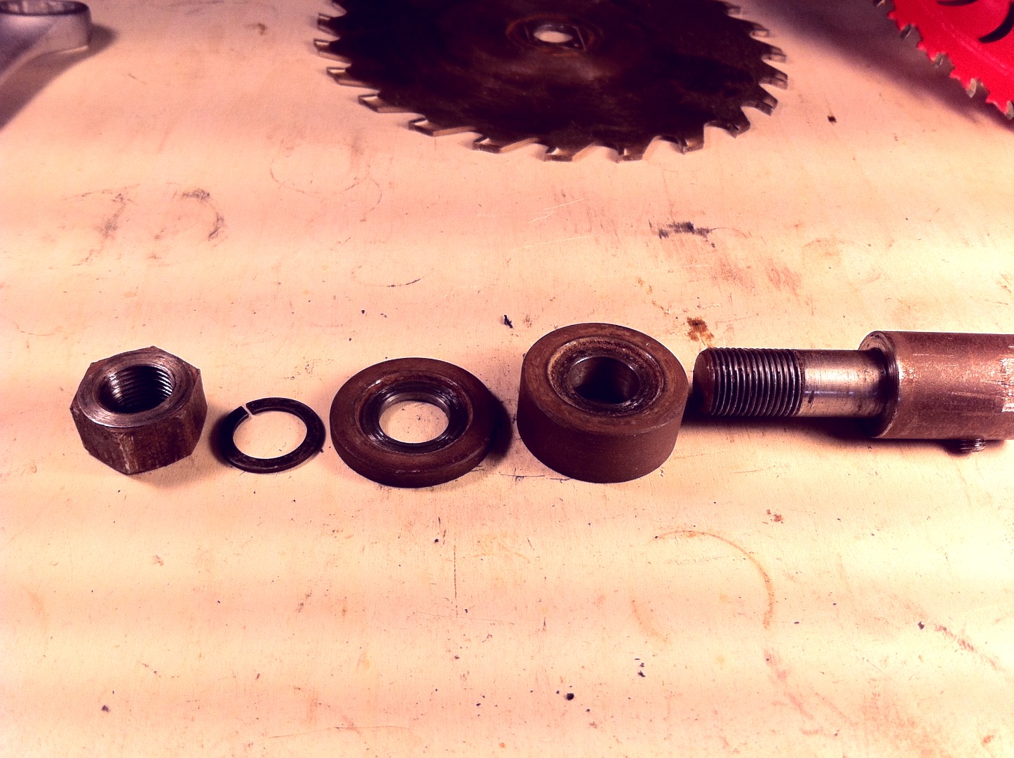

Update. Since my last post I have acquired a third 10ER.
The arbor that came with this one does not have a slot or keyed washer, and its set screw takes a smaller allen key.
A side note, on this one both washers are steel, on the one with the slot the 3/4" washer is aluminum.
Also note previous owner had the blade mounted wrong. :eek: thin washer, thick washer (recess on the wrong side), blade, lock washer (not oem), nut.
