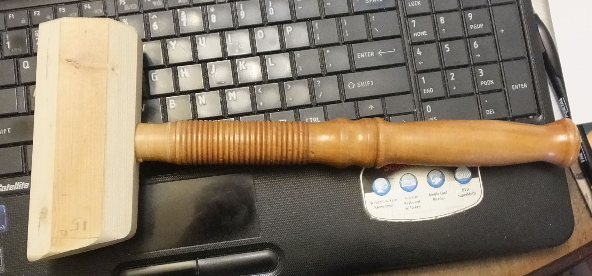

Made a correction to the original post. The angled face is 10° not 15°.
I made a prototype with a 15° face and it did not look right.
mallet a.jpg (345.98 KiB) Viewed 10637 times
Yes, same handle.

Just for reference the several mallets I have are in the 5 to 7 degree range. While 10 might work I know my favorite is the one that is 7 degrees over the 5 degree one for a lot of tasks. If you are using it for say chisels then the even shorter 5 degrees seems better to me but the 7 degrees for persuading things....

reible wrote:Just for reference the several mallets I have are in the 5 to 7 degree range. While 10 might work I know my favorite is the one that is 7 degrees over the 5 degree one for a lot of tasks. If you are using it for say chisels then the even shorter 5 degrees seems better to me but the 7 degrees for persuading things....
Thank You for that insight. I considered the motion from both a elbow swing and a wrist swing. Also the angle spanned by wrist motion.(the source of 15°)
I think realistically a shorter range when 'tapping'.
One thing about it, I can take off the excess, but not the reverse.
