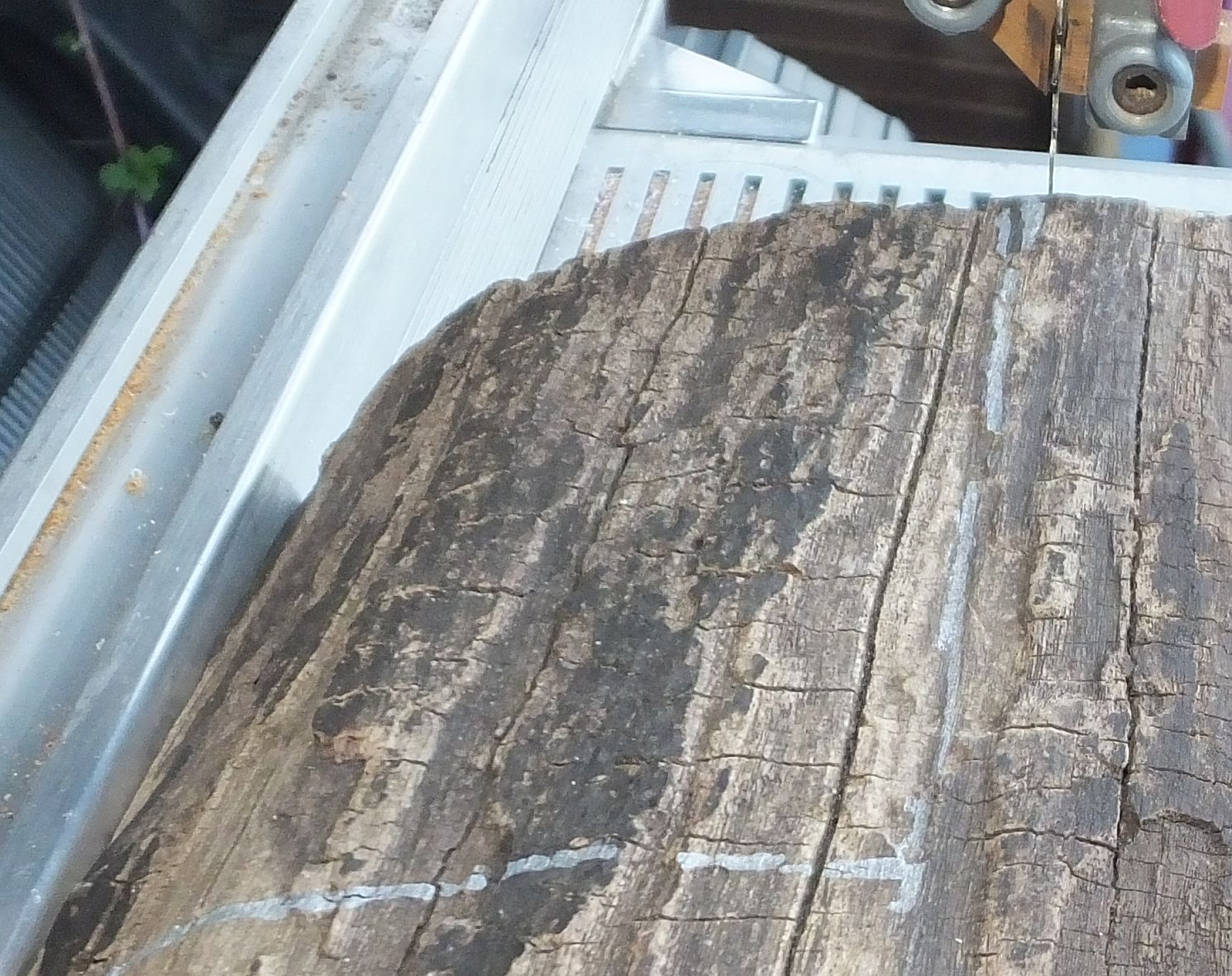

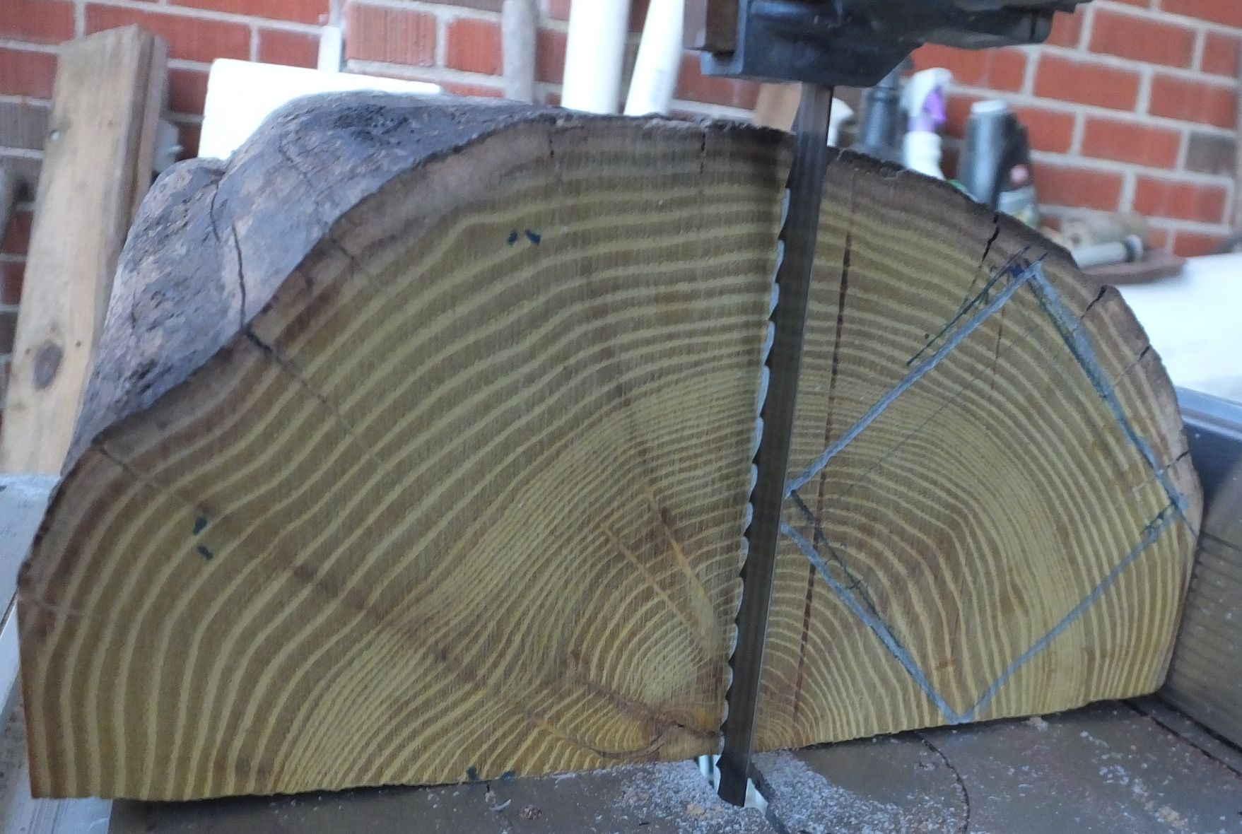

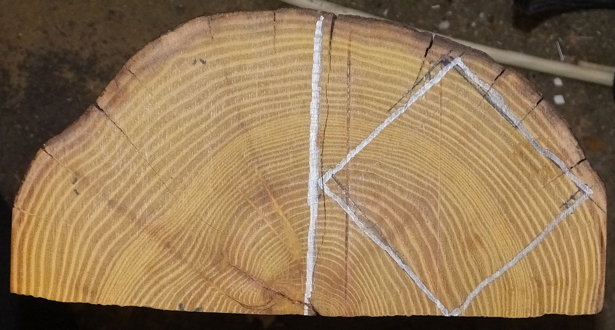

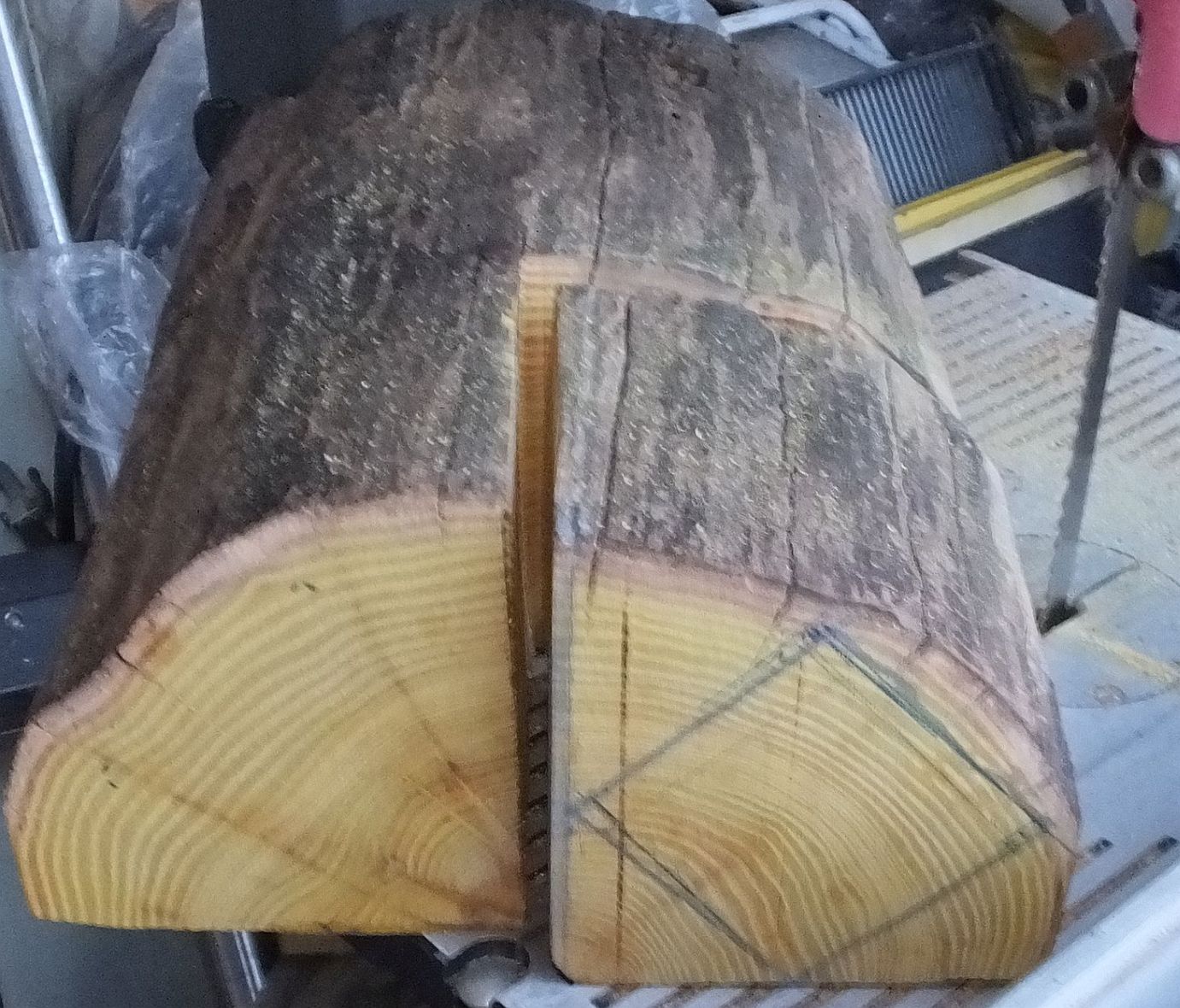

The head needed to be tangential grain across the face of the head. Radial grain then goes from top to bottom of the face. That leaves what was vertical growth in the tree running from front face to the rear face.
After much futzing with the chunk of firewood, the jury decided upon a chunk taken out as marked.
select location.jpg (536.99 KiB) Viewed 9853 times

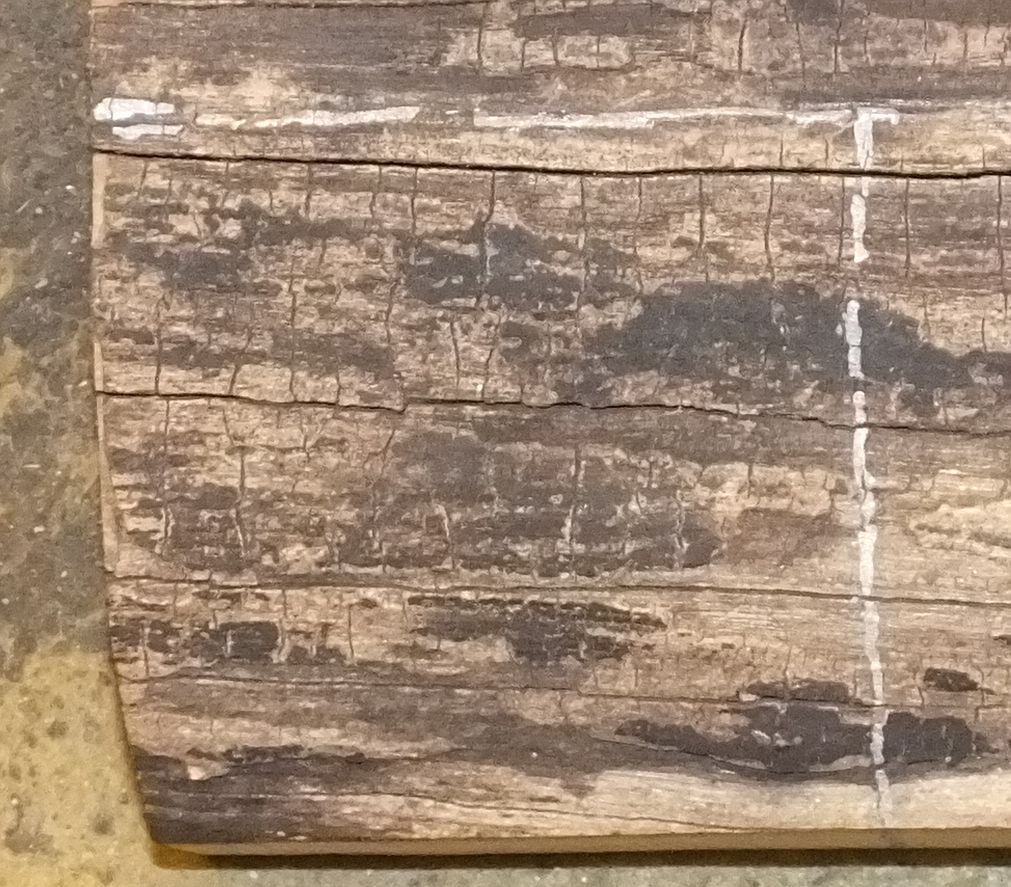

The face has some checking, but I think CA glue will take care of any future problems with it(a compromise due to size of the firewood.
So a second view of the selected area to be harvested.
location 2.jpg (254.57 KiB) Viewed 9853 times

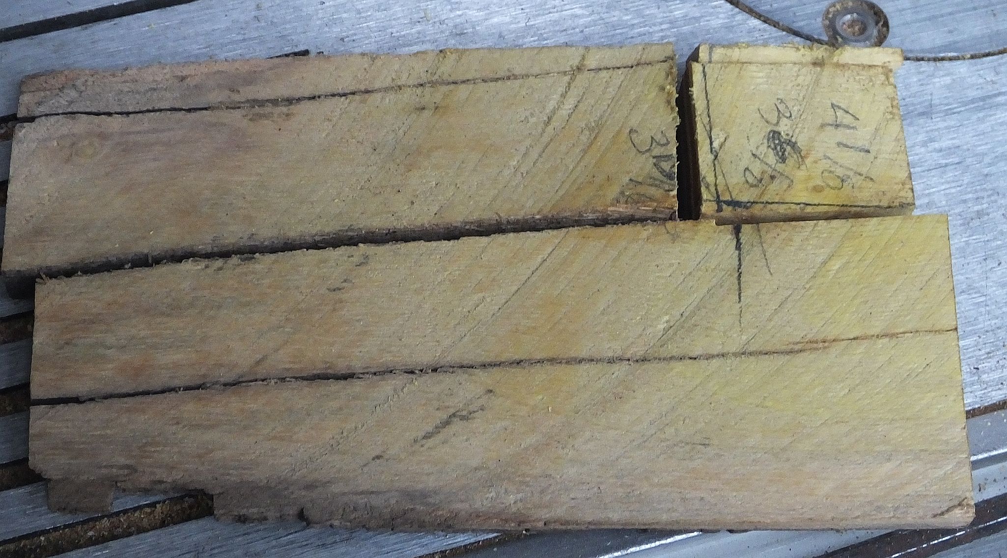

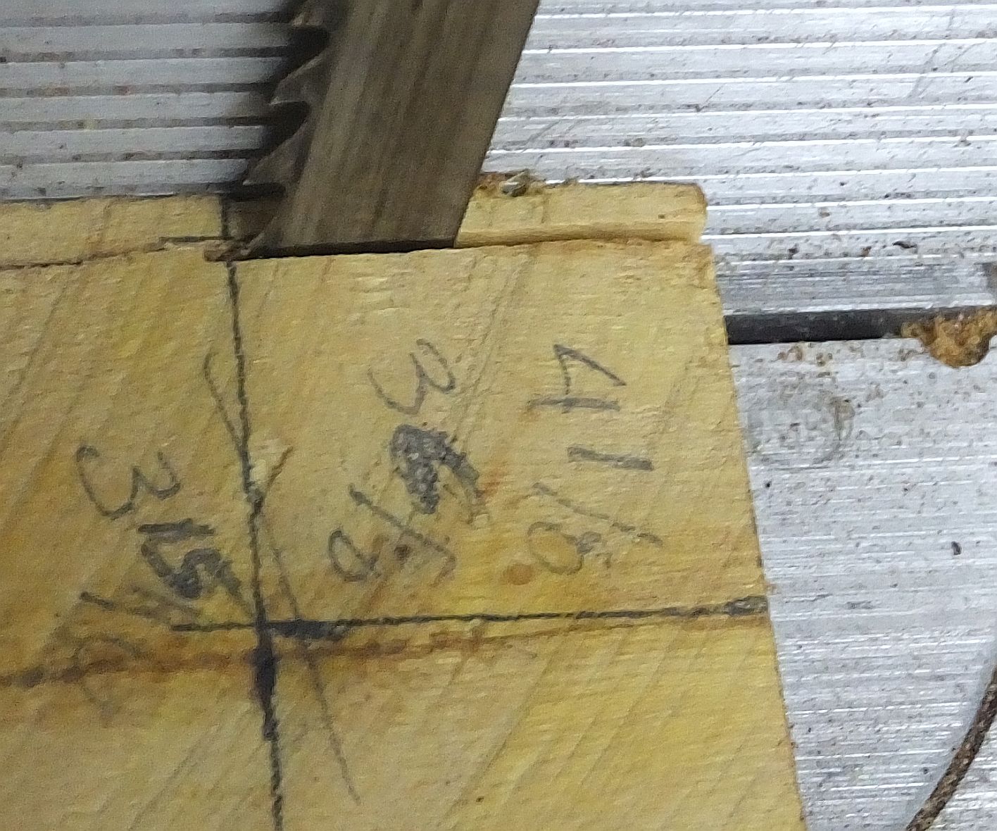

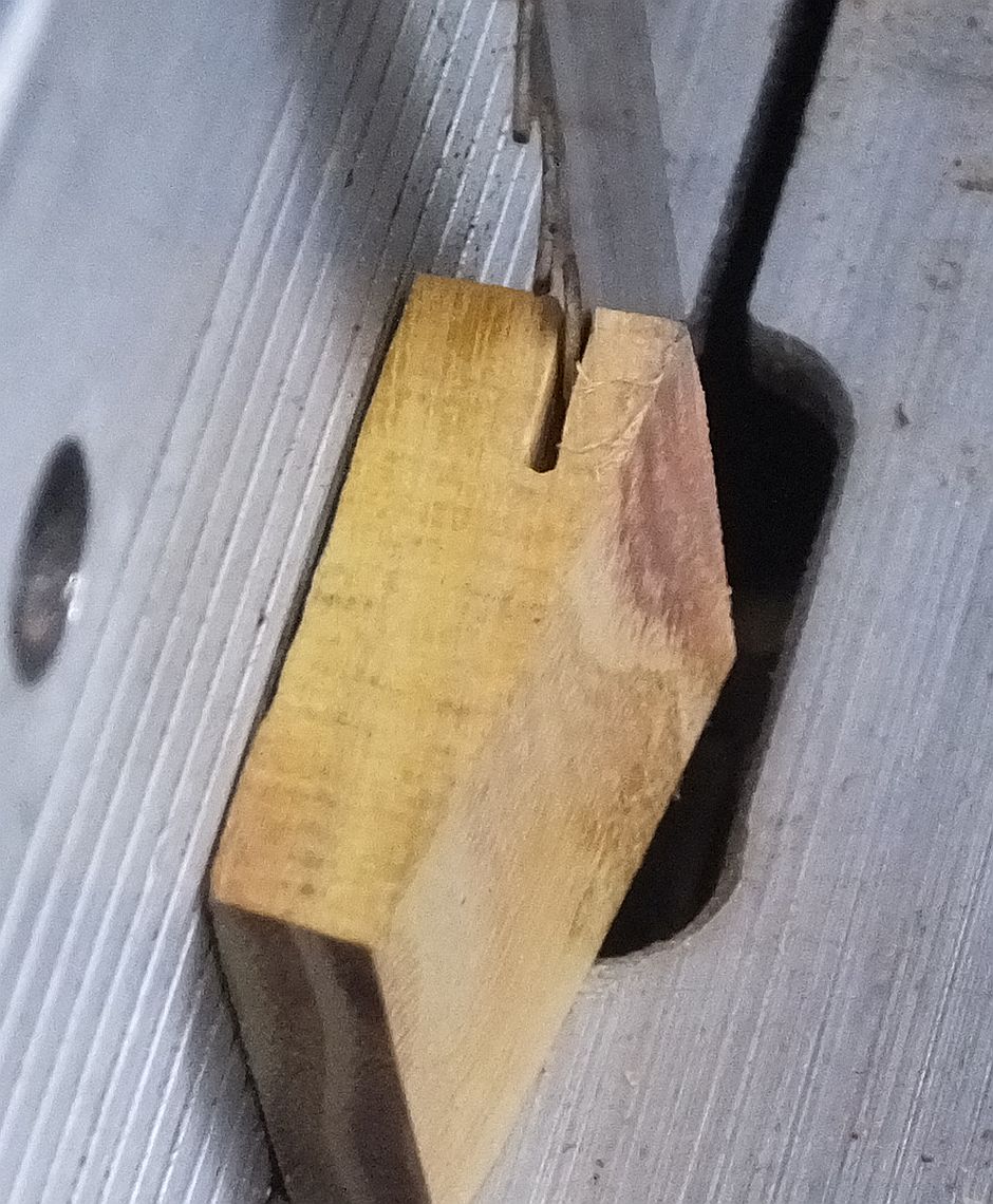

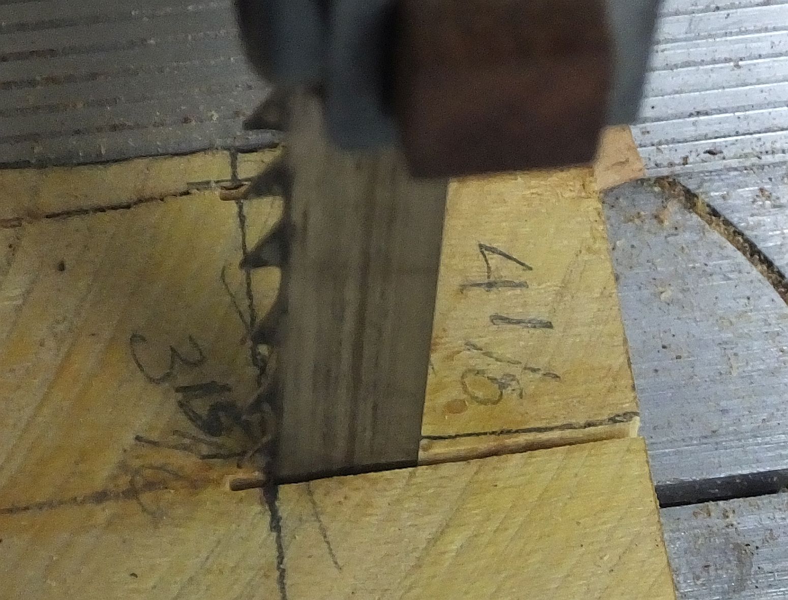

Cutting it out:
first cut.jpg (349.1 KiB) Viewed 9853 times
second cut.jpg (399.24 KiB) Viewed 9853 times
third cut.jpg (349.96 KiB) Viewed 9853 times

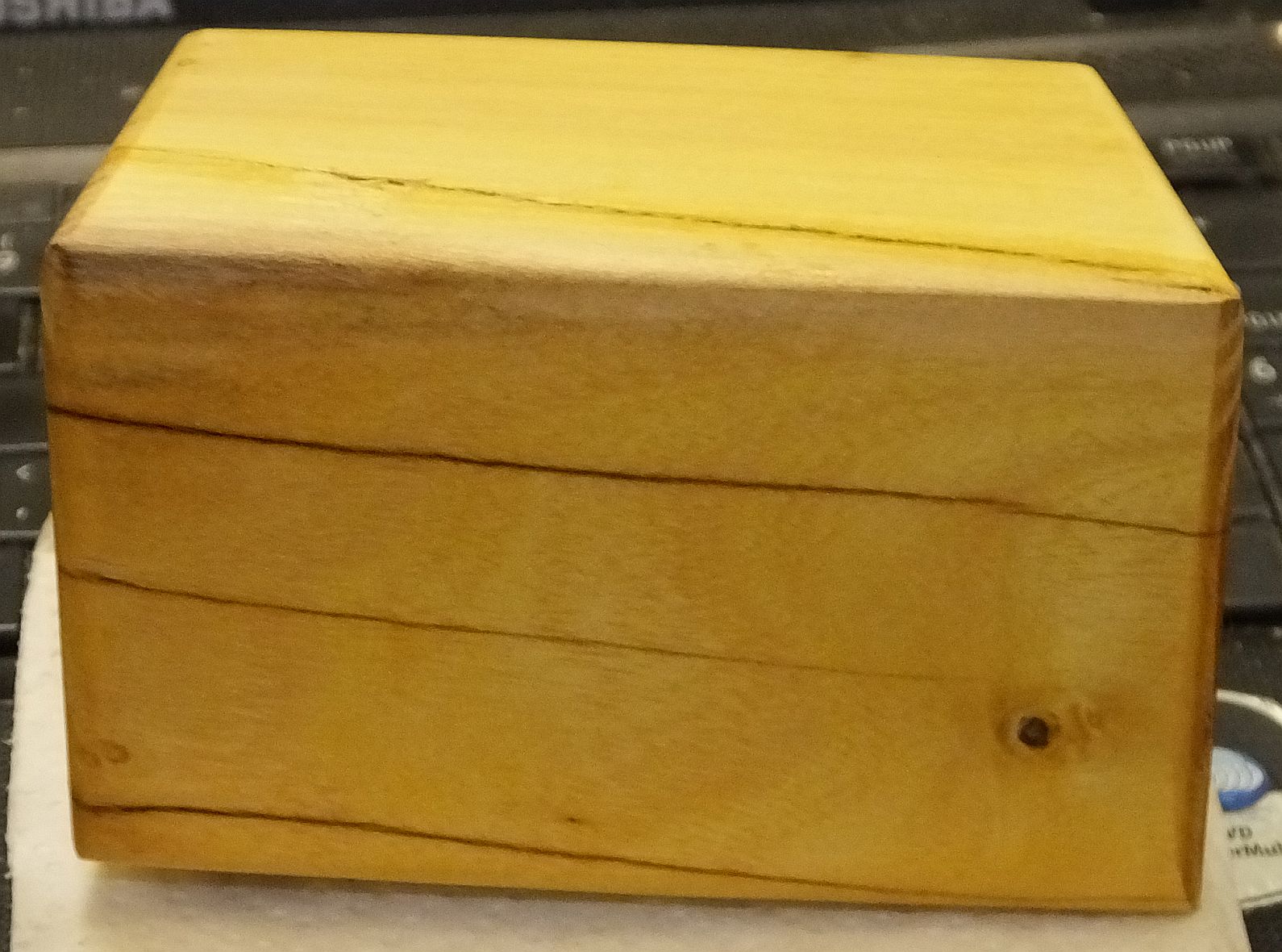

Then the blank was cut to size
The blank about 2 1/2 x 2 1/2 x 3 1/4. One face 90° and the other face 80°(10°).<<<<<< originally posted 15° which was the prototype angle which looked to severe.
blank 2.jpg (324.35 KiB) Viewed 9853 times

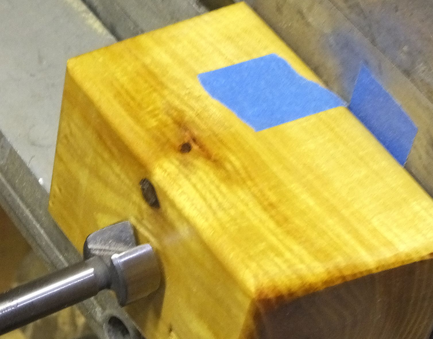

The hole for the handle was located at the center of gravity between the front and rear face.
The drill press stop was set to drill a 1" deep hole.
hole setup.jpg (376.61 KiB) Viewed 9853 times

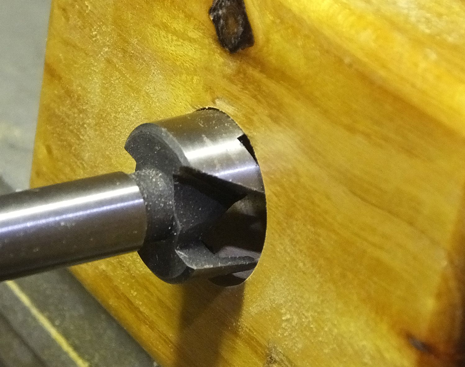

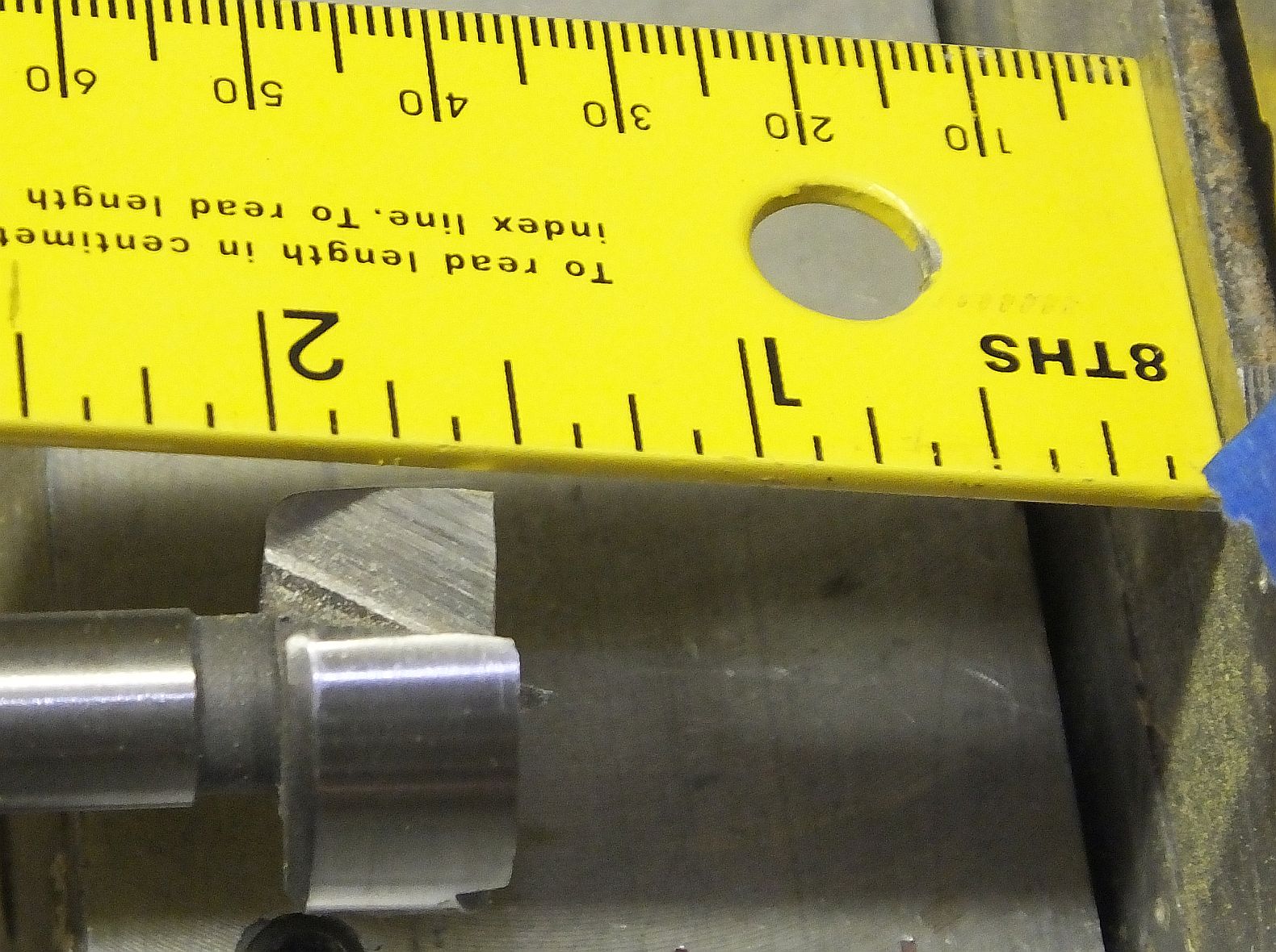

Drill 7/8" hole 1" deep.
7-8 hole.jpg (338.21 KiB) Viewed 9853 times
Then two 13/16" holes drilled at a 4° angle into each SIDE of the original 7/8" hole with the bit even with the entry edge of the 7/8" hole. After first drilled, the blank is flipped and the other SIDE drilled at a 4° angle. Since the handle hole will be blind, the tapered sides provides room for the wedge to expand the sides of the handle.
13-16 at 4 degrees.jpg (365.4 KiB) Viewed 9853 times

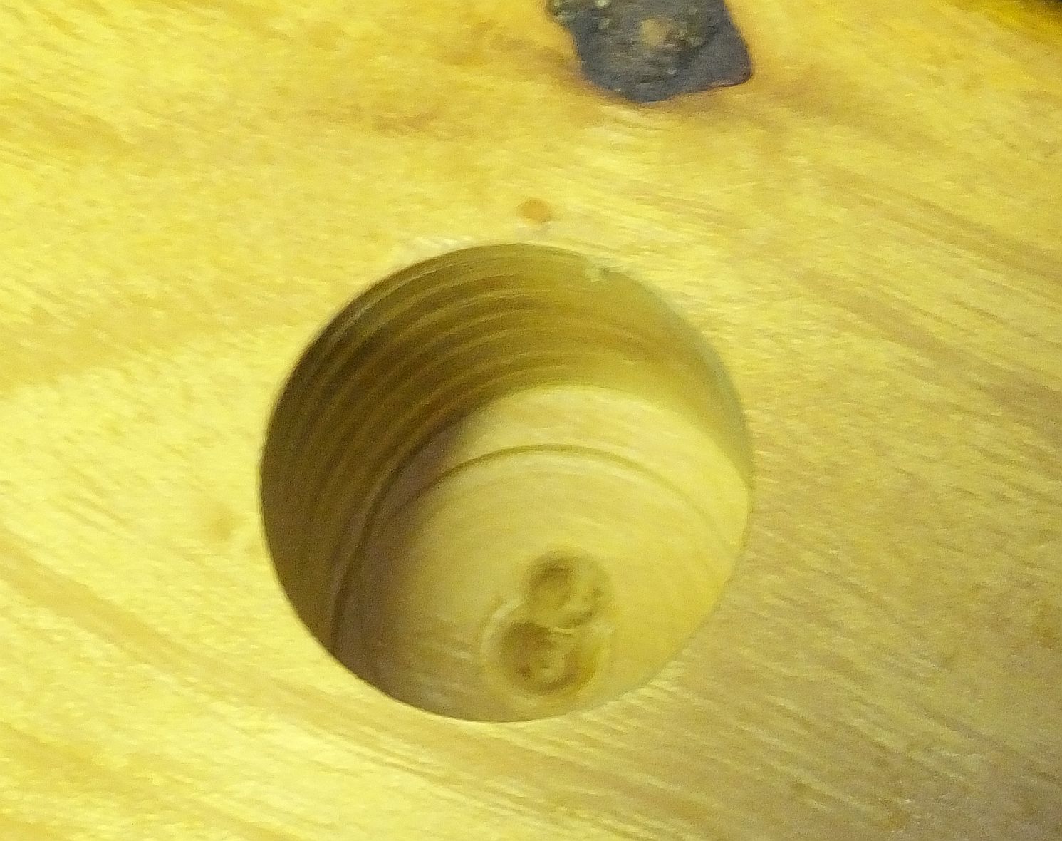

That creates a hole 7/8" front to rear and about 1" side to side.
Now about the handle. Salvaged from previous handle making stuff. Actually it was a prototype that was made from micro-wave dried piece of locust that burned internally and the charing was not discovered until being turned. Hence it became a prototype and not the final version.
Now about it's grain orientation. The cathedral grain will be on the sides of the handle. Thus the tangential grain runs vertically. The wedge slit also runs vertically. The slit is cut almost 1" deep. That creates a wider handle as the wedge is driven in. The tapered sides of the head hole supplies room for the expansion. The hole remember is blind. Correct calculations recommended here. :D
Here is the hole with the 13/16" bit pilot showing a 1/8" spacing. Thus the hole sides are splayed 1/8" wider across the bottom of the sides.(actually slightly less)

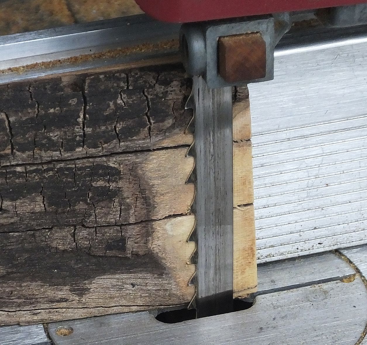

OK now we need a wedge. A cutoff that will have tangential grain from side to side was first trimmed to create parallel front/back. It only needs to be 1" long.
flat side.jpg (420.04 KiB) Viewed 9839 times
Fortunately the checks are slightly further than 7/8" apart so cutting the first side.
side 1.jpg (365.94 KiB) Viewed 9839 times
Then the second side.
side 2.jpg (371.4 KiB) Viewed 9839 times

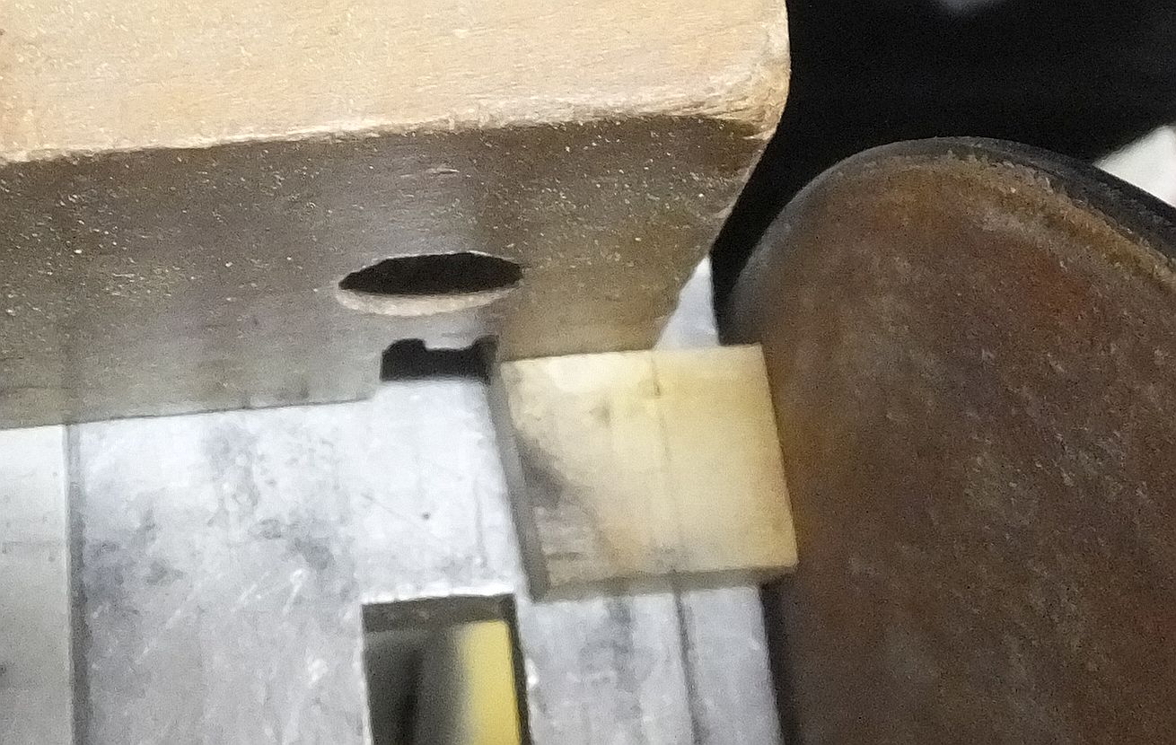

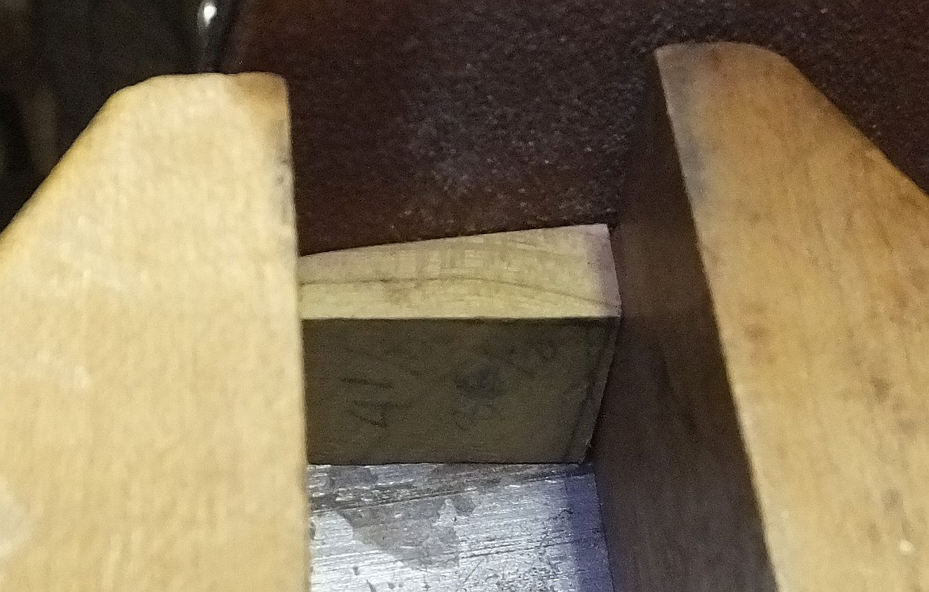

First square the end.
square end.jpg (260.95 KiB) Viewed 9839 times
Next sand to wedge shape(about 1/8" over 1" taper.)(7°)
sand taper.jpg (243.76 KiB) Viewed 9839 times

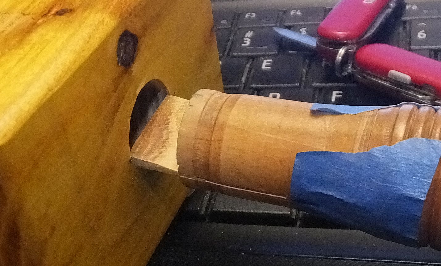

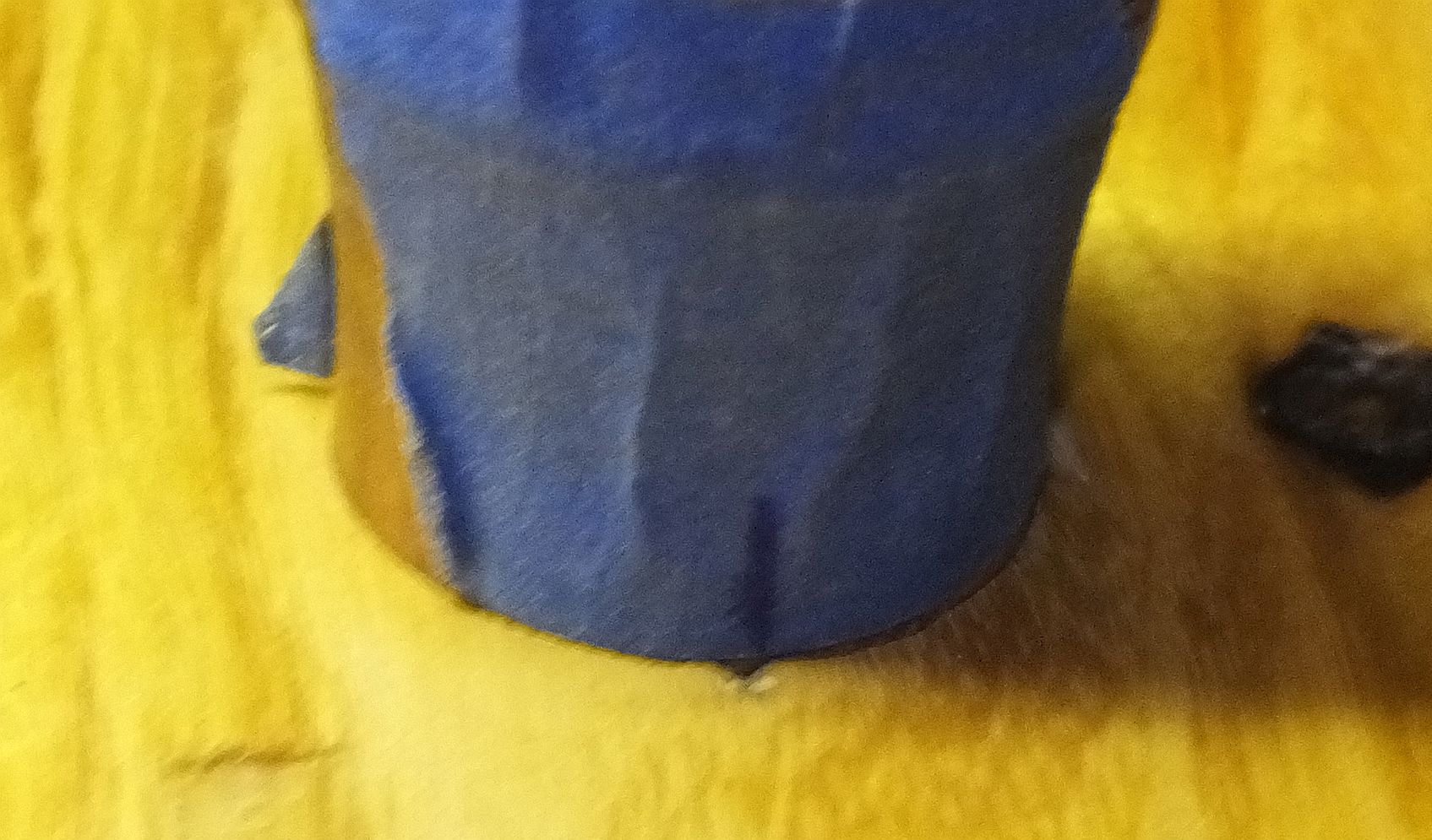

Now for the moment of truth! Will the handle be secure when it is driven into the hole and the wedge expands the handle sides as the wedge bottoms out in the hole.
pre moment of truth.jpg (289.29 KiB) Viewed 9839 times
The tape is where the handle should stop.
handle in.jpg (332.77 KiB) Viewed 9839 times
It seems quite tight. No rotation and no end play.

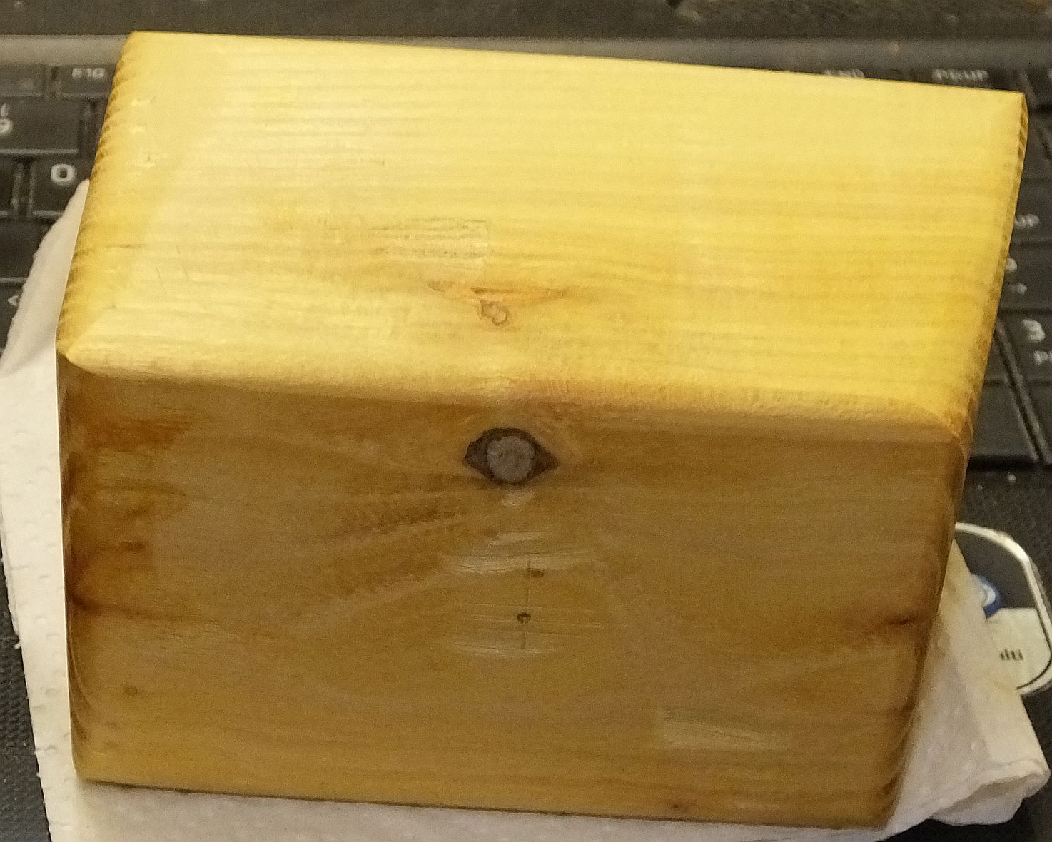

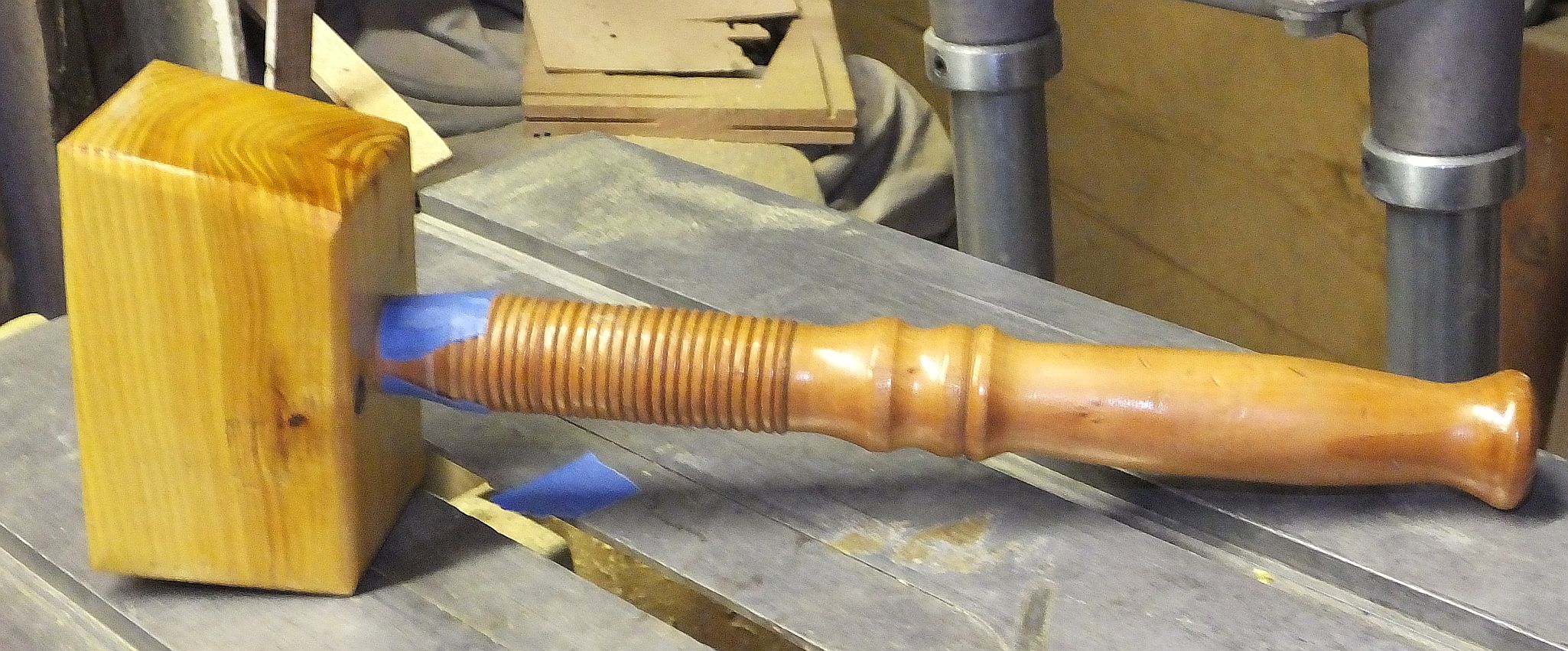

Show n tell time.
First the show.
Over all length is about 12 1/2".
Total weight is about a pound(the head weighs 14 oz).
The handle has a thumb groove just above the hand part.
The series of beads creates a second hand area for short handle tapping.
It may prove to be too heavy, but cutting the corners off will lighten it.
The CA seems to be taking care of the checks(and provided a finish as well).
The osage orange seems to be tear out prone when planing(on the jointer).
It drills much easier than I anticipated(forstner bits).
I think I am going to enjoy using it.
