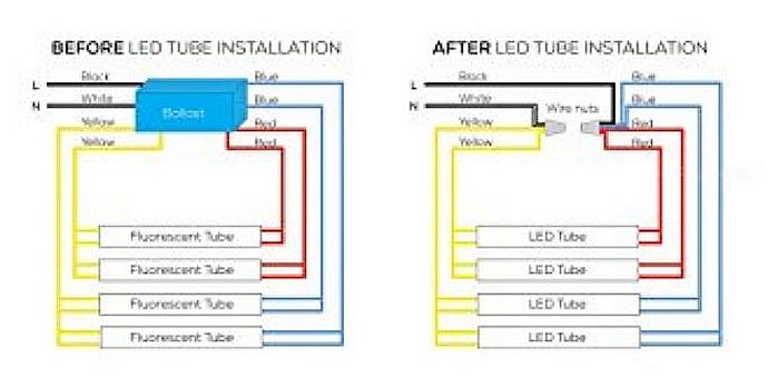

I though all you had to do was wire two leads ( one white and one black) from each tube tombstone to 120 bypassing the ballast?
Your fixtures have a built in ballast but the fixtures I have have power into a ballast box and then four leads out 2 to each tube.
Do they come with a schematic? What does it look like?
Re: electonic incense of the bad kind

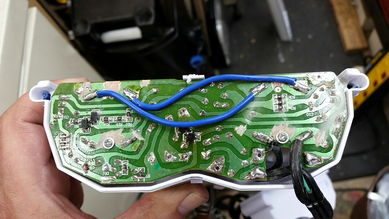

If you have a fixture with a ballast and wires coming out of that then it is a lot easier then what I have to do. Look at my earlier pictures, there is electrics at both ends and integrated end caps. I have to cut traces, add wires, and rewire to get things to work. I also have a switch in mine that I'm keeping and then there is a safety ground tap that has to be dealt with. I'm trying to use the same wire that runs the far end and that is too short so I have to add in some jumpers..... anyway for me and my fixtures this is rather a pain to have to deal with.Ed in Tampa wrote:I though all you had to do was wire two leads ( one white and one black) from each tube tombstone to 120 bypassing the ballast?
I'll get you a scan of the paper work later.
- LED REWIRING.jpg (33.21 KiB) Viewed 8735 times
His switch should wire into the black or load .

Four more tubes arrived today, wired and installed. Timed myself and it still takes me just under 45 minutes per for the changes.

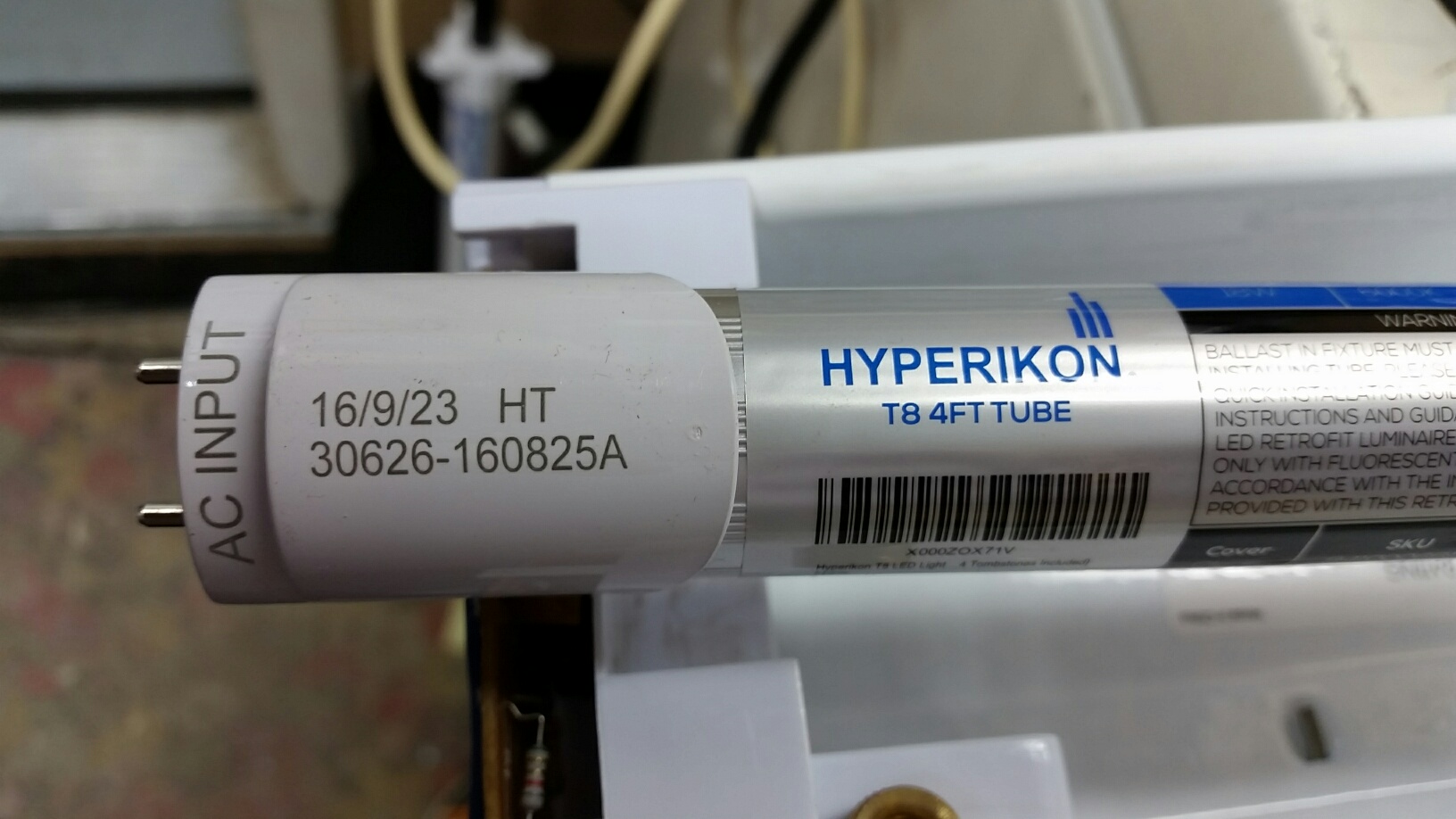

New month and new LED bulbs arrived today. I went with a different style bulb this time, one that is powered on only one end. Since the fixtures I have are very different and not as simple to redo as I would like I figured I'd try these.
I still have to cut traces but on only one end. I still have to rewire but only on one end. These bulbs make it much faster. The only issue I have is now I will have to have two different spare bulb types. I guess I can live with that.

After reinstalling the fixtures it is very clear that I can and will get by with two less fixtures then I had to start with. So the added efficiency and reduction of the two fixtures is a pretty decent power reduction.

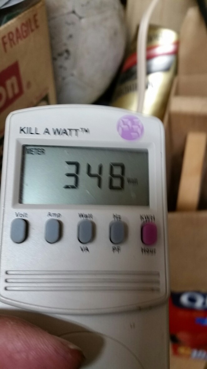

A month ahead of scheduled, I have finished my last sets of bulb replacement and fixture reworking. I went ahead and did the full boat of them but will be turning off two of them for normal times and have those two for times when it might be nice to have the additional light. With all the lights on the shop now uses 348 watts.
Here is a picture to show it happened...........
