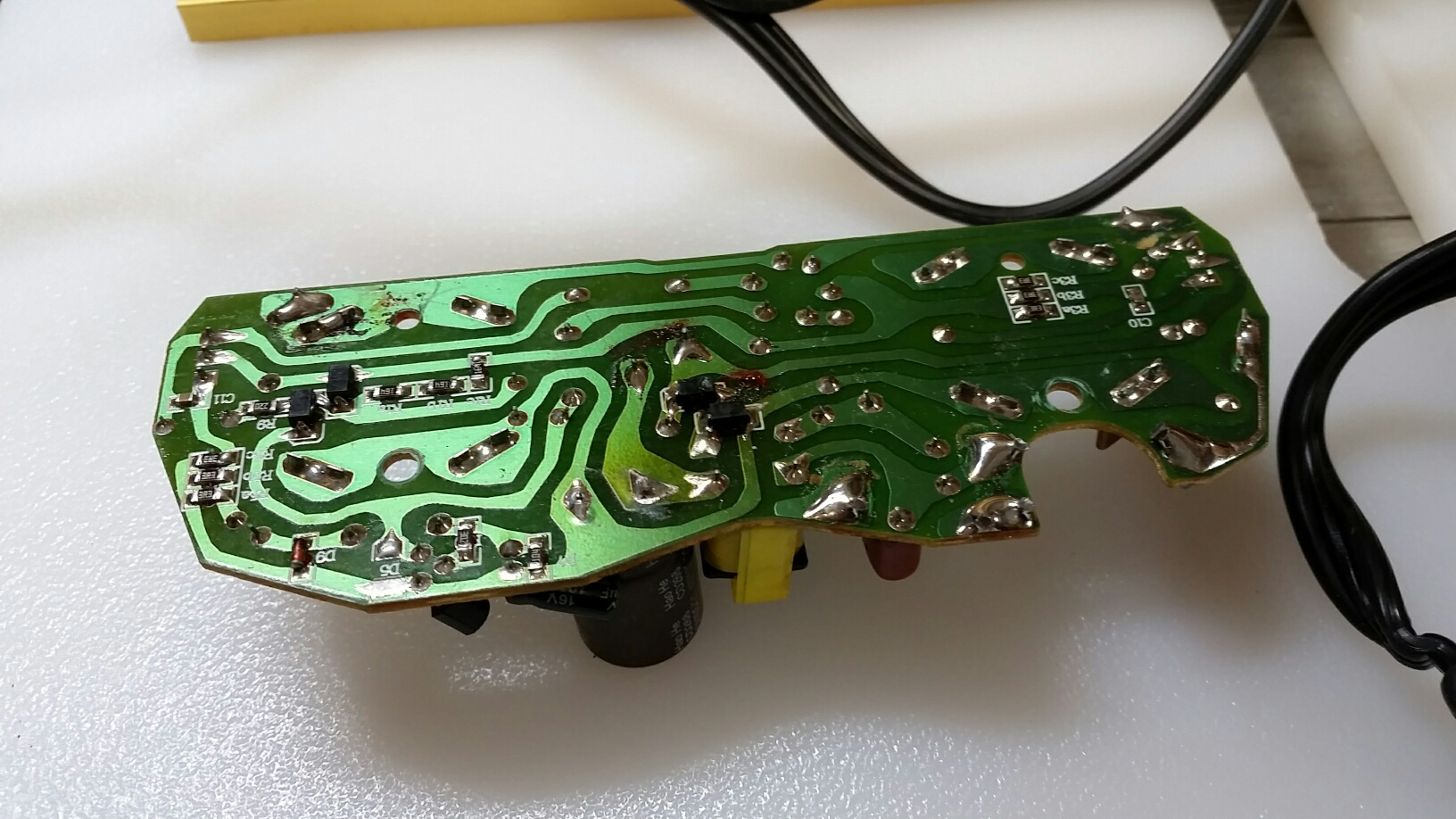

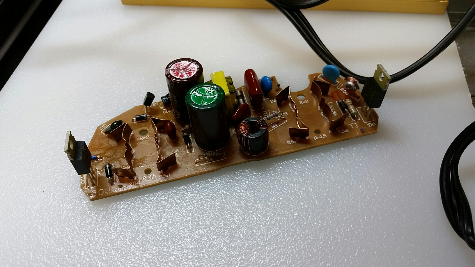

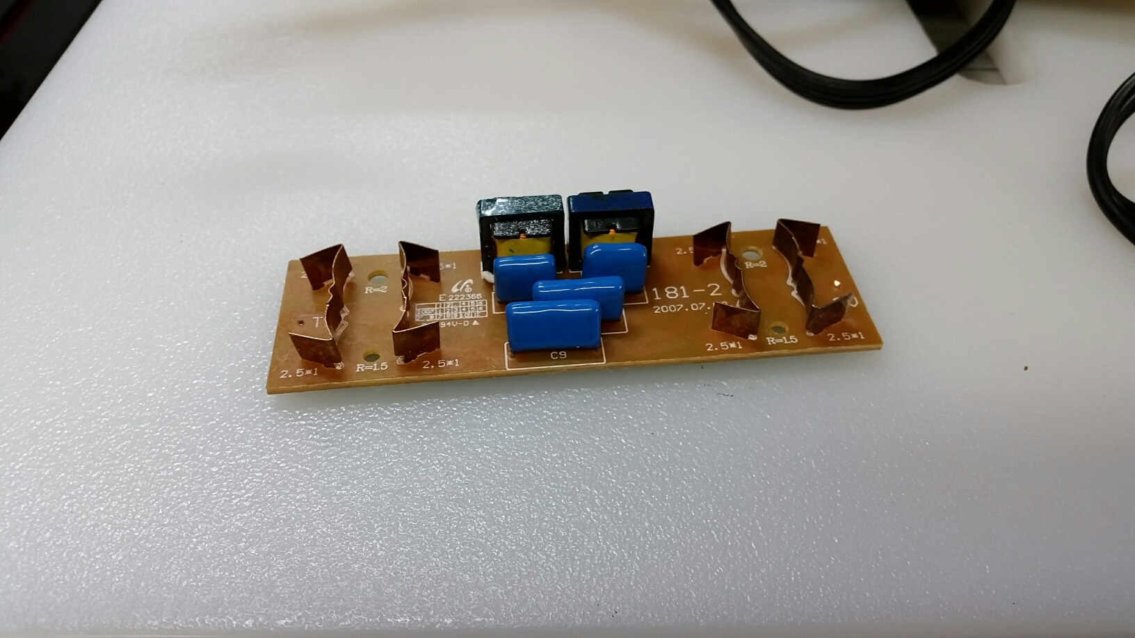

So, want to see what was inside? I did.

Ed, which component on the first
board looks like it released the
Magic Smoke? I'm thinking the
red-brown disc cap, next to the
(yellow colored) transformer.
There are the 2 can looking
electrolytic caps, the xformer,
and that disc cap in the area.
steve
10 ER, stripped down.

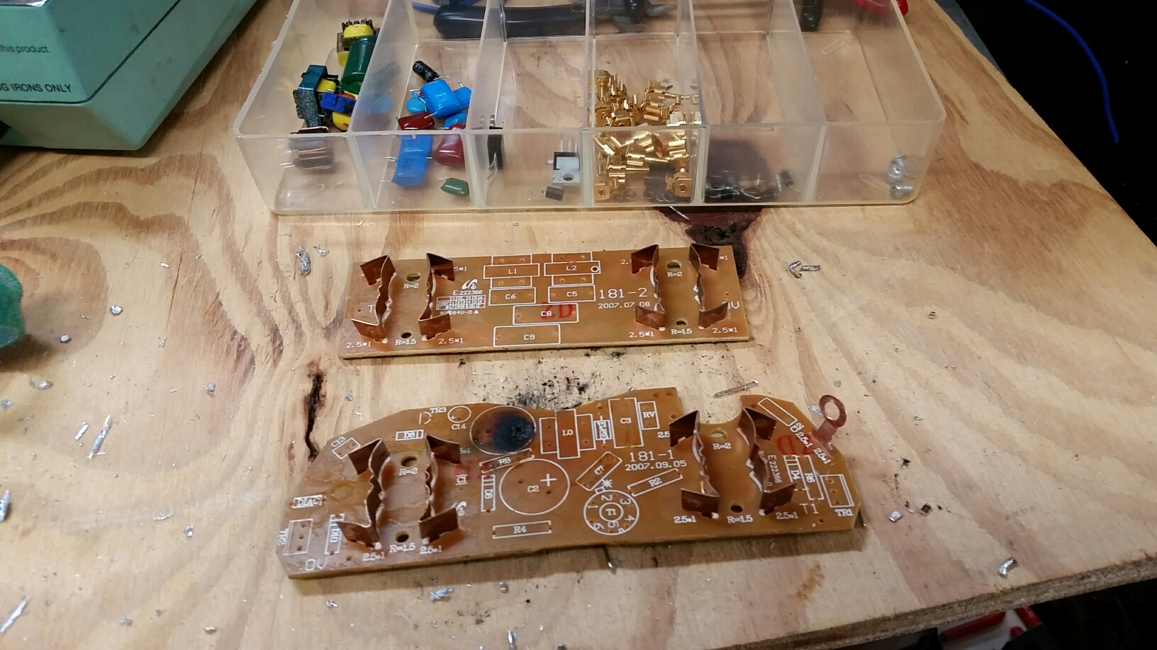

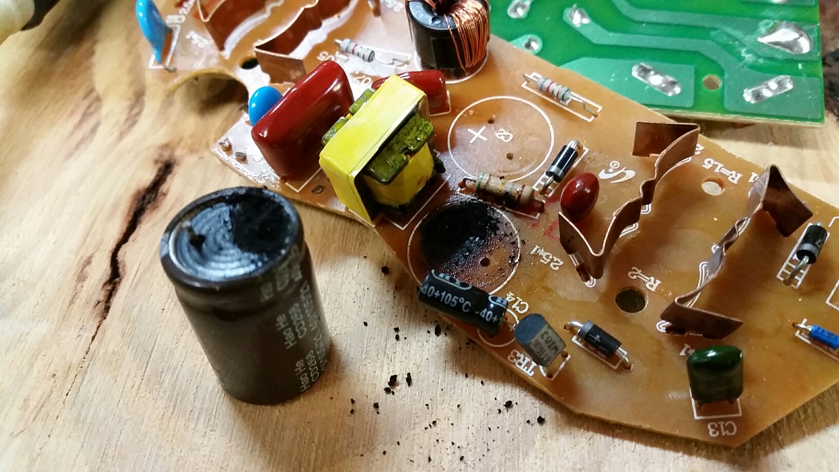

I don't see any components that look damaged but the heat was concentrated in the area of the cap and x-former. I may solder suck a few parts just out of general interest but I'm not planning on attempting a repair.

Ah such a sheltered life. Parts do fail and it is not uncommon for caps to go as the fit rate on them can be a lot greater then other components. This is especially true of electrolytic types.

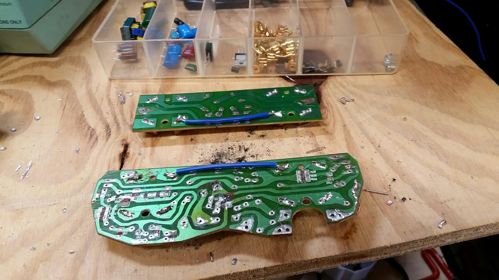

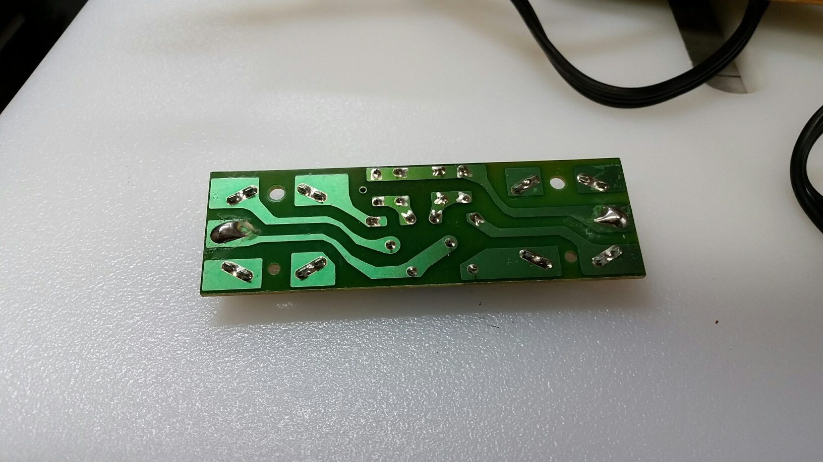

Anyway I did pull the components and as you can see there was a bit of heat up when it happened. The lead on the capacitor is just gone........ board scorched.
I was having so much fun I pulled all the parts on both boards after this. I then wired up the sockets for the LEDs. Next time I'll just cut traces to isolate the sockets but I will only do a couple of them for testing purposes. I have 4 bulbs arriving tomorrow so this will be test 1.

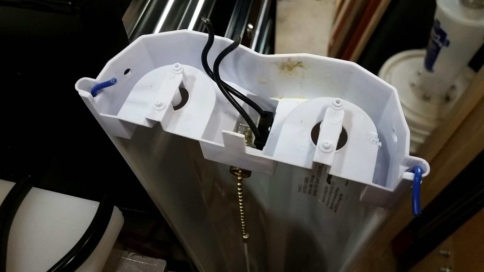

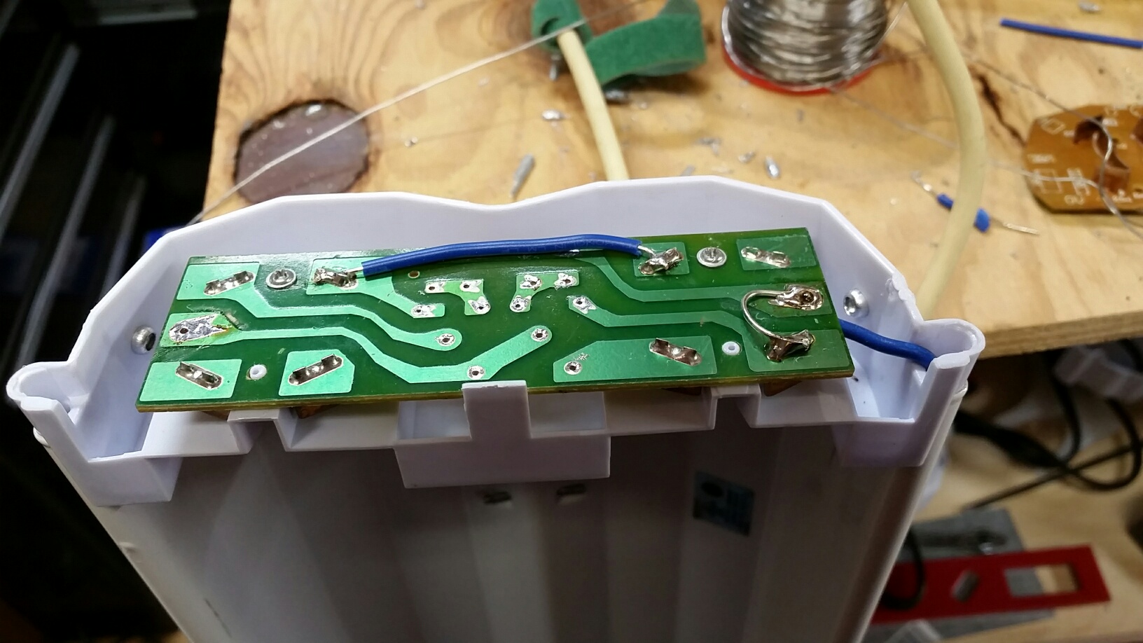

Here are just a couple of shots of the wiring.
The bulbs are shunted internally pin to pin or so I read. If not I'll have to add another wire.....
I didn't take any other pictures and unless you have the same lamp as I do I'm not sure if more pictures would be of any help.
Re: electonic incense of the bad kind
Bulbs arrived but they were not shunted so a few tweaks to my wiring. Not a big deal and now I know for next time.
