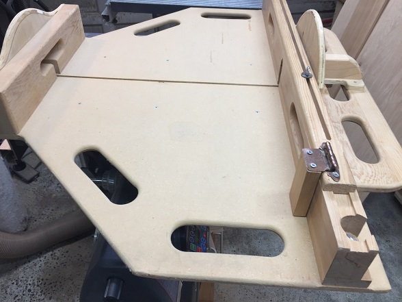

Another size opinion: 24" deep and 36" wide. Reasoning: depth is a standard 24" MDF board; width is a quarter inch less than my bandsaw table. That allows leaning against the bandsaw without sticking above and interfering with using it. So the width should be slightly lower than where ever you might temporarily stand it between cuts. Mine is a variation of John McCormack's 'ultimate sled' in Fine Woodworking. A couple of his great ideas are cutting far corners to reduce weight and adding many hand-holds. Those holds further reduce weight and really help moving it into position. I put hand-holds in the rear-brace and fence, but they are never used and I wouldn't bother with those next time. I fastened a brace across the back with more hand-holds that are nice when pushing through a cut (although the hand-hold directly behind the blade was a really bad idea, but the piece is glued and I can't replace it). A sliding strip on top of the fence can extend my simple stop with spring hinge 32" from the blade.
This sled is 19" between fence and brace, which is adequate for 99% of crosscuts. After viewing other posts, I am thinking about a simpler sled with 25" clear depth for occasional work with 24" panels. But this sled will always be my workhorse.
