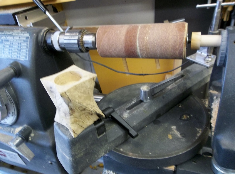

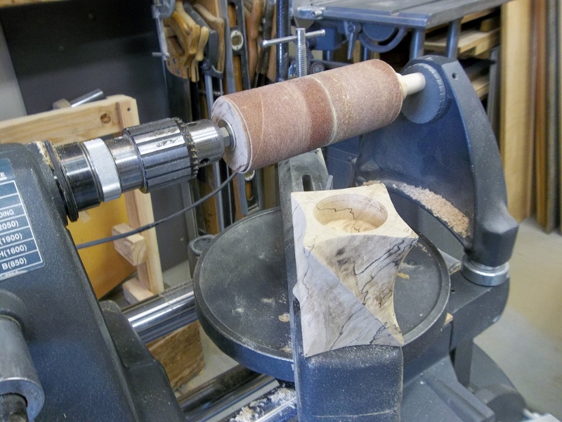

This is how I addressed Side Load concerns.
100_0079 (800x600).jpg (369.8 KiB) Viewed 7541 times
100_0078 (800x593).jpg (340.72 KiB) Viewed 7541 times
Glenn
