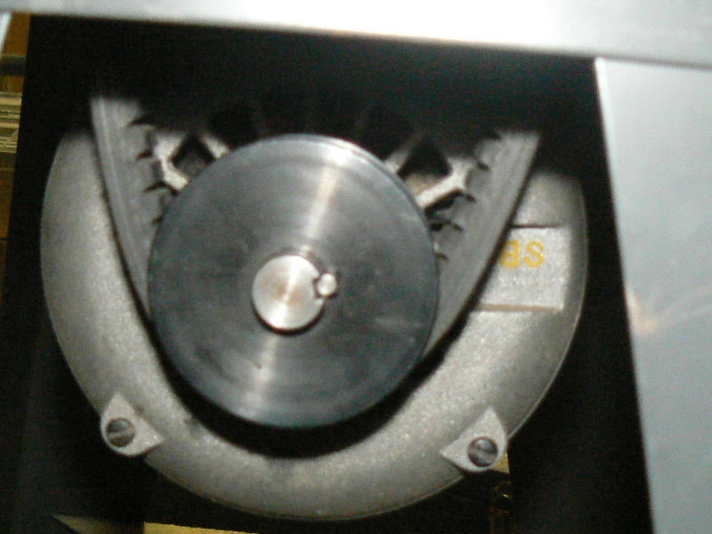

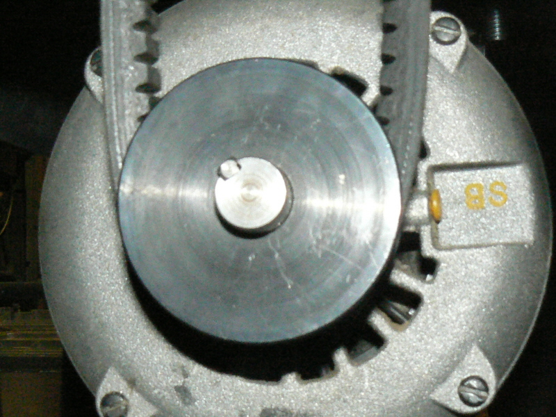

Power Station motor pulley belt tension
The two pix below show the belt on motor pulley in hi speed and lo speed position.
http://www.shopsmith.net/forums/attachm ... 1231722773
Power Station motor pulley/belt at HIGH speed
Power station motor pulley at LOW speed
Dusty: I am wondering what your motor/inner belts look like at high and low speed position. Mine appear 'tighter' at HIGH SPEED. If I had adjusted tension at 'LOW" speed as you suggested, it looks like it would be even 'tighter at high speeds.
BTW HOW did you embed your pix without this link nonsense????
You ARE correct that the tension varies depending on speed control setting and the tension varies oppositely on the other belt.
Like you I am struggling to find a proper way to adjust motor belt tension.
My belt adjust shown above was determined by the limit of belt entry into the inner sheave. Any tighter and it would ride on the flange ridge near the center. This was done at HIGH speed setting.
In the low speed picture the belt appears (and feels) Looser!
From this I think that setting the tension tight at LOW speed will cause tighter tension at HIGH speed.
Which is 'better'(adjust at high or low speed)?:confused:

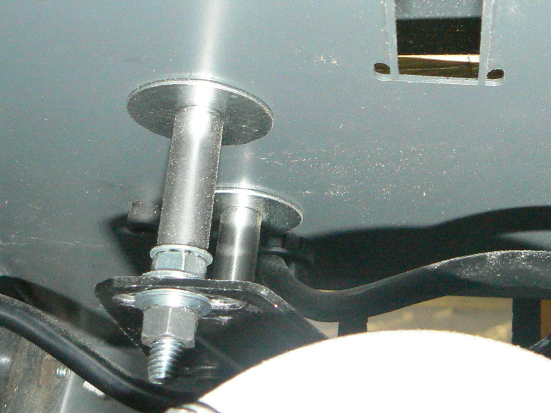

******RELATED QUESTION********
Since I purchased my PS used and in dubiously assembled condition, I had to improvise motor mounting. Pix below shows my attempt.
http://www.shopsmith.net/forums/attachm ... 1231724039
The hardware from the top is 5/16 bolt / internal tooth star washer above the 'top' and fender washer /1 1/2" spacer / internal tooth star washer / nut / flat washer / motor mounr / flat washer / split lock washer / nut.
This places the center on the motor shaft about 5 1/2" below top. I am curious if your 'stock SS' mount places motor any where near that after adjusting tension?
BTW HOW do you get your pix embedded in post without this link nonsense????
jpg40504 wrote: BTW HOW do you get your pix embedded in post without this link nonsense????
After you have uploaded your images, rather that hitting "Submit Reply" go back to the "Paper Clip" and select it. The rest will follow naturally.
I have embedded my answers in the quoted text below.
jpg40504 wrote:.......
It certainly would have been]
Check my next post.
This would be consistent with the mechanics of this concept.
That was my reasoning when I did it at Low Speed. There is something wrong with our logic here.
Does your motor pulley align with the inside or the outside sheave pulley?
http://www.shopsmith.net/forums/attachment.htm?attachmentid=3070&stc=1&d=1231724039
The four bolts on mine are first secured to the stand with four lock washers and nuts. I can drop the motor and the bolts do not move. Then I have four nuts> followed by four flat washers>followed by the motor>followed by four lock washers>followed by four nuts.
Edited to delete four nuts.

Thank You for Your Reply!
First to answer your question. The motor pulley is directly below the INNER sheave pulley. The spindle pulley is 'IN' (away from end of shaft) almost as far as it will go. If positioned further 'out' the sheave pulley tends to drift out and rub the edge of the cutout in the top.
If I understand your description of 'motor mount' start at the top there are four each of the following in sequence: Bolt head>top>lock washer>nut>empty threads>nut>flat washer>nut>motor>lockwasher>nut. This seems strange to put flat washers between two nuts?????:confused:
BTW I did finally replace the 'rack and shaft assembly' and the guides. Though still 'sloppy' it doesn't wobble any more and runs smoother.:)
jpg40504 wrote:Thank You for Your Reply!
If this is what I wrote, it is wrong. There are three nuts on each stud positioned as you have them above. The error is highlighted.
