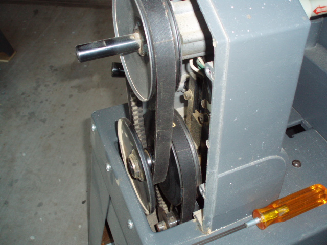

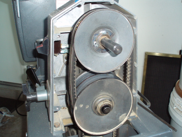

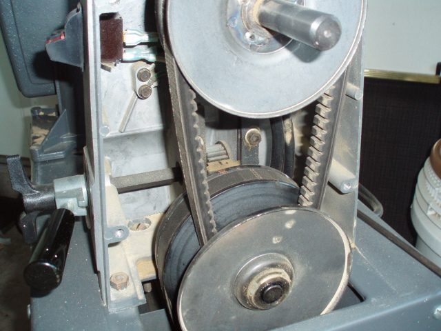

As stated, there are two belts (identical part numbers). One rides on the motor pulley and the inside sheave pulley. The other on the outside sheave pulley and the transmission drive shaft (output shaft if you will).
At low speed, the belt rides high in the inside sheave. This is the belt that also rides on the motor pulley. The tension on this belt is highest at low speed.
The tension produced by adjusting the motor position must be done at low speed. If one attempts to adjust the belt tension at any other speed it will likely become impossible to increase speed. The inside belt cannot be pulled any tighter thus limiting the movement of the sheaves.
At high speed, the belt rides low in the inside sheave and high in the outside sheave.
- Set at low speed.JPG (139.93 KiB) Viewed 20670 times
- Also Set at Low Speed.JPG (153.52 KiB) Viewed 20661 times
- Low Speed.JPG (159.71 KiB) Viewed 20666 times
- High Speed.JPG (150.15 KiB) Viewed 20663 times
