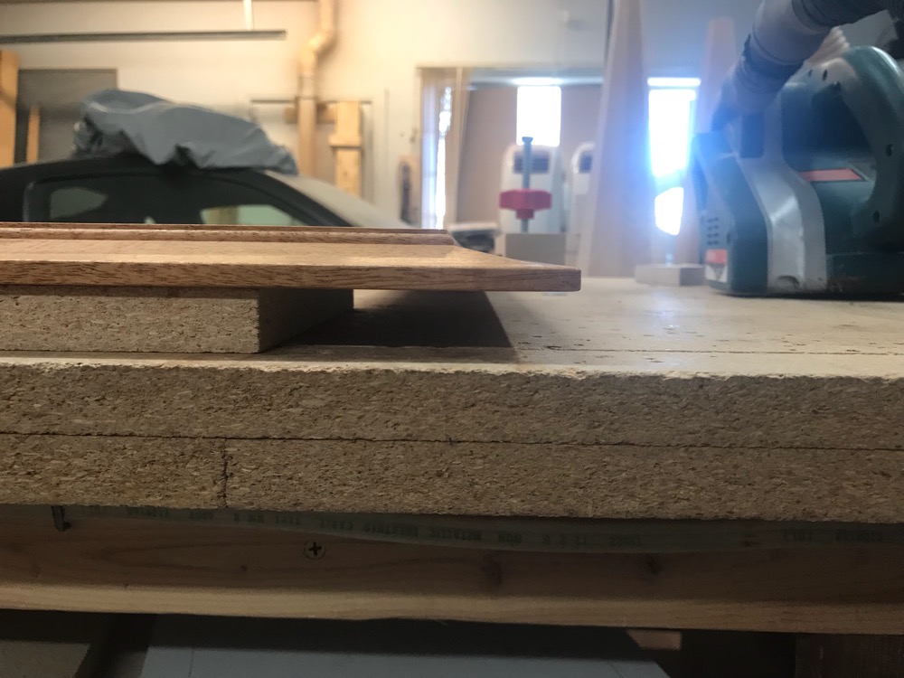

Looks great. I would really like to see the profile from the end of the stock.

That makes two of usberry wrote:Looks great. I would really like to see the profile from the end of the stock.

Here is an onside view of the profile as far as outside edge. Inside edge is a 45 degree chamfer.

I cut the miters using a miter sled on the table saw that specifically cuts 45 degree angles for frames. It is set to as close to exact as I can get it. Then I insert a biscuit in each miter and use pinch dogs for the initial set up and then flip the frame over and use either bar clamps or pipe clamps and adjust tension to get them aligned. I like to use Weldwood plastic resin glue on the large frames because it has a very long set up time and stays slippery for an hour or so which gives me time to easily manipulate them.

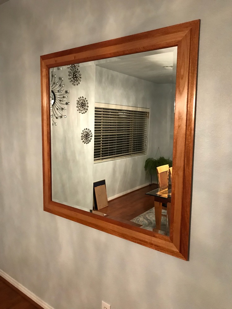

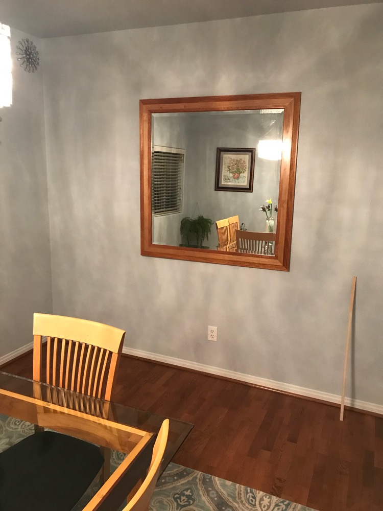

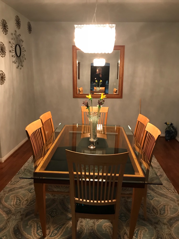

Took the frame out of the drying room, installed mirror and mounted on wall today.
Paul
Paul
- 4FE3057B-5427-41AD-BA7C-F399C5F56EEA.jpeg (166.26 KiB) Viewed 14891 times
- E8E34060-8568-440C-97CB-C643CE1D4E14.jpeg (137.42 KiB) Viewed 14891 times
- 1E814D82-E6DD-4F73-B8E6-89D0BD593404.jpeg (149.97 KiB) Viewed 14891 times
