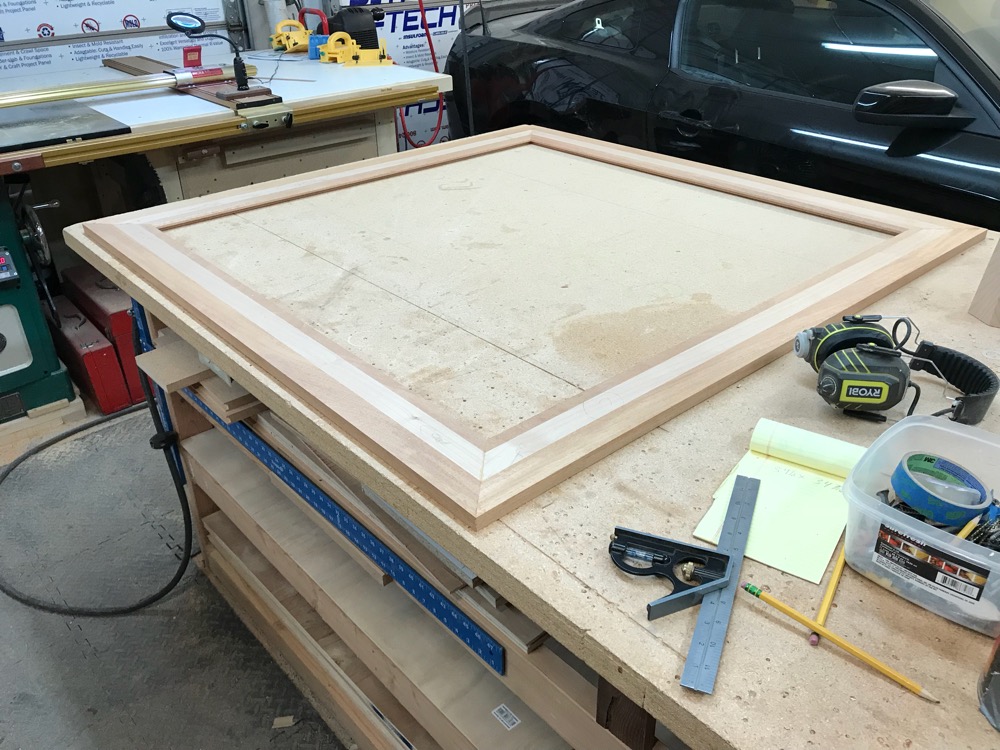

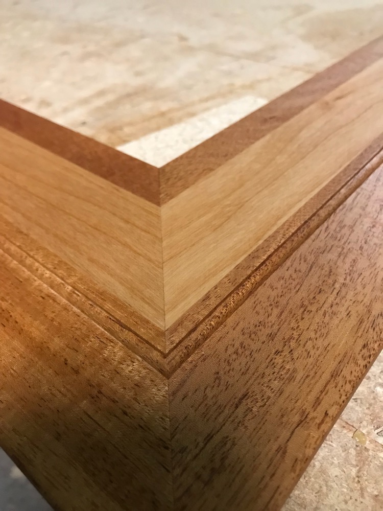

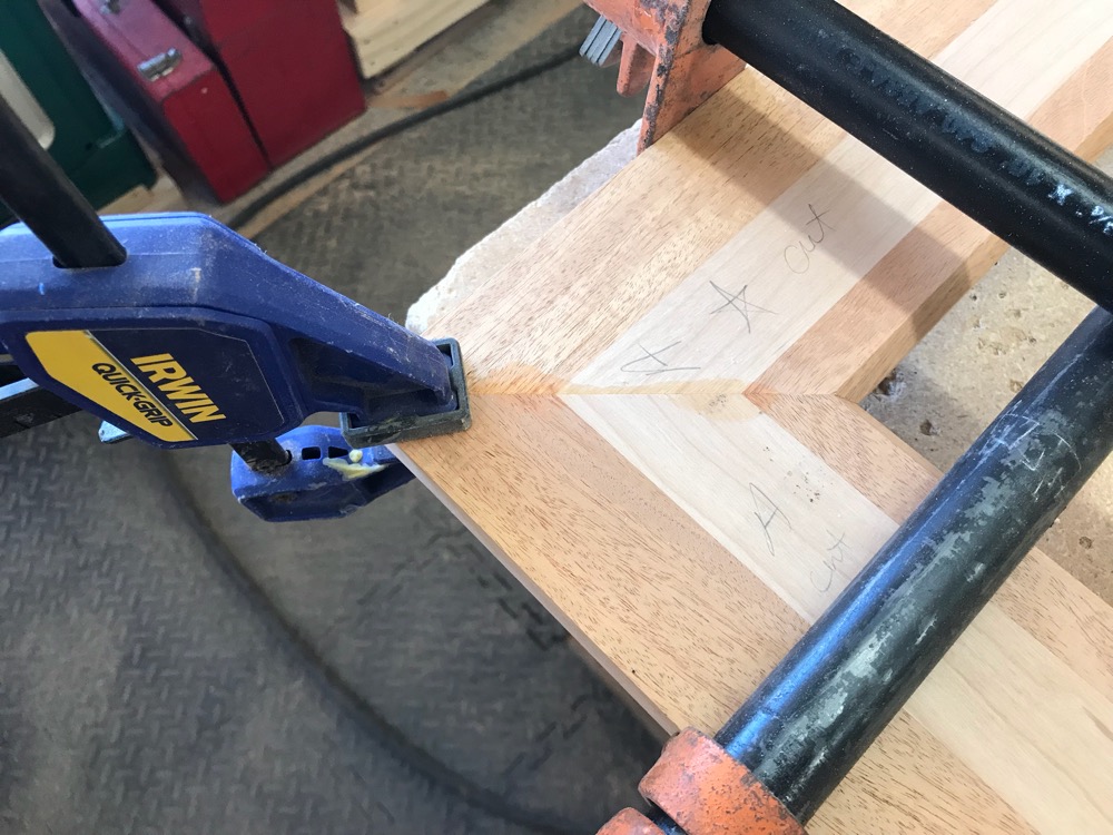

A fiend of ours was throwing out a perfectly good beveled glass mirror that I managed to save from the dumptster. It measured 41” square with a 1” bevel so I spent yesterday making a frame for it. The decision on the outside detail has not been made yet. I used mahogany and alder.
Paul

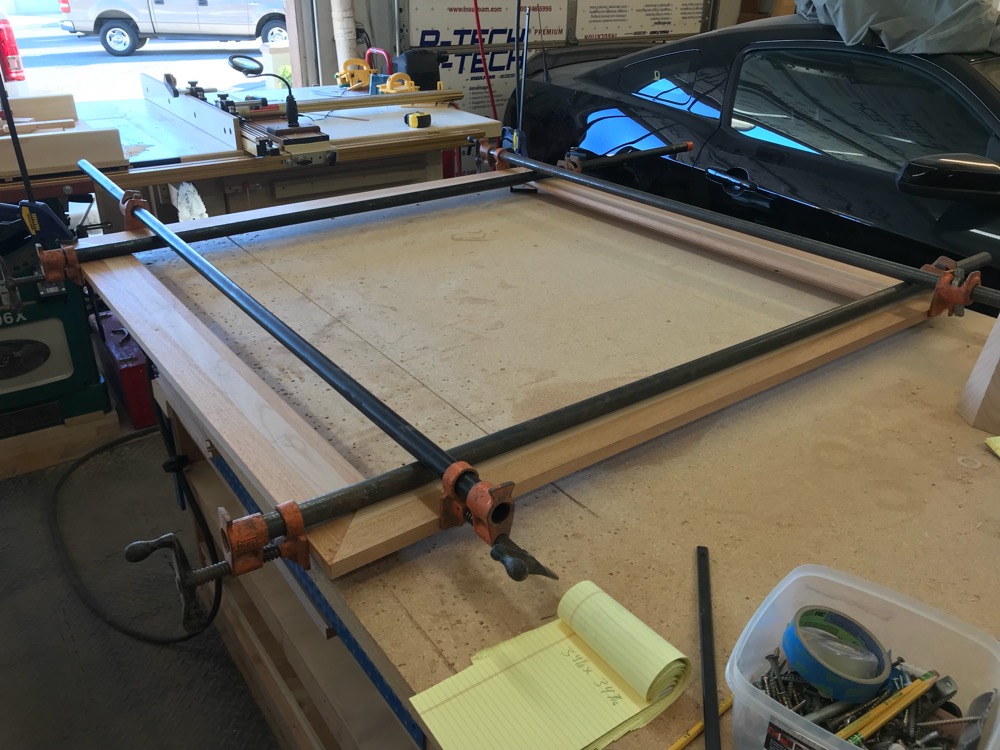

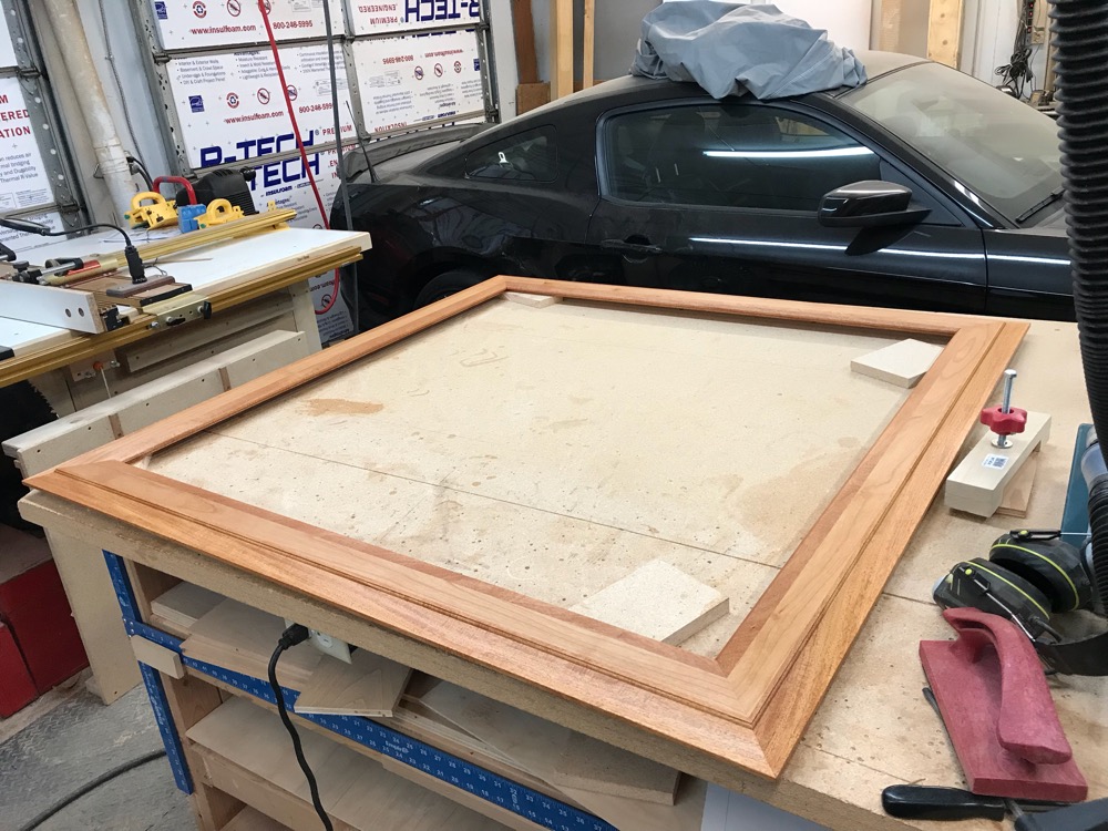

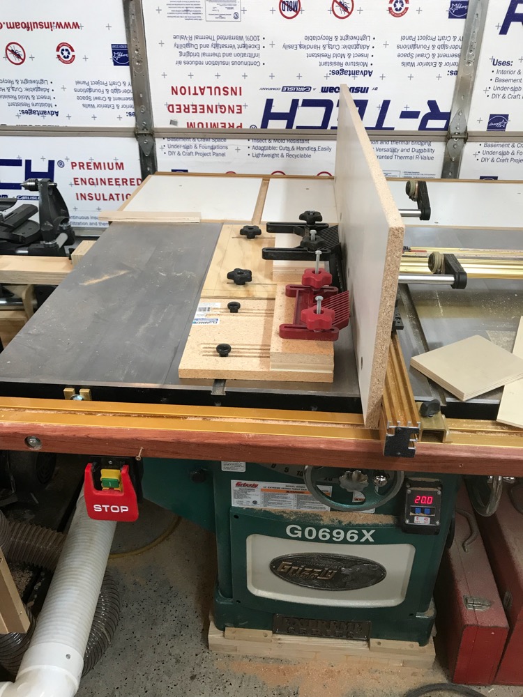

Managed to finish off the mirror frame today and get the first coat on.
Paul

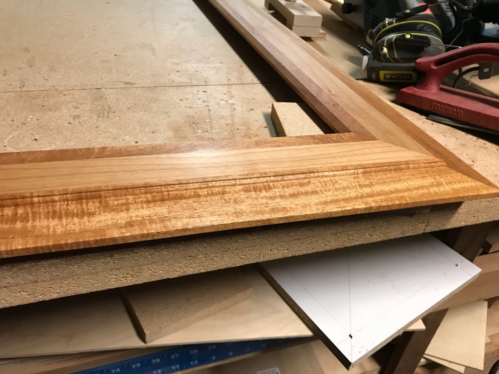

It would have never occurred to me to cut the edge profile after glue-up. What are the pro’s and con’s?

The pos are that the fine detail match up perfectly with the miter. The cons are a total blowout. That’s pretty rare as long as you keep control of the piece. Trying to match final profile on glue up is nearly impossible.

That makes a lot of sense. Thanks for the lesson!

Here’s a better view.
