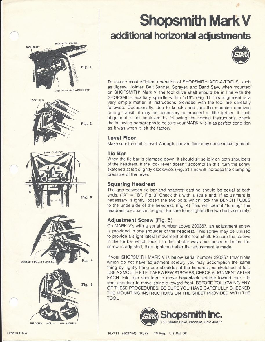

FYI here is the official information on how to do the adjustment when you have the old legs:
