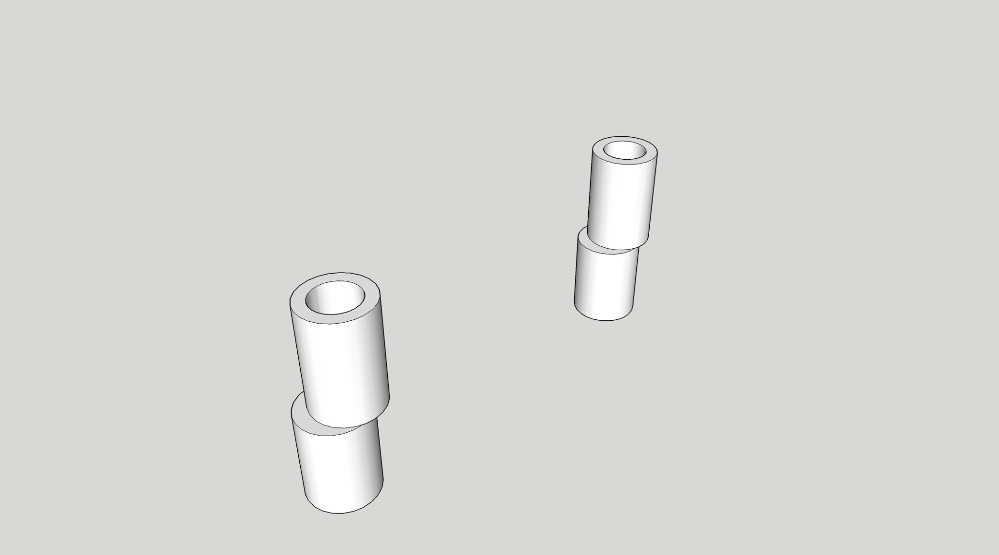

If you do not have a manual go to the support section and online manuals. Scroll down to find the Band Saw Manual. It is the current one but most of the information on setup and use is the same. In it you will find the mounting and alignment page to walk you through it.
Re: Bandsaw Spindle Alignment
Eccentric Tubes for post.png (139.03 KiB) Viewed 8806 times
Since you need to do an alignment to line up the hubs (headstock to accessory), I suggest the you remove the pair of eccentric tubes from the bandsaw and install them where you would with the bandsaw mounted. Get a chair, set yourself down at the end of the Mark V and twiddle with those eccentric tubes. You should notice that they move back and forth in all directions.
It is this motion that allows for lateral alignment of the hubs.
The attachment is intended as a visual aid for this discussion.

I am not saying you are wrong but my bandsaw (both of them) came with eccentric tubes. Well, maybe I can't say that the concentric tubes came with my bandsaw but they are what I have and I have NO straight tubes. Maybe this depends on what is defined as "older band saws".
However, whether they came with the band saw or not, they facilitate the lateral alignment of the hubs (for both the bandsaw and the belt sander. If the OP does not have eccentric tubes and still has the problem...maybe the solution is eccentrics.
