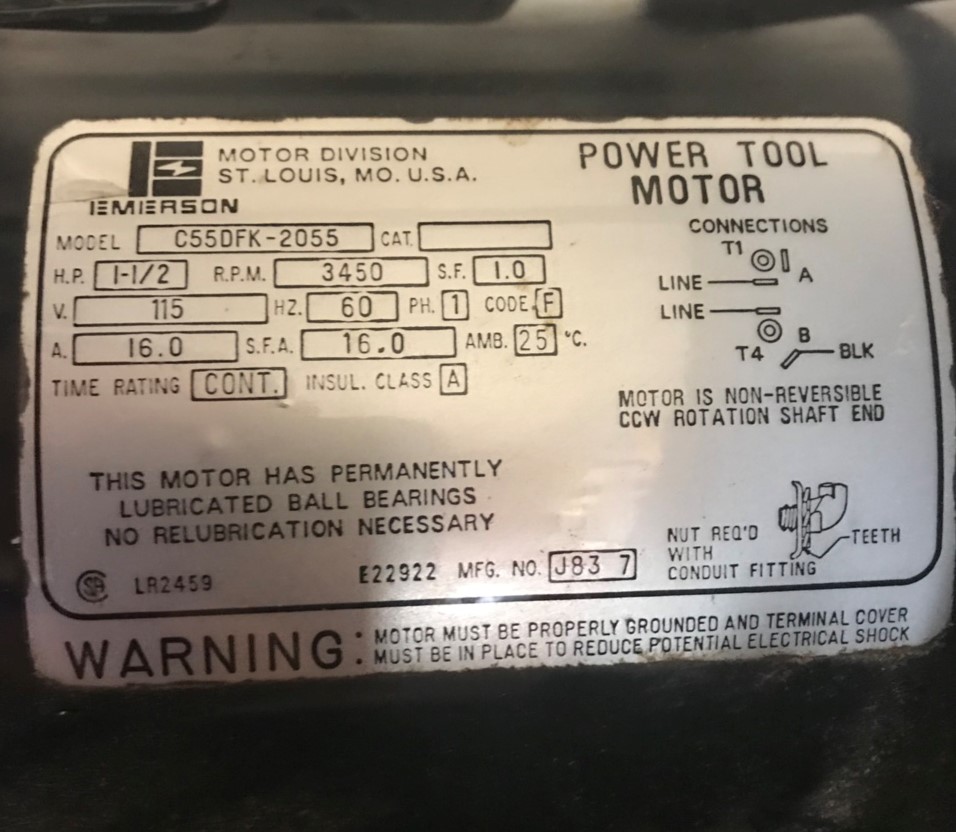

The motor pulley on there now is exactly the same as the one in the picture above. Although the motor shaft does have a keyway, and it is keyed. Maybe whoever had it before me got a pulley 2-pack.
See below for a picture of the motor label. The motor appears to be 1.5hp, so at least it isn't under powered.
If it was mounted to the stand later, are there instructions anywhere on how that procedure happened? Upon closer inspection, the motor doesn't look quite level. I'm sure the nuts just turned from vibration during use. If I'm doing all this, I'd like to make sure I have everything aligned properly so I don't end up back in the same spot.

At one time SS made Power Stands for all the SPT's. They all came with a 1/2HP motor except the planer stand. It came with a 1 1/2HP motor. The stand alone Pro Planer with cast iron table came with a 1 3/4HP motor. The power stands all had different part numbers. The stands them selves were all the same but they came with different pulleys, belts and belt covers depending on what SPT they were used to power, hence the different part numbers. Each stand came with an instruction manual.GregG wrote:Russ - I didn't think you didn't believe me, just posted the extra pictures in case they had other info I hadn't thought to share.
-Greg
There is an upgrade pulley kit for the planer power stand. It is still available and contains steel pulleys. These are the same pulleys that were supplied with the Pro Planer from the beginning. If it were me that is what I would get for your planer.

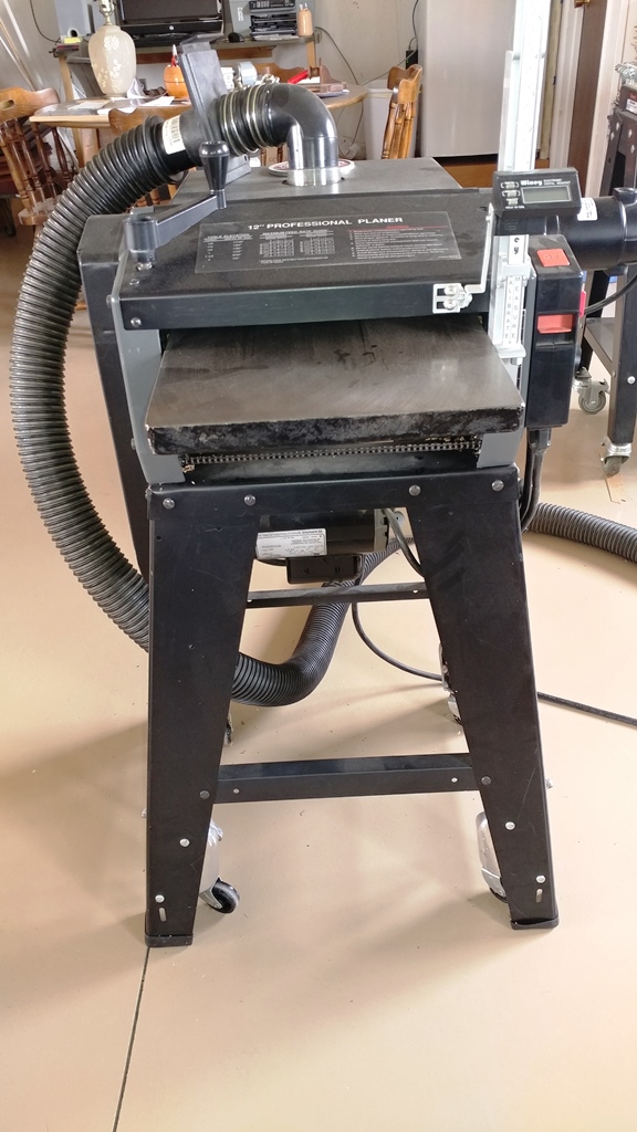

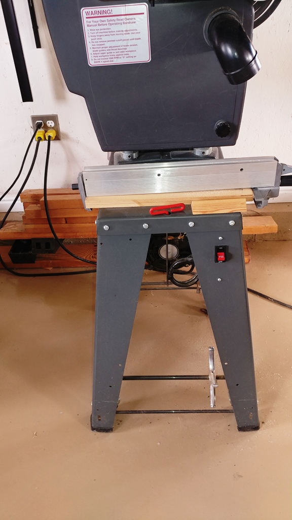

I think the only other difference is the dimensions of the top of the planer stand are larger than the other stands. As I said the motor is different but I believe it mounted the same way as the other stands. Even the Pro Planer motor mounts the same as the power stands I think. I am on my way out but will check when I get back. I also seem to remember that the manual was the same for all the stands with just difference information for each of the SPT's. Maybe not the planer stand however. I will check when I get back.
Re: Planer Help! Cutterhead Shaft with No Keyway
OK, here is what I found. All the power stands (Major Accessory Power Stands) are the same. As I thought there is only one manual for everything except the planer stand. They were sold for the Jointer, Belt Sander, Band Saw and Strip Sander. They all had a different part number and were composed of 3 sub kits. The stand kit itself which was the same, the motor kit which was the same (1/2HP) and the pulley/belt kit which was different depending on the SPT. That drove a different part number for each complete stand. The SS mounted planer stand is not included.
However, my pro planer stand is identical to the power stand including the dimension of the top of the stand and the rectangular cut out in the top plate for the belt that is not used. They are all 13" X 16". The only difference is that the Pro planer has a set of leg braces just above the castors and it is black. The motor mounts in the same way as the other stands.
So from that there is no reason to suspect the SS mounted planer stand is any different. If the Major Accessory Power Stand manual is available on the SS web site it should help. The pulley cover is different and the way you tension the belt is different. On the planer stand you have to raise and lower the motor to tension the belt. On the other stands you raise and lower the SPT in the mounting base to tension the belt.
