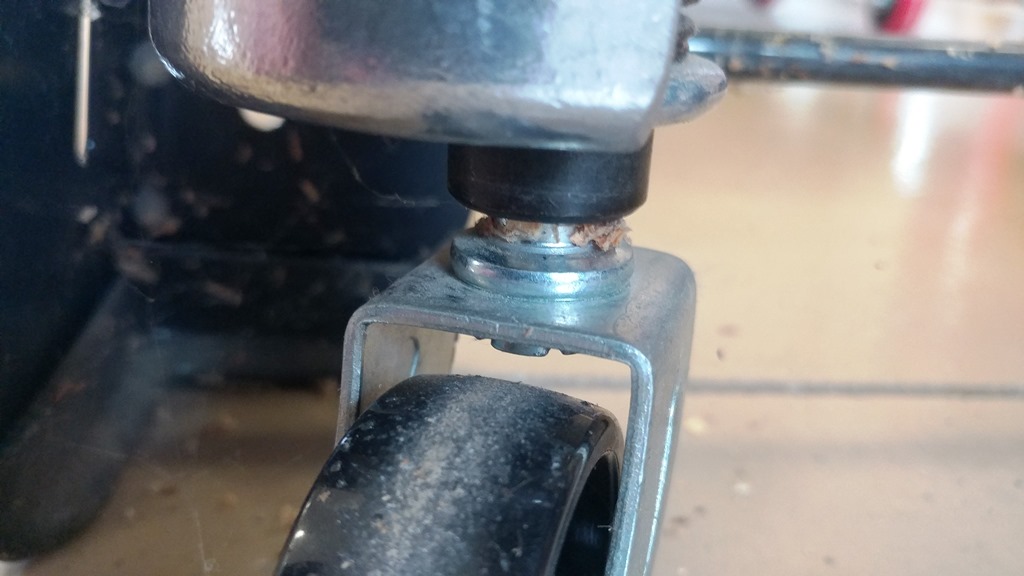

dusty wrote:I don't know what the ProPlaner weights but I don't believe it is heavier than a Mark V but if it is it is not enough to make a significant difference in caster fatique. It is not the wheels that have failed. It is the metal part that wraps over the top of the wheel (the part that has holes for the axles).
The price for Shopsmith casters is not out of line.
There is a little slop in the mounting holes but not enough to facilitate "adjustment".
There is enough room to redrill holes per the 3" instruction sheet but the support members that form the shelf above the whels would likely interfer with the pedal travel. Not worth the risk.
I am going to order the previously mentioned 2" casters for a test. I am sure that they will work. Swivel radius being the critical criteria these swivel in a smaller radius than do the Shopsmith casters. If these don't work on the ProPlaner I'll have $40 worth of casters to use elsewhere.
Report to follow in a week or so.

Re: New Wheels for Power Stands or Pro Planer
dusty wrote:
JPG wrote:I am assuming the SS caster in your pix was of fairly recent vintage.
Older casters have a 'ball' end.
The piston bore has a corresponding round shaped bottom.
The Mark VII pistons have a bad trait of cracking/splitting.
I consider that to be the result the caster protruding out of the lower end on the piston as shown in your pix.
So if the stem is shorter, the washer fix makes sense.(lowers the wheel)
Since the 'current' casters do not have the ball end(at least they do not look so in the pix), I think a shorter stem is preferred.
I be describing older pistons above re the bore end.
I am amazed the planer casters have stems that are too long. I suspect the same cause as some deficient motor belts a while back. :(
We gotta be careful here. I can not swear that these are Shopsmith casters. They may be some that I purchased from a different source. What I have shown and commented on are simple "the casters that have been installed on my ProPlaner" for a very long time.
Unfortunately, I cannot check the casters on my other SPT because they are all packed away in a POD.
If the consensus is that casters with 1/4" shorter stem will work I plan to order some of the alternate casters.

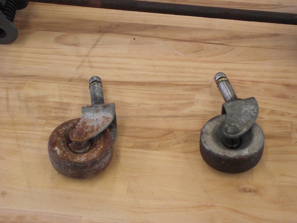

I wonder about that too. I have never seen SS 2" castors with red wheels. Anyhow here is a picture of my pro planer castor. The planer is on the floor but the castor is tight vertically so it is bottomed out in the piston. I have 7 sets of castors installed and they all look the same. The only ones that are different are the ones where the wheel is not tight to the floor. There is about 1/16" vertical play so they show a bit more stem.

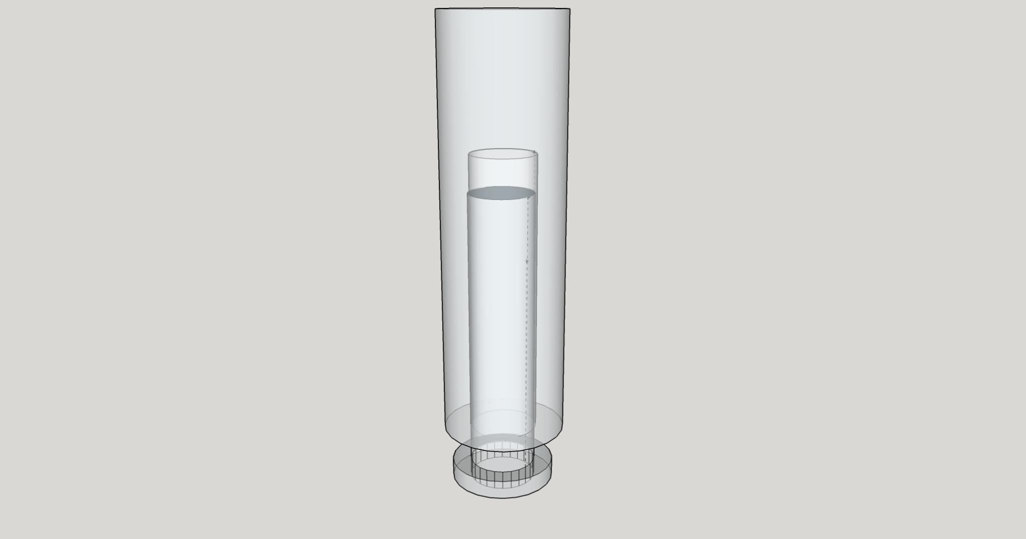

Maybe my comments are confusing. I did not mean to say the stems on the 2" casters are too long. If I have not made any errors in my measurements, the bore in the plunger and the stem length are the same (1 7/8"). But there is a 1/4" gap, as seen in mine and Johns photo images, between the wheel yoke and the bottom of the plunger.
Why the gap. It seems to me as though the stem should bottom in the bore and thus bury the stem within the bore.
While pondering that keep in mind that the stems on the 3" casters are 7/16" shorter and they are nearly buried in the plunger.
The grip rings on both the 2" and 3" casters are located the same distance from the ends of the stems (about 1/4").
Shopsmith Plunger and Caster Stem.png (99.01 KiB) Viewed 4885 times
I so wish Shopsmith published detailed mechanical drawings.

dusty wrote:Maybe my comments are confusing. I did not mean to say the stems on the 2" casters are too long. If I have not made any errors in my measurements, the bore in the plunger and the stem length are the same (1 7/8"). But there is a 1/4" gap, as seen in mine and Johns photo images, between the wheel yoke and the bottom of the plunger.
It seems to me that the reason is this. The swivel point on the 2" castors is the domed end of the stem on the bottom of the piston bore as JPG mentioned. With the new castors the swivel point is the ball bearing race on the castor so you want the stem to be shorter than the piston bore to allow the weight to be carried by the piston on the ball bearing race of the castor wheel. Even the 10ER steel castors have a rounded end on the stem.

The stems on my 2" casters are ball shaped.
What the end of the bore looks like, I don't know.
It doesn't seem to matter though because it seems that the stems do not reach the bottom of the bore. They would IF the caster went all the way in. Looking at Johns' picture and at mine it can be seem that they don't. There is about a 1/4" gap. This is what my sketchup was intended to show.
