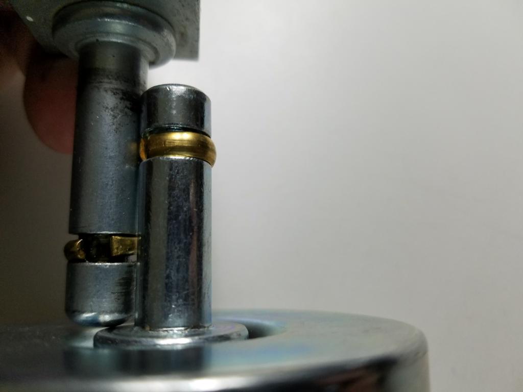

Edit: I am still at the drawing board. Determining compatibility is not as easy as I thought it would be. I don't have the new caster in question but I do have a Shopsmith 2" caster. In comparing it with the Shopsmith 3" caster I found a difference that I did not expect. The stems are not the same length. The 2" wheel has a stem that is 5/16" longer .
I am unwilling to say that I got this wheel assembly from Shopsmith simply because there are years (many) involved and I do know that I have purchased wheels in that time. Nevertheless, the wheels that are currently in my ProPlaner have this extended stem so this may be what is contributing to my wheel wear. My wheels on this SPT seem to be at a slight angle (off vertical).
I think I am going to have to buy four wheels just to do a test fit. I am very interest6ed in the forums thoughts regarding the impact of different stem lengths.
Notice the wear marks on the longer stem.
Edit:
Some of the mystery solved. I bought wheels and installed them in Shopsmith casters. So the 2" casters that I have are all from Shopsmith. Now for part of the mystery I have attached a photo of one of these wheels installed in the caster assembly on my Pro Planer. In the photo you see the caster stem inserted into the plunger. Note that the caster stem does not go all the way into the plunger. Full insertion is prevented because the stem is longer than the bore in the plunger. BTW the plunger is shown in the full up (maximum lift level) position of the caster assembly .

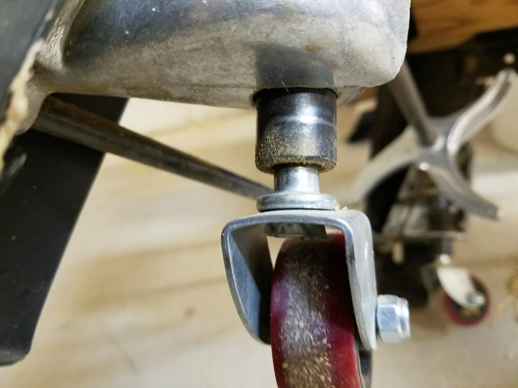

I am assuming the SS caster in your pix was of fairly recent vintage.
Older casters have a 'ball' end.
The piston bore has a corresponding round shaped bottom.
The Mark VII pistons have a bad trait of cracking/splitting.
I consider that to be the result the caster protruding out of the lower end on the piston as shown in your pix.(BTW I believe the caster is dropped down about 1/16" and is not inserted fully into the piston bore in your pix)
So if the stem is shorter, the washer fix makes sense.(lowers the wheel)
Since the 'current' casters do not have the ball end(at least they do not look so in the pix), I think a shorter stem is preferred.
I be describing older pistons above re the bore end.
I am amazed the planer casters have stems that are too long. I suspect the same cause as some deficient motor belts a while back.

We gotta be careful here. I can not swear that these are Shopsmith casters. They may be some that I purchased from a different source. What I have shown and commented on are simple "the casters that have been installed on my ProPlaner" for a very long time.JPG wrote:I am assuming the SS caster in your pix was of fairly recent vintage.
