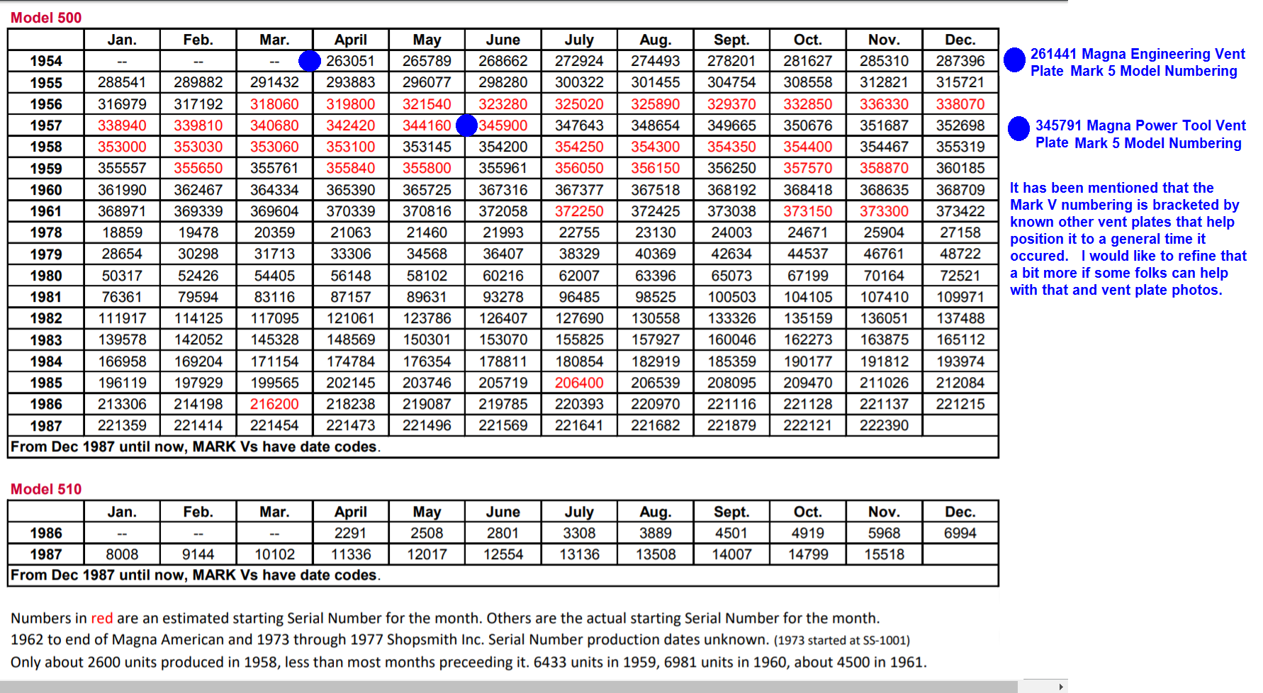

We have extablished by photos of vent plates:
Early (prior to April) Mark 5 from 1954 261441 has Magna Engineering Vent Plate
Later (prior to July) Mark 5 from 1957 345791 has Magna Power Tool Corp. Vent Plate
This Shopsmith Serial Number data indicated Mark 5, Mark V, and 500. I would like to nail that down more if we can.
I would like to refine this with more vent plate photos to help refine when the model number changed from Mark 5 to Mark V. It has been discussed that some have a handle on this that brackets it into a group of numbers.
The Two Dots represent the two vent plates identified in this thread, NOT exactly the start of the time these references first appeared on the vent plates. That too needs more 'bracketing'
JPG could you elaborate on that some with some photos if you have access to them?
Everett

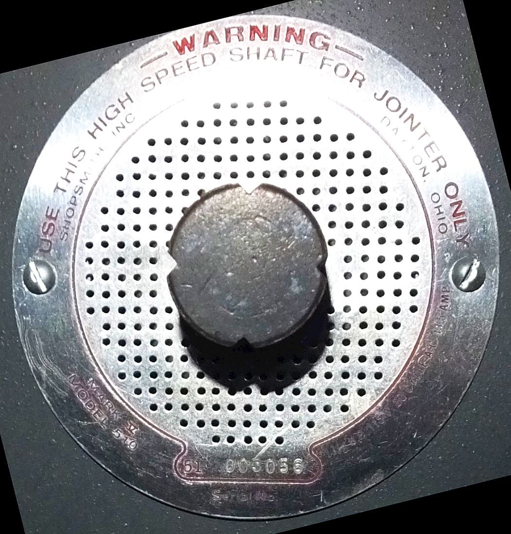

My early 510 vent plate. 6/1986(invoice).

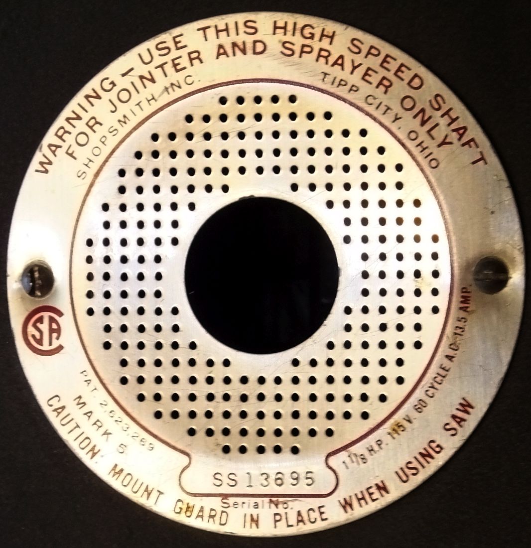

JPG's two vent plates are first from a Mark 5 SS13655 made prior to 1978 when the Shopsmith Inc. records start. The other is from an early Mark V 510 Serial Number 51 003056 made in June 1986.

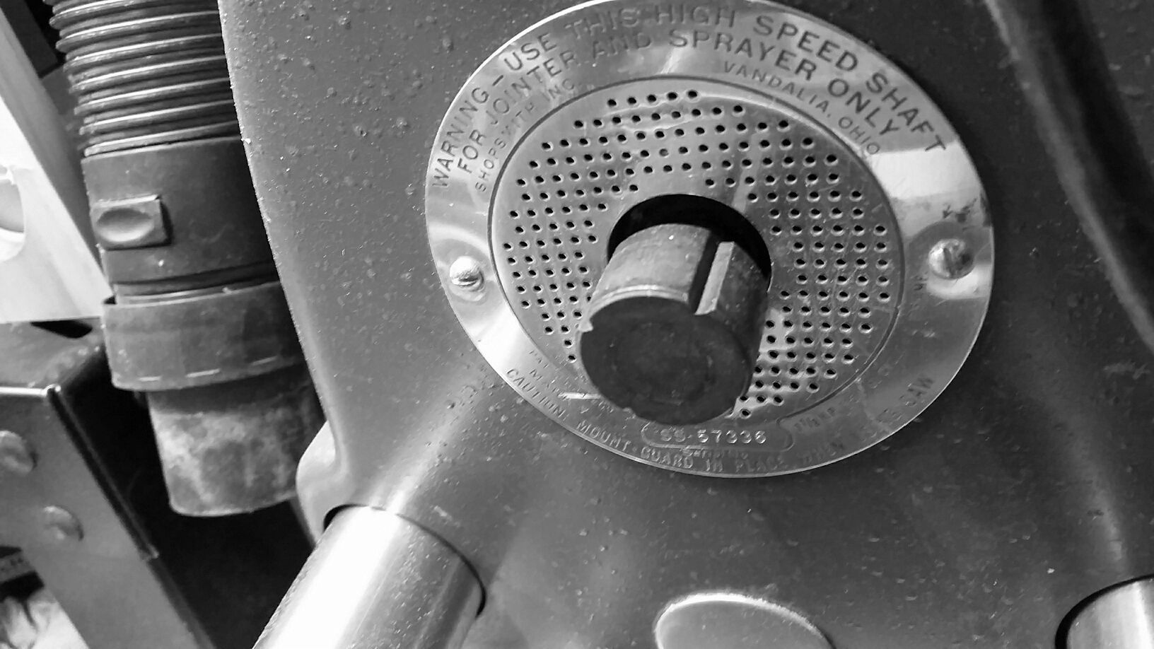

The middle one from Ed, Serial Number SS57336 was made in April of 1980 and is a Mark V which narrows down the change from Mark 5 to Mark V between January and April.

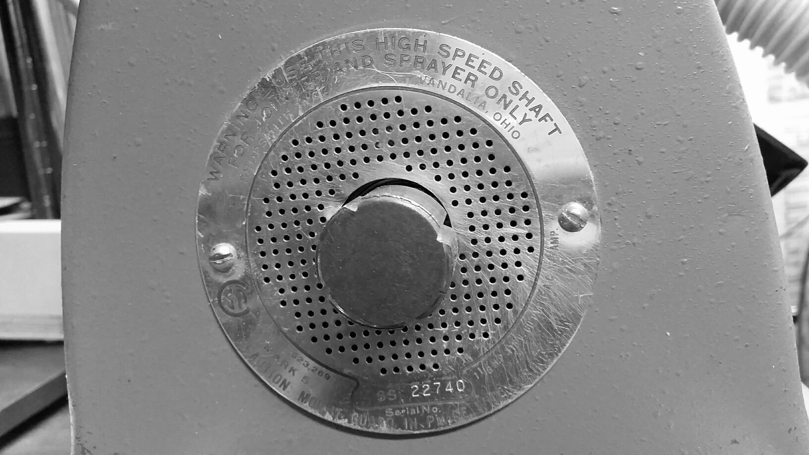

Looking at the information I have as to the locations of Shopsmith Inc. as marked on the Vent/Serial Number Plates of the Mark V/5's.
Tipp City Prior to 1978 Serial Number 12578 (Cannot date because we do not know the production dates)
Vandalia June 1978 to September 1983 Serial Number 22218 to 161521

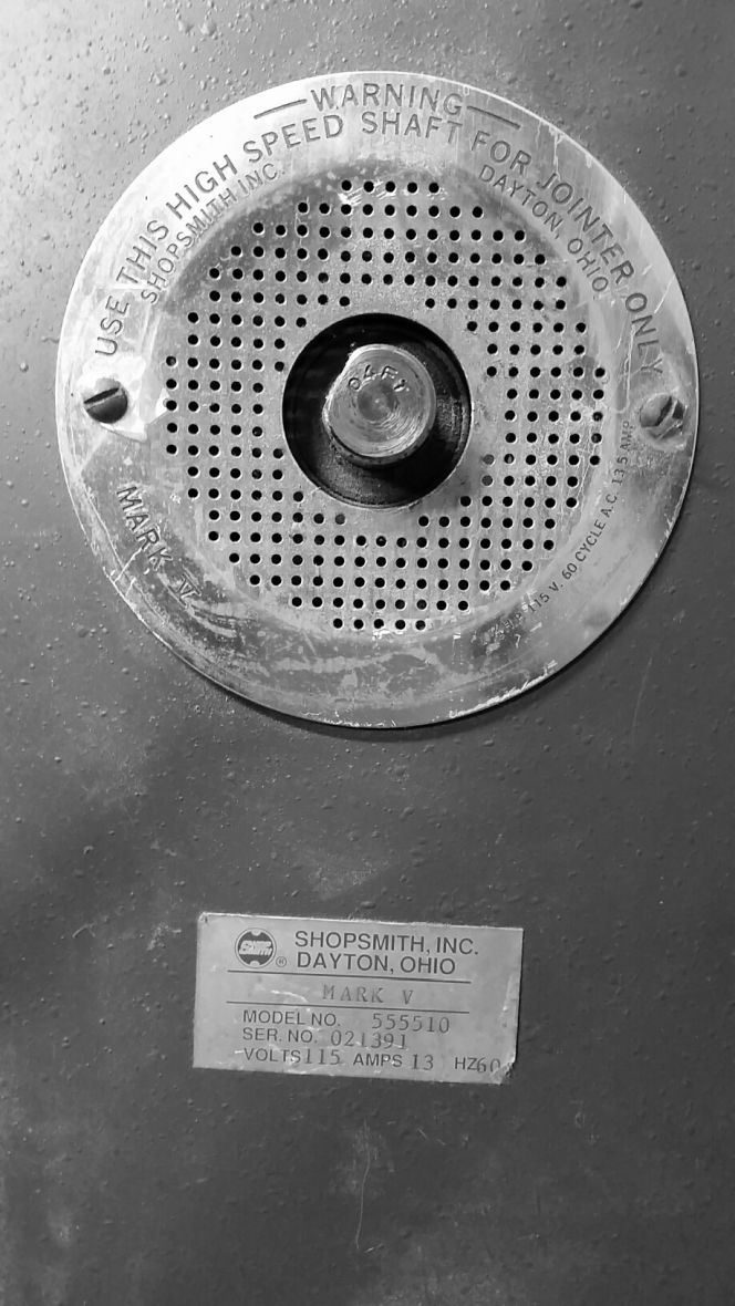

Dayton November 1984 Serial Number 192661
Mark V-B November 1984 to March 1985 Serial Number 192661 to 199647 (from only three plates) Where all between these dates Mark V-B's? Additional note - These are the only three plates I have seen in this serial number range. The third is 195168.

Maybe the V-B was the introduction of the 2 bearing quill?
- Posts: 4533
Re: Shopsmith History
Sounds possible
From Shopsmith records
September 1984, Two Bearing Quill replaced single bearing quill in headstocks Serial number 190000 & above.
The V-B could have been dropped when the Mark V 510 & 505 came out changing the original table system to the Mark V 500
