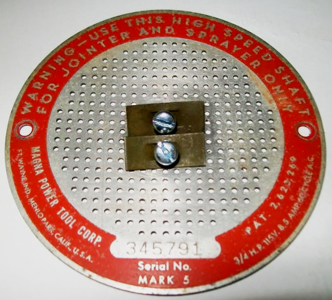

Also in 1958 to 1960, Yuba then Magna American made the Mark II for Montgomery Ward which was gray. I have advertising to show that they marketed it under their own name as well at the time as a Mark 2, Magna Power Tool Corporation - May 1958, which one of my Greenies (345791) Vent plate shows as a Mark 5 made by Magna Power Tool Corporation.

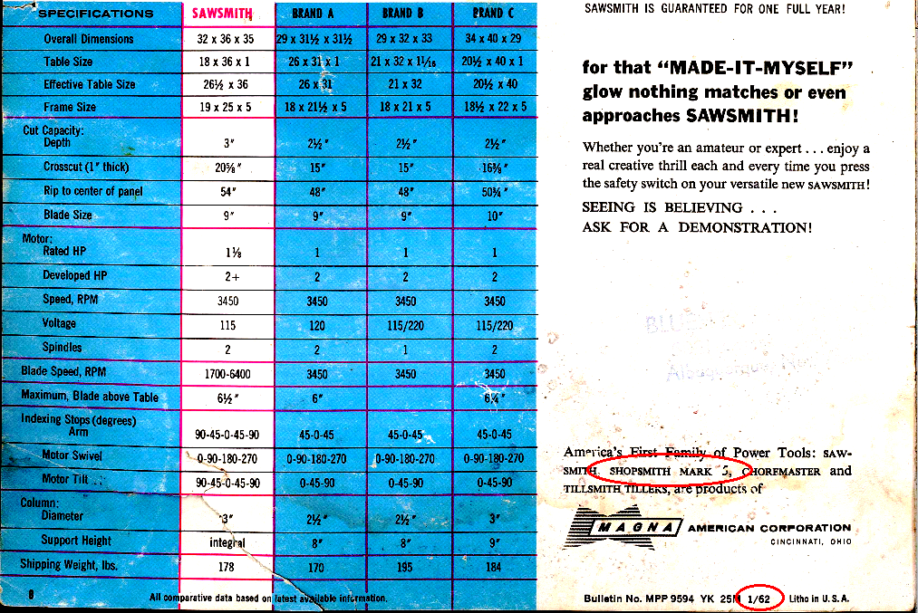

Note Magna America Brochure extract that I have included dated 1/62 shows the Shopsmith as a Mark 5, but I believe that the Mark V renaming was in the works due to the Mark VII and Mark II model naming conventions which by now existed.
