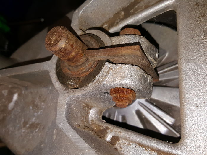

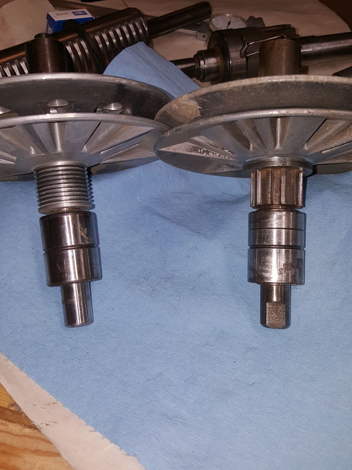

Started disassembly today. The quill was barely on the quill feed pinion and there was no tension on the pinion. Not sure if it is of interest but the quill has 6 splines. I got the belt cover off and noticed one of the ears for the idler shaft was broken off so I will have to replace the headstock casting. You can just see it at the top of the picture where the tab and main casting meet. I know that different motors were used at different times so if it help narrow the manufacture year the motor is a Franklin.

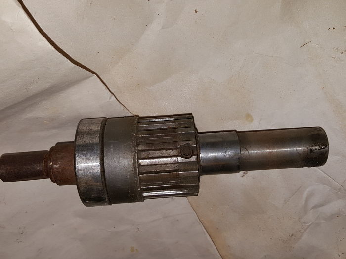

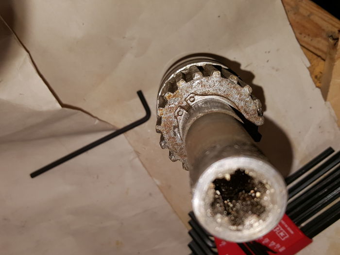

Re: Laying in my truck bed...
I have the headstock mostly disassembled. The Gilmer drive may be one of the early ones. I only see one set screw located on the groove end. I need to get a bearing puller before I can tell for sure. It does look different from the pictures of Mickyd's Gilmer drive. https://www.shopsmith.com/ss_forum/view ... #post32871 The inside bearing got stuck in the headstock casting and pulled off.
Gotta agree with that conclusion.
IIRC Nick has stated the headstock CAN be welded.
Got any good welder friends???
FWIW, the bearing retaining clip looks 'thick' and there is only one. Possibly another early Mark 5 variation?
P.S. Interesting lock nut as well(OEM?????)
- Posts: 4545
Brenda,
Great pictures of the drive parts. Your Greenie appears to be a very early one. The drive pulley without the clutch was only used for a short time according to Everett's research and information from my first Mark 5 manual. The Bearing Retainer for the idler shaft was not on the first machines but was added soon as the problem of the bearing not staying in place showed up. When included on the eccentric mount it was in pairs. I wonder if yours was an addition and not original. Either way your Greenie was made within the first few months of the release of the Mark 5. What we believe is the second manual, that Wiley has, shows the drive sleeve assembly with the clutch and came out in mid 1954.

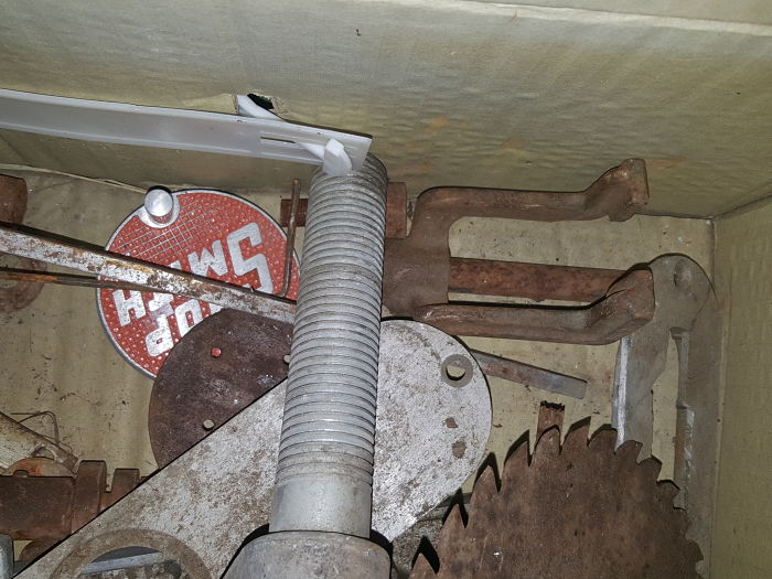

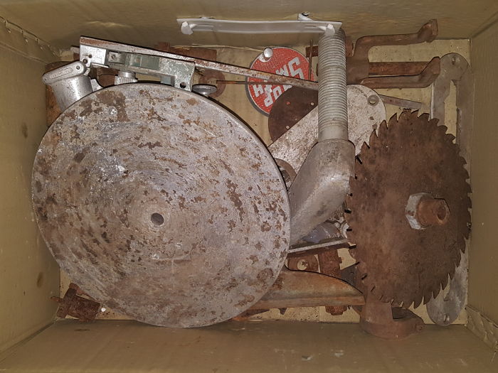

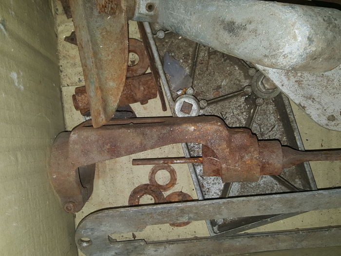

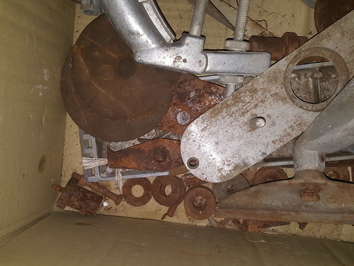

I opened the box that came with the Greenie today. Placed some items into a container of Evaporust to soak. It will take a while to go through all the different small parts to figure out what they go to. I think there are a couple of shaper arbors, a dado arbor and a 1/4" router arbor at least on the bottom layer.

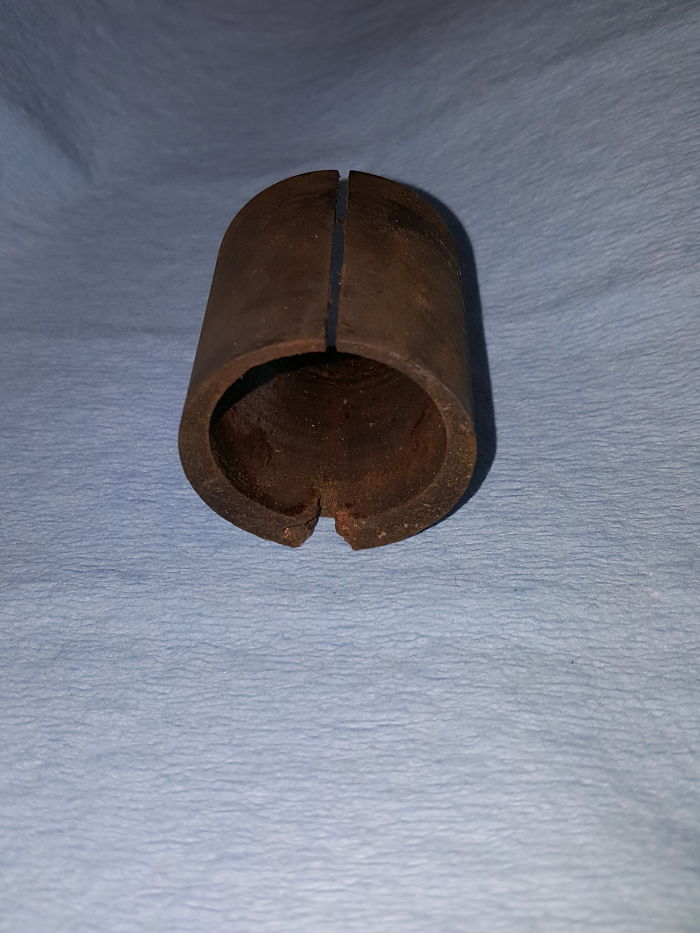

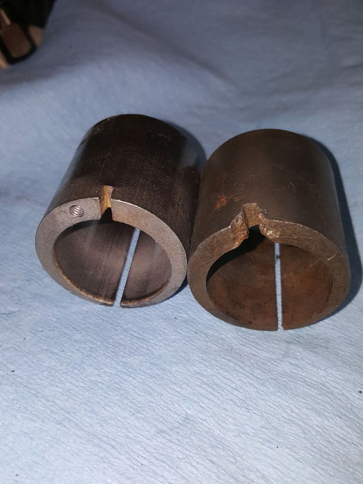

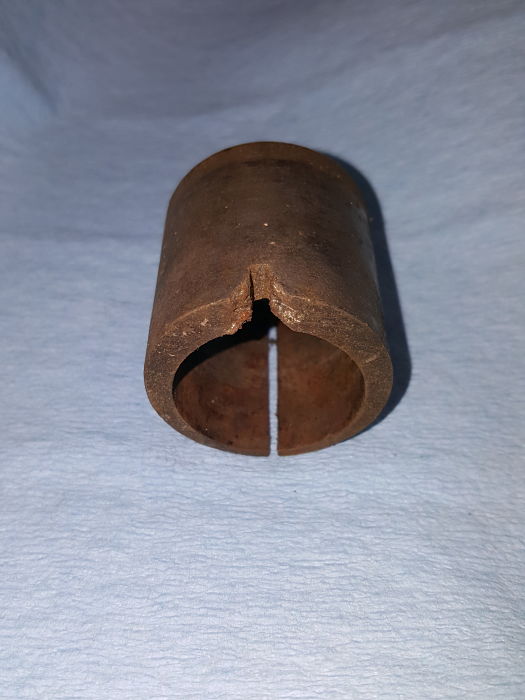

The eccentric is different from later Greenies as well. This one does not have the set screw in the side of it and it has a split like the later models without the screw in the end of it.

So it's the new eccentric. What does the idler shaft look like?

I am not sure if it is the new eccentric. I pulled out the parts from my 1998 510 that I removed with the PP upgrade to compare the parts to just to make sure everything was in good condition. The eccentric from that and the one from the Greenie are similar but at the same time not exactly the same. The one from the Greenie does not have the tapped hole for the screw.everettdavis wrote:So it's the new eccentric. What does the idler shaft look like?
Everett
I also compared the idler shafts. They look almost identical.
Since your "A" greenie has the bearing retaining clip I would expect the eccentric to not have the 5/16-18 tapped hole for the cone point set screw. IIRC the clip prevents both the eccentric and the bearing from slipping out.
If I do NOT recall correctly, your eccentric is likely an early version that preceded the inclusion of the bearing set screw.
