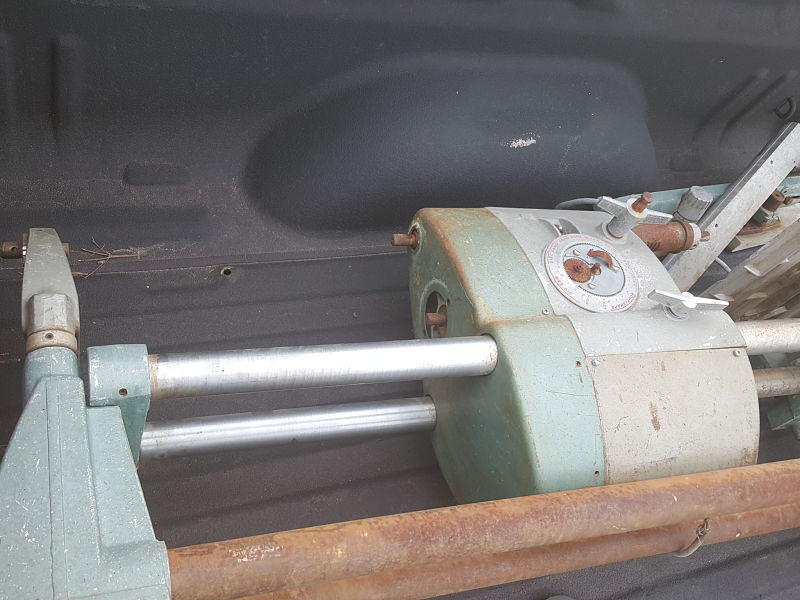

A $50 SS was just too good a deal to pass up even with the amount of work needed to get it operational again. There is a lot of things missing from this unit but it does have the main table, carriage, fence, shaper arbor, shaper fence and mortising attachment. The vent cover is missing so no idea about serial number but the speed control handle (missing the set screw) is in the box of stuff that came with it. I have wanted to get a unit to make a shorty out of for a while now and at this price, I am not worried about the missing accessories. With all the rain, the guys that loaded it in my truck laid it down so the bed cover could go over it. Now I just need to be able to get it out of the truck.

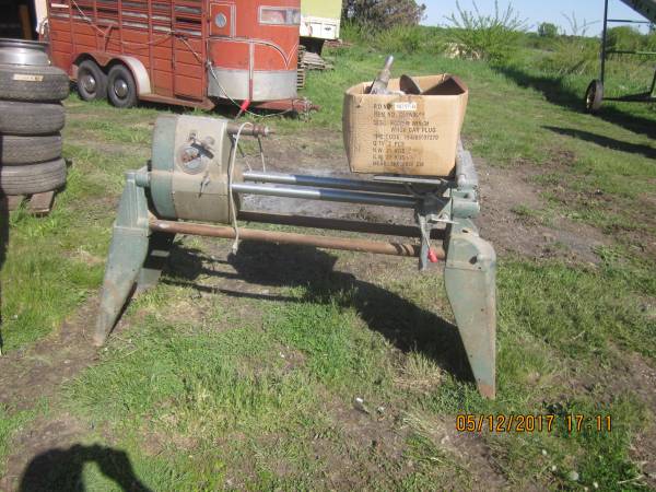

- picture from the ad

Early "A" casting(8 belt cover screws).
It is a bit different from a MarkV.
Future access to the control sheave for lubrication will be frustrating

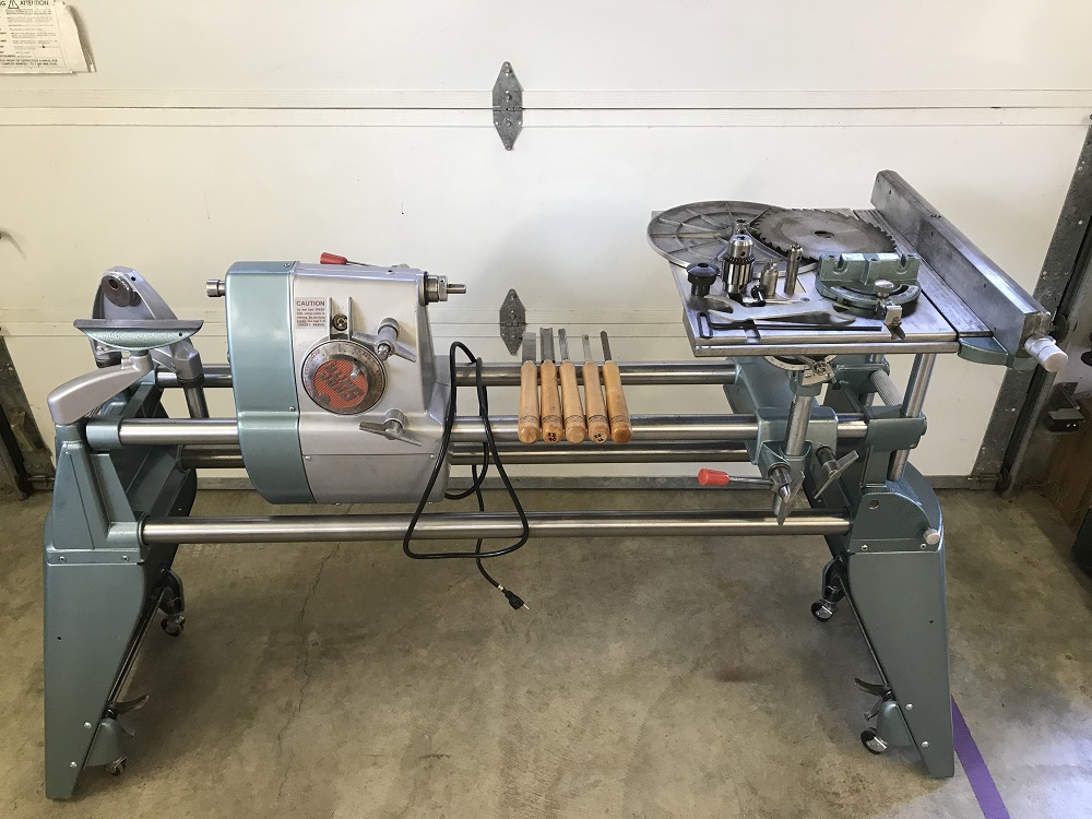

It's not hopeless but you do have some work ahead. I restored a Greenie in similar condition and it came out looking and running great. I did have to replace the quill on it since the rusting had caused some pitting. There were other parts that had to be replaced but the motor and sheaves were all good.

This is what mine looked like when I went to pick it up. This is what it looked like when I finished it

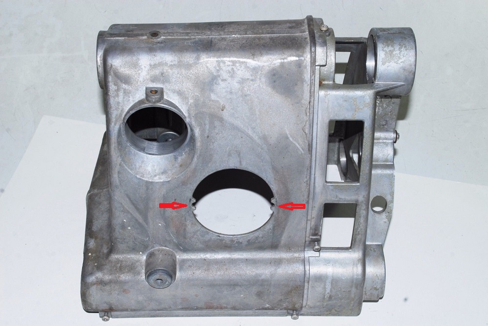

You could use the Headstock parts left over from your 1998 Mark V permanently unless you want to have the Headstock original. Even keeping it original you may wish to consider adding the access hole behind the rear logo plate. It does require a "B" headstock cover plate and cutting out the hole leaving just the tabs around the holes for the pins. There was something that came out, way back, on how to do it but I can't find it right now. It is something I have in print or digital. It was a fairly simple fix to not having the access hole but a bit of work. First mark the circle opening between the two pin holes than drill just inside the circle all the way around leaving space for tabs on either side of the pin holes to hold the pins on the "B" cover. After removing the bulk of the material for the hole file down the remaining metal to round the hole to the edge of the circle but leaving the pin tabs. Sorry I do not remember the diameter of the "B" headstock cut-out and I only have "C" headstocks at this time. The arrows on the "B" headstock picture below show how the tabs should look.

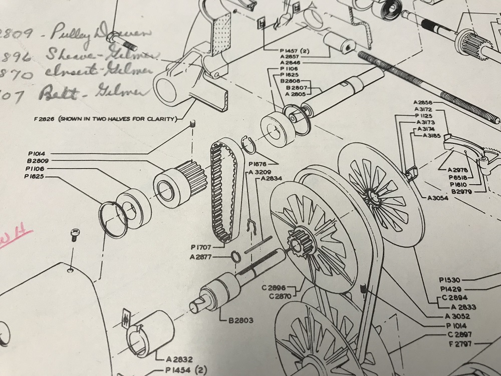

Have you got inside the headstock yet? Everett was looking for information on the early "Greenie" Drive Sleeves without a clutch as seen in the diagram below. See part B2809. If yours is like this it would be great to see some pictures of the Drive Sleeve. If your drive pulley is solid and attaches to the shaft with a set screw your "Greenie" is one of the early ones from 1954. It wasn't very long before they added the clutch to the drive sleeve. Probably got a few complaints about broken belts. I just sent Everett a JPG copy of the first Mark 5 Manual about an hour ago. I do not know how soon he will have it available.
