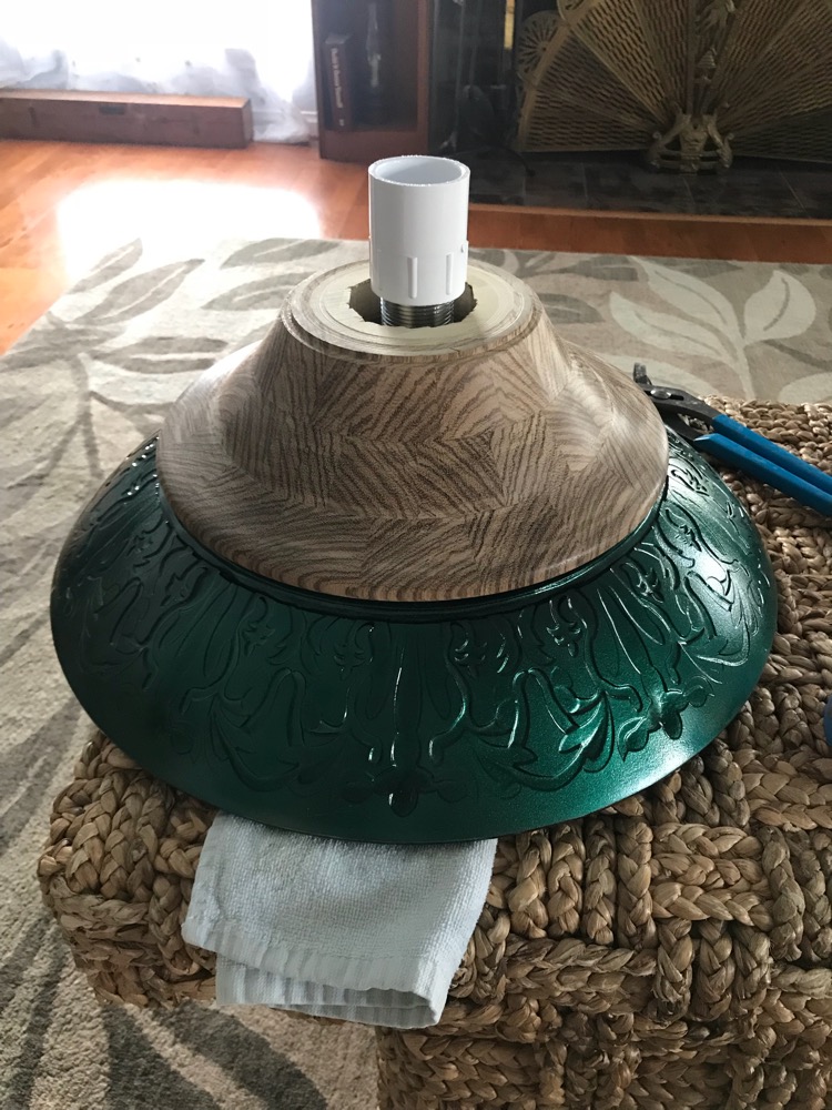

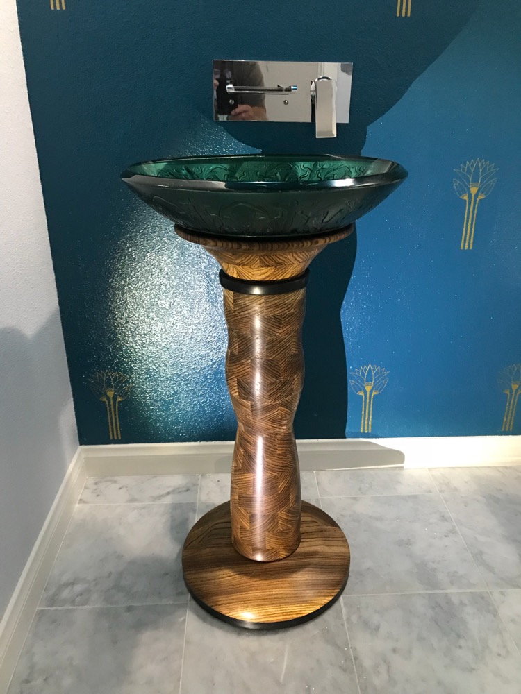

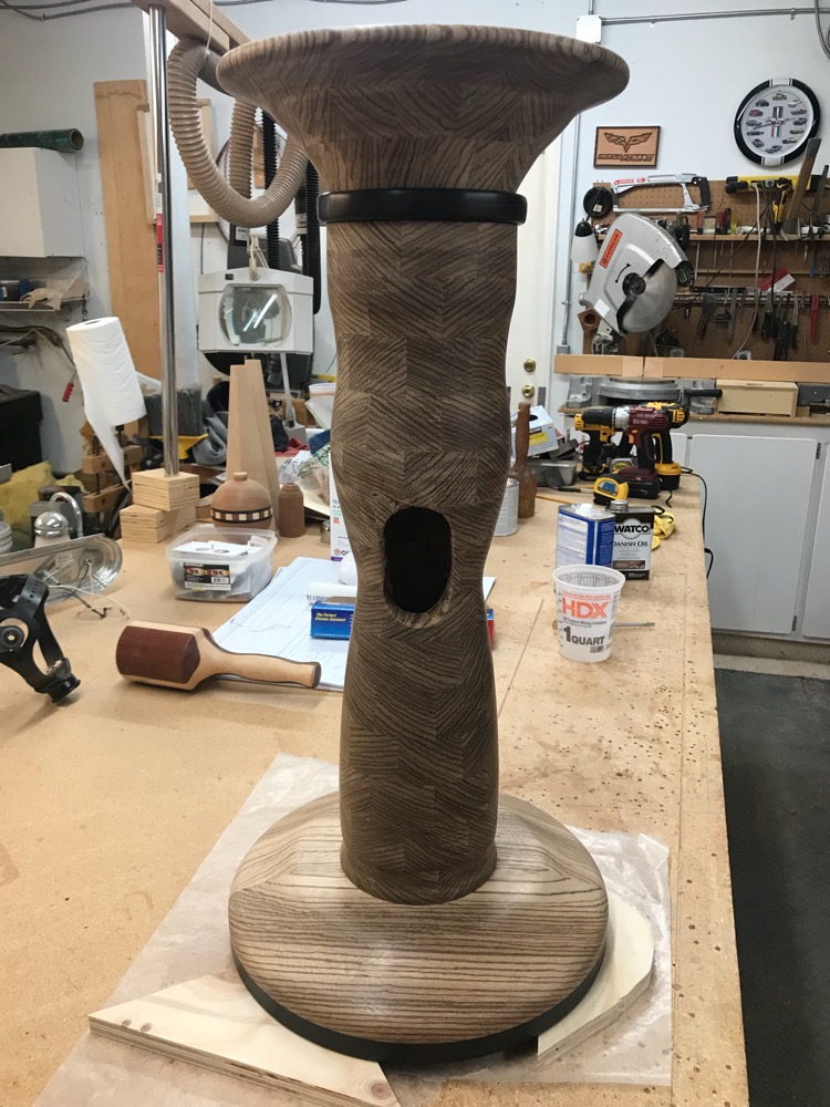

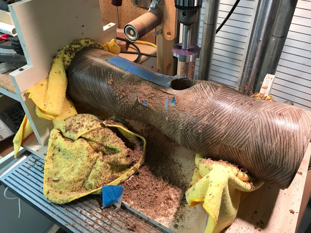

Everything is moving along. I got the vertical support stanchion in and the pedestal fitted. Cutting the hole for the plumbing exit got interesting using a 2 1/8” forstner. I had to build a cradle to clamp it to the SS table and then a lot of chiseling. The first coat of finish is on and hopefully only two more coats will do it.

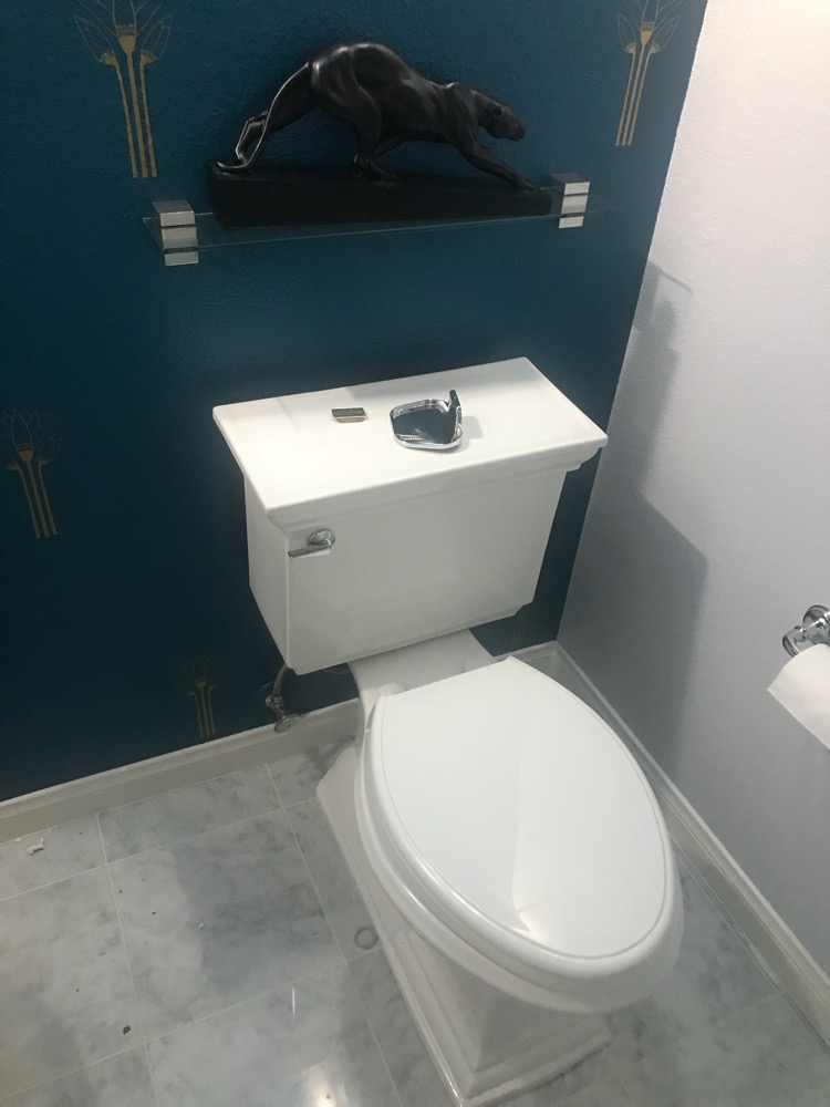

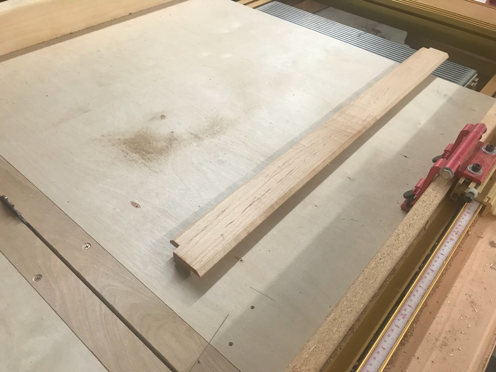

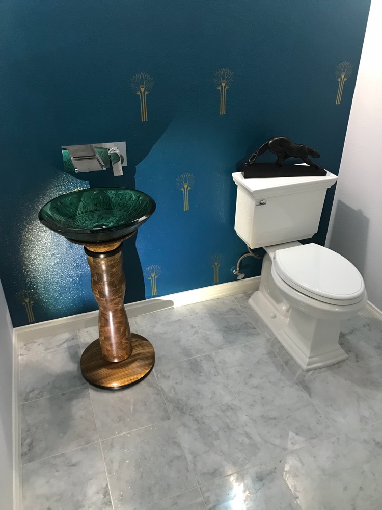

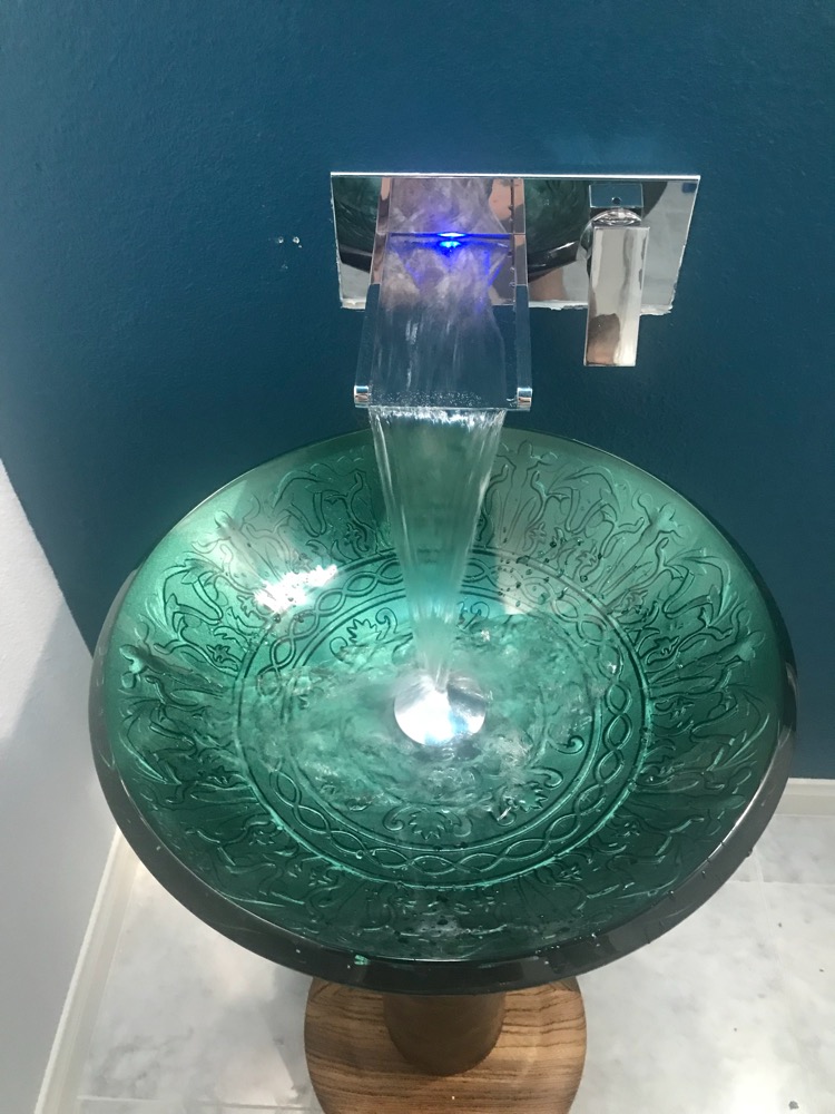

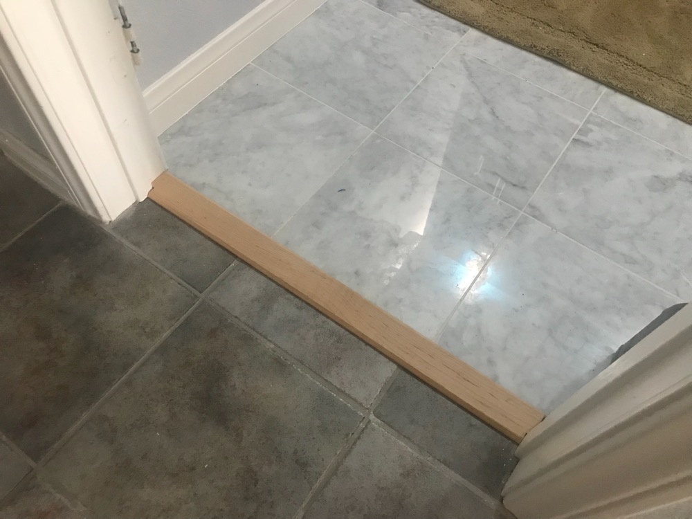

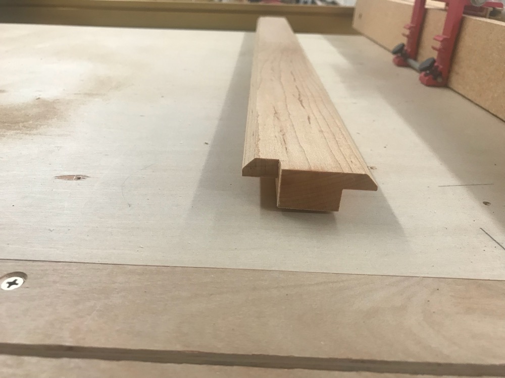

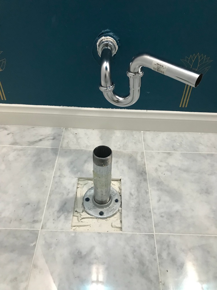

Finally finished the plumbing with drain and faucet in and working. Also got the threshold done for the transition from the marble to the tile and the glass shelf for the panther statue. Tomorrow the touch up paint and put the door back on and done.

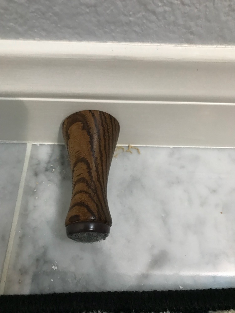

So my final task for this room was a door stop. She objected to the 2X4 block I had in there as a door stop for some reason. I was heading over to HD to buy a door stop when it occurred to me that I have a bunch of end scraps of zebrawood so I decided to use up a small piece and turn one. Used a furniture leg pad for the end.
