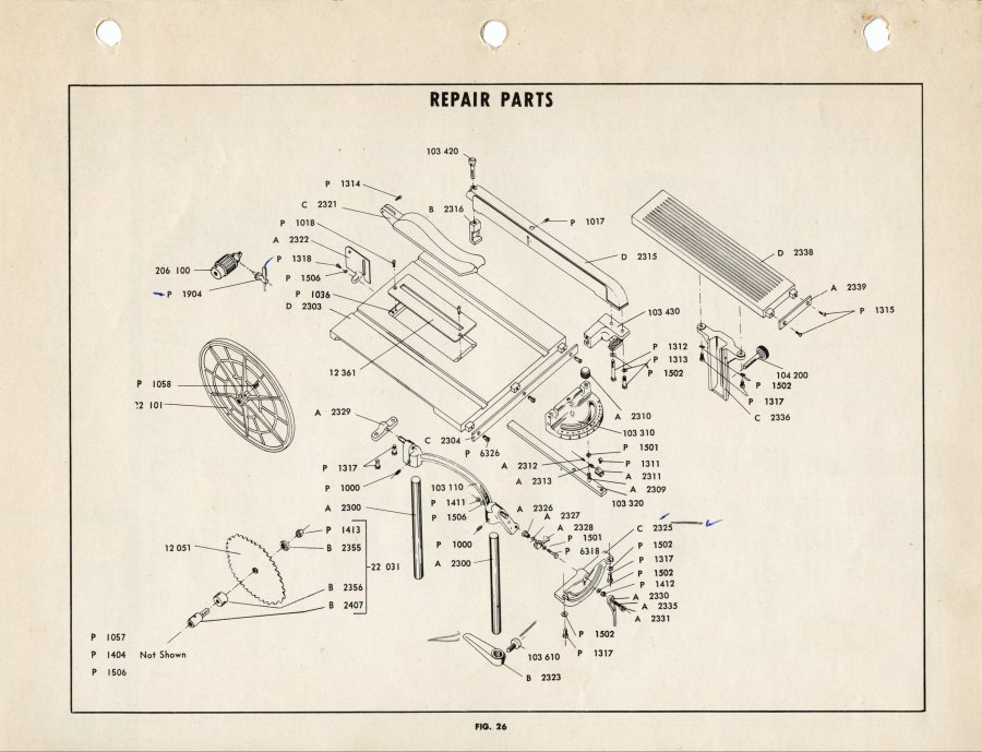

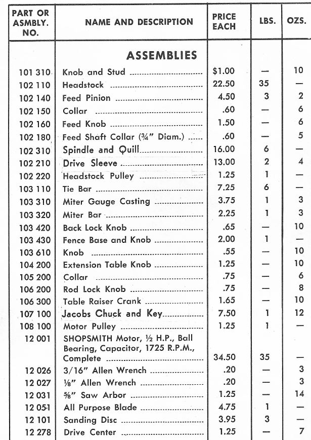

amboyna wrote:What was crazy was I could not find part number 107700 or 107880 on either page of the parts list. Here is the second page. The inside of this 4 page brochure is exploded parts drawings.
No that is not Crazy.
It makes sense since the document is intended to apply to 'current' models.
However since those two parts are of an earlier model version it makes sense to only mention them in the list and omit them from the parts drawings which are of the 'current' model.

Your explanation makes sense. I did not think of it that way.
So an earlier parts list would have those numbers?

Re: Trying to date my 10ER
amboyna wrote:Your explanation makes sense. I did not think of it that way.
I doubt it. Those numbers are so much different from earlier/typical part numbers 'then'.
HTH would I know? :D I just be on the outside looking back.
i.e. I know not why they are different.

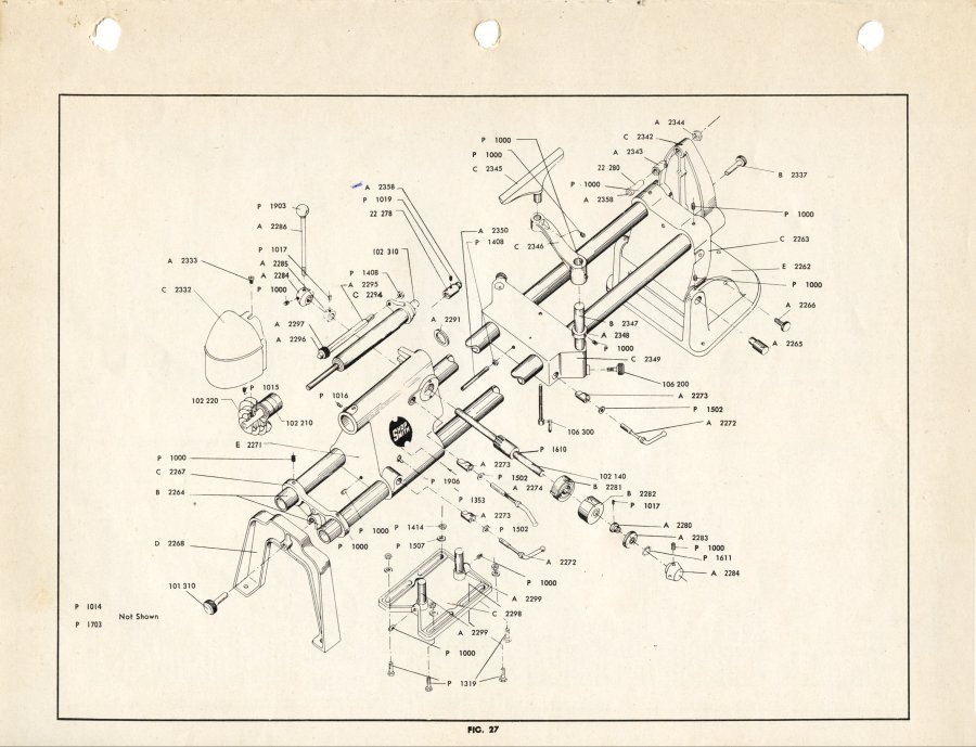

Here are the exploded drawings to go with the Parts Lists.
There is a 106200 and 108100 number. But no 107700. There is also a 206100 number, which is used by the Mark 5. My Mark 5 parts list has some 6 digit numbers that start with 2.
I looked through the rest of my papers and found nothing using a 107---
number.

Bruce commented about this
number.
Again it makes sense not to see part number 107700 on those drawings since it was apparently for one of the previous versions of the way tube locks. We may have never seen this as an assembly, only the individual parts on previous drawings and parts lists. Some replacement parts were specific to versions of the 10E and 10ER. The Headstock itself has 7 versions which require matching quill return Spring Housings and the correct Quill & Way Tube Lock parts. As time went on during the Model 10 era more parts for replacement became available only as assemblies so they need part numbers for them. This practice is still being used today. Many of the individual parts can only be purchased as an assembly from Shopsmith. As an example, if you break your Mark V quill return spring you have to order it in the Spring Housing. Kind of a pain if you need it for a Model 10ER. Yes the spring is the same one used for the 10E that is in the Mark V and 7 today but the housing is different. The Model 10's had 4 different Spring Housings although the first two were simply a change in material, aluminum to steel and are interchangeable although I do not recommend using the aluminum one. S/N 1077 has the aluminum Spring housing and it bends easily which explains the quick change to steel.

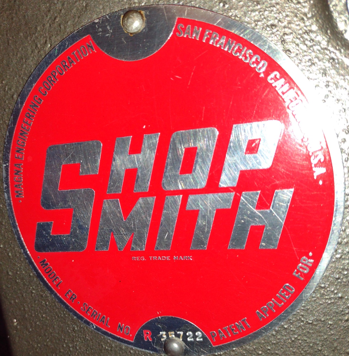

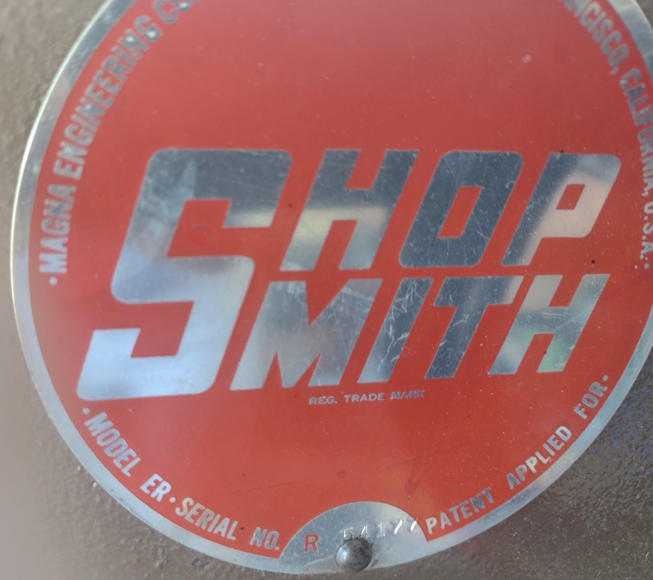

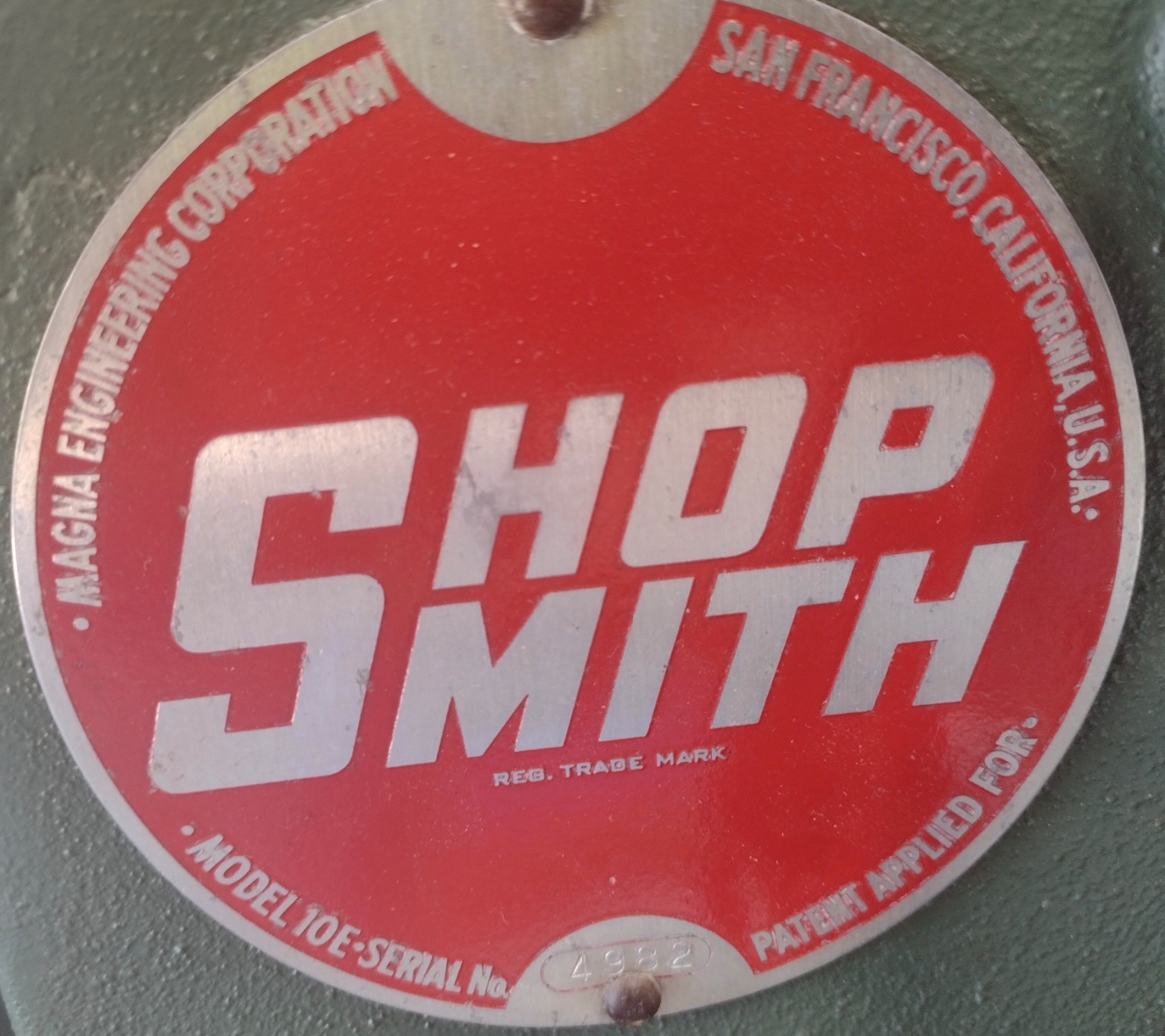

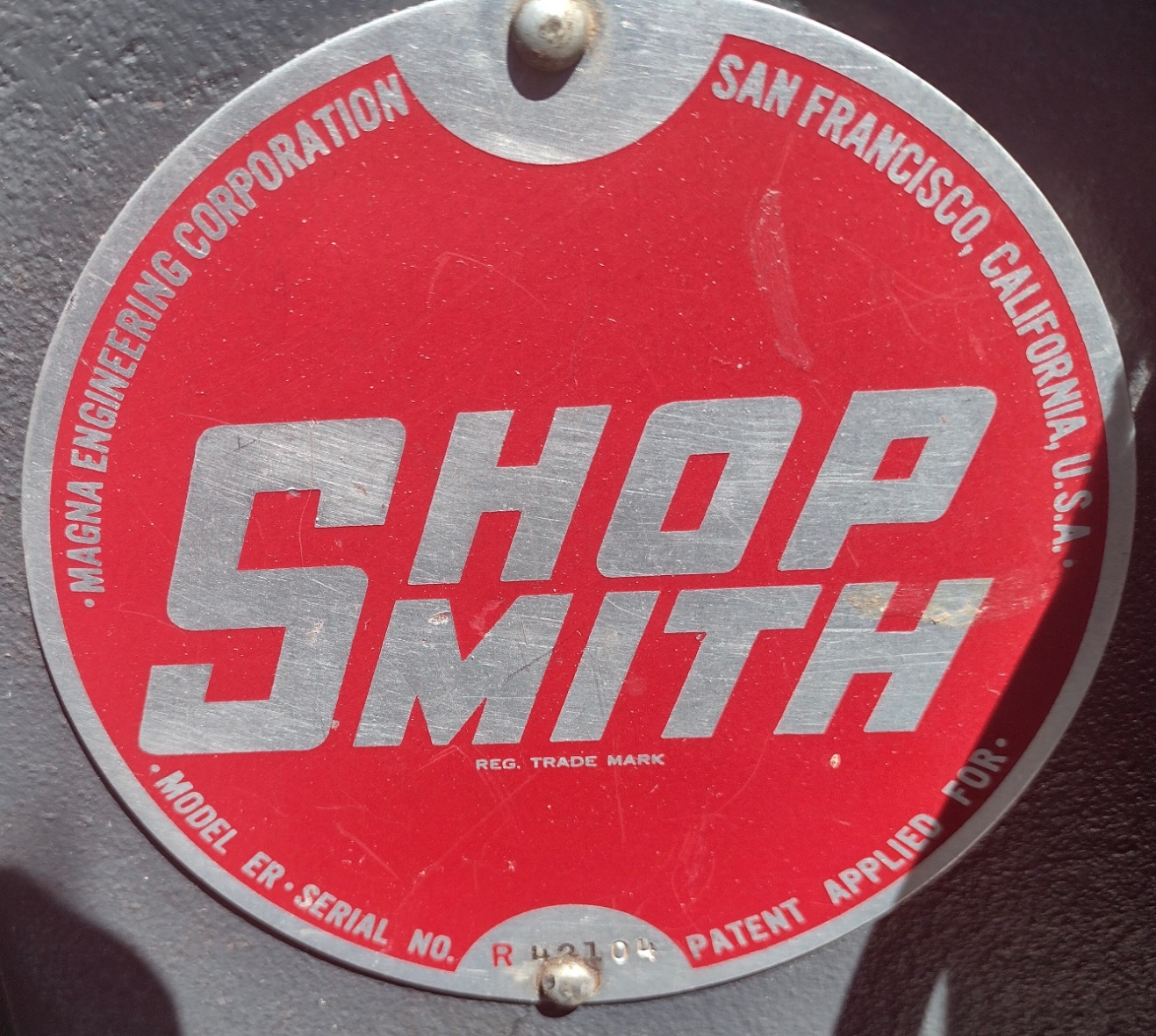

Any help with dating the following 4 machines would be much appreciated:
Posts: 4538
DarrenDD,
As you know it is hard to put specific date as to when a particular Model 10E or 10ER was made. There are some things we do know such as the first 250 Model 10E Shopsmith's were finished and shipped out to the West Coast Montgomery Ward catalog stores in November 1947 starting with serial number 1001. We also know the date the Model 10ER Headstock changed to version 6 and the Carriage changed to version 2 both going to the single wedge locks in April 1951. The serial numbers at that change were R53198 for the Western Plant and ER40908 for the Eastern Plant.
As for your four serial numbers here is a best guess
10E 4982 Likely the beginning of 1948 (there had already been changes to the Model 10E by this time. Headstock, Spring Housing & Tailstock version 2)
10ER R35722 Likely mid 1950
10ER R42104 Likely late 1950
10ER R54177 Shortly after April 1951
For those looking at DarrenDD's post above and wondering why I listed the 3 Model's as 10ER instead of ER as they say on the plate is they are actually a 10ER but the plate change from 10E to 10ER only said ER. That was later changed with a different plate design.
