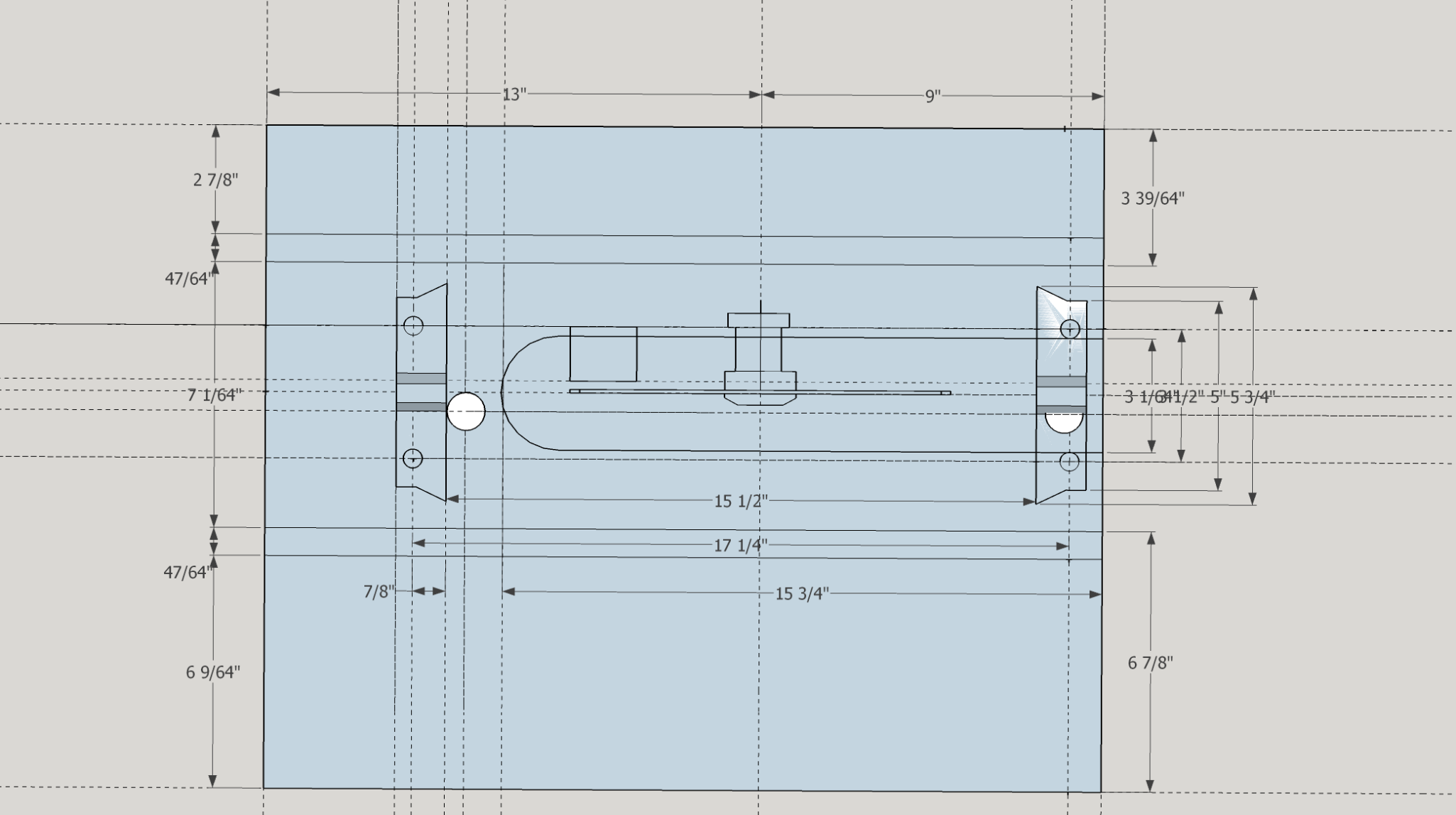

Table alignment to the blade should be almost a "don't care" proposition.
The way the Table Bar and Tube, the Trunnions and the Table stack up together, proper positioning is almost automatic. With trunnions that have NOT been redrilled, if you simply push the table (loose trunnion bolts) as far as it will go to the right (operators perspective), you will find that the blade is position very, very close to center in the cutout. Secure the trunnion bolts and the table is nearly good to go.
The deviation from machine to machine will be in hole size and actual positioning.
I think this drawing shows what I am alluding to (precision machined holes would eliminate the need for table to blade alignment (on a properly assembled and undamaged machine).
A Perspective on Trunnion Holes and Bolts.png (167.41 KiB) Viewed 6399 times
The carriage would be pushed against the headstock with the rubber bumper controlling position. This png does not detail the carriage. You need to trust the positioning of the arbor and blade. They are not arbitrary.

dusty wrote:Table alignment to the blade should be almost a "don't care" proposition.
Dusty that is a great post .
The drawing lines are all square and perpendicular , if you sent that to a machine shop the product you get back should be identical , square and all lines perpendicular .
If not send it back , find a shop that can do it right and get one that is done right .
You would be able to bump the table to the blade and it should true every thing at one time as long as the blade doesnt wobble . JM.02

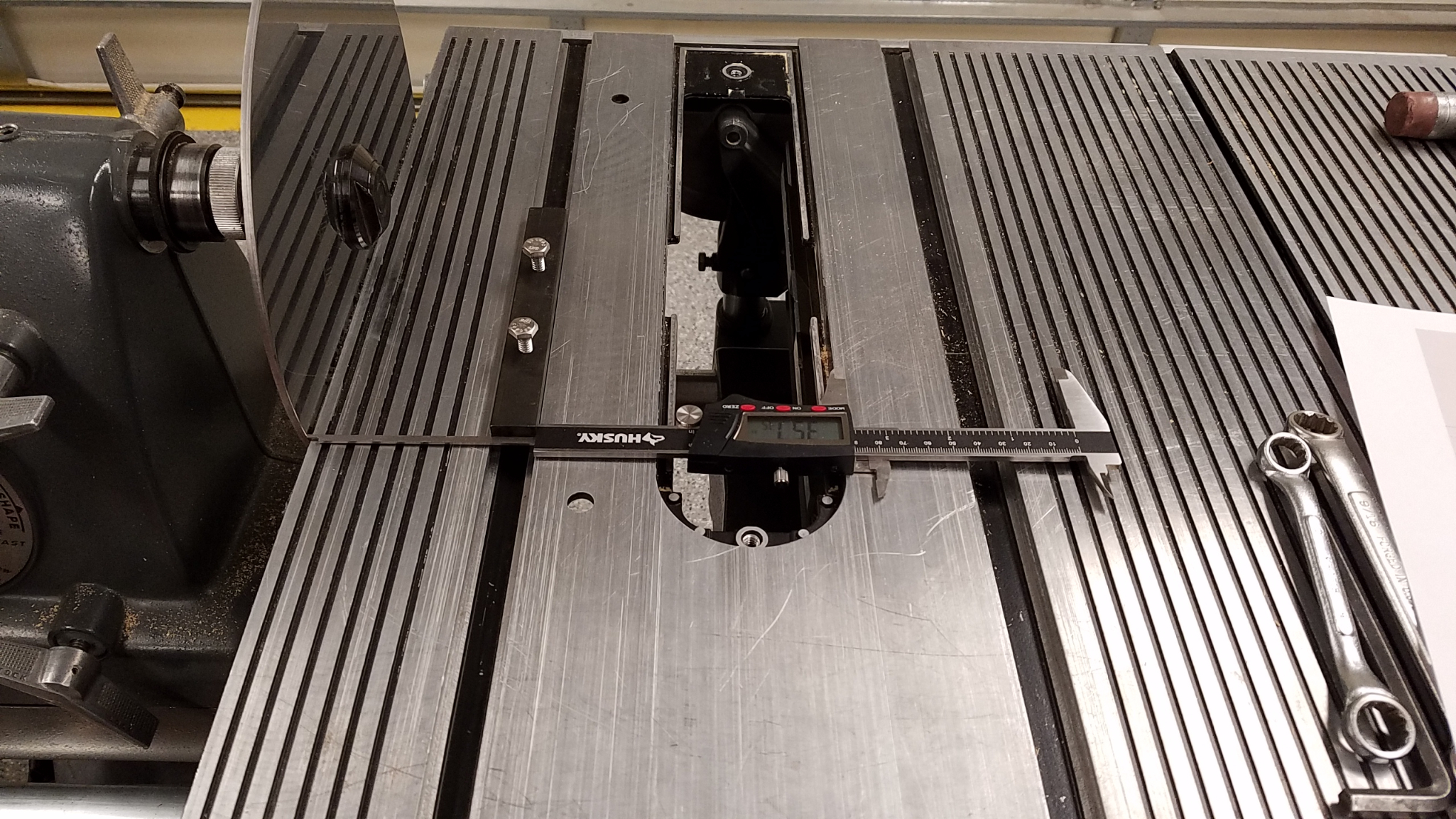

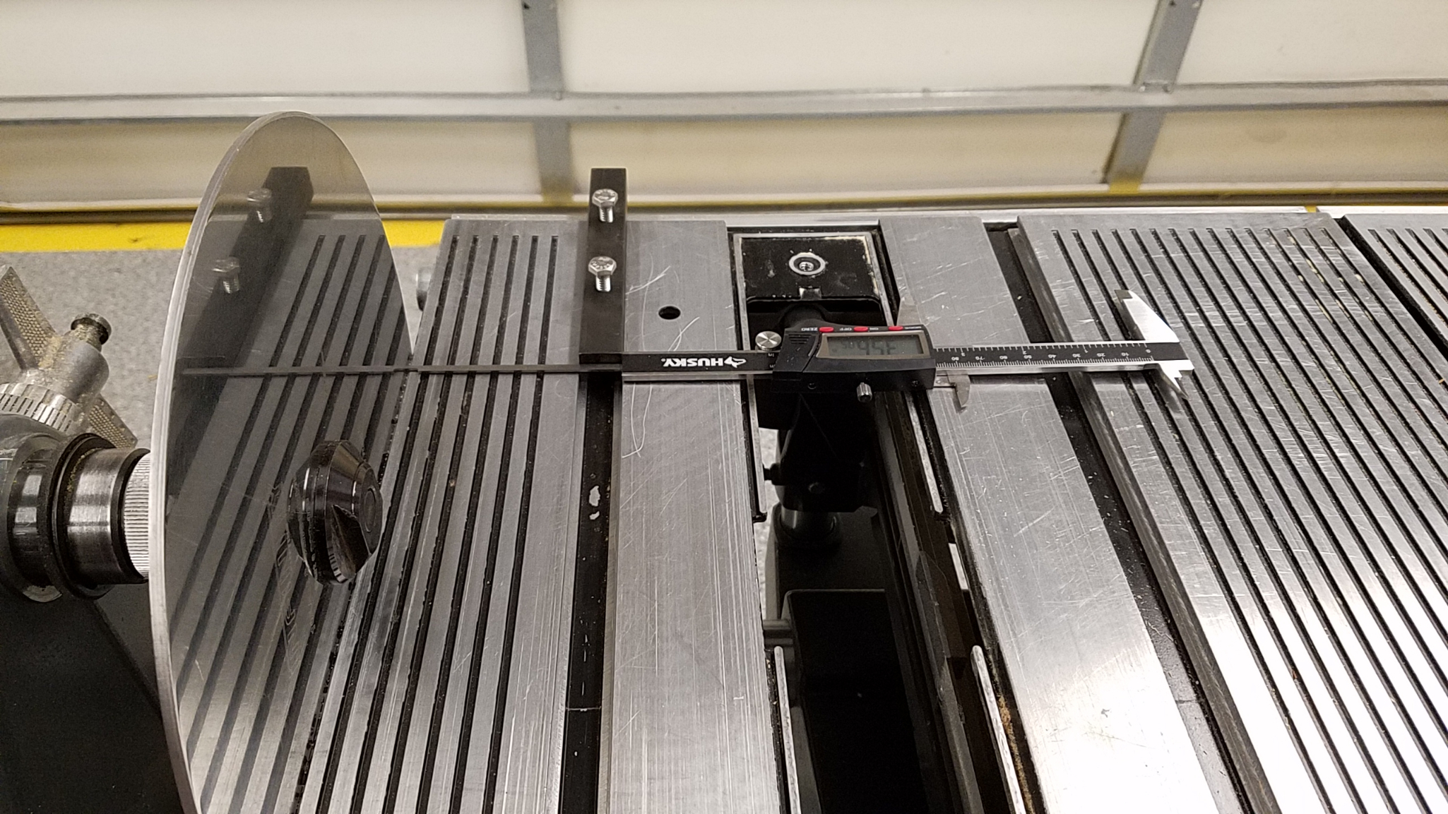

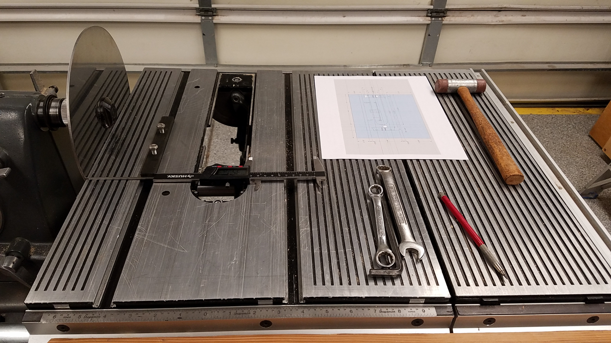

This was done with the intentions of it being "proof of concept",
I took measurements from the right side of the miter slot to the right face of the alignment disk - at both the infeed side and the outfeed side.
The readings were 3.57" and 3.563". The sketch that I posted earlier would tell you that the anticipated reading would be 3.609". This difference of .039" I believe is because those measurements are from possibly a different table and one that I considered perfectly aligned (had been tweaked).
There was no tweaking involved. I simply moved the table as far to the right as the trunnion bolts allowed. In fact, in these photos the bolts are still loose.
