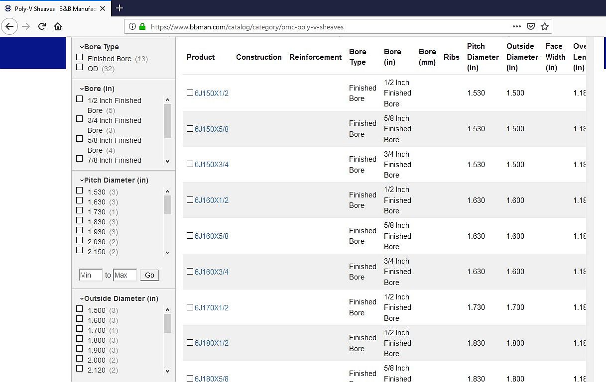

For those who might wish to measure poly-v pulley diameters, note that the pitch(effective) diameter is consistently 0.030" greater than the actual OD. I believe that dimension only applies to "J" section belt pulleys. That 0.030" is the same all the way through the entire chart for all diameters.
poly v pulleys.jpg (108.31 KiB) Viewed 8147 times
Re: powerpro some rpm numbers
So this simply means that the raw measurements taken on the poly-v pulleys must be corrected before calculations can be made.
Does that "fix it"?
