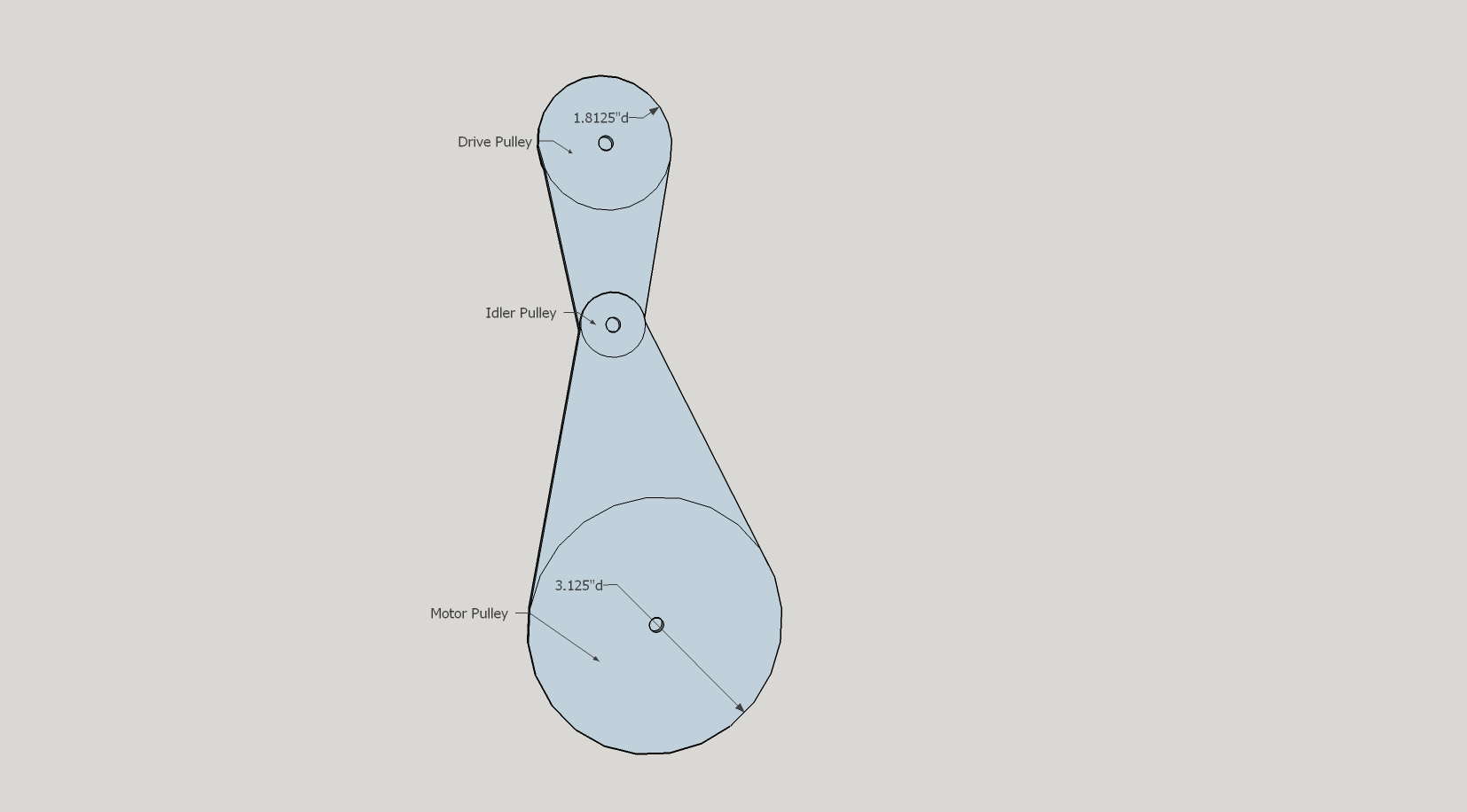

In one of my earlier posts I measured the motor pulley at 3,125 inches and the drive sleeve pulley at 2 inches which yielded a ratio .64 to one. So 10,000 RPM spindle speed would mean a motor speed of 6400 RPM. Which is very consistent with your results.

961 / 600 = 1.60 rpm main/motor
3.125 / 2 = 1.56 size motor/main
Both are reasonably coincident.
NOTE: these results are NOT to be confused with the main/idler shaft ratio of 1.6.
The motor - idler shaft ratio is about 2.56.
3.125 / 2.56 = 1.22 idler pulley size
1.22 x 1.6 = 1.95 close to 2"

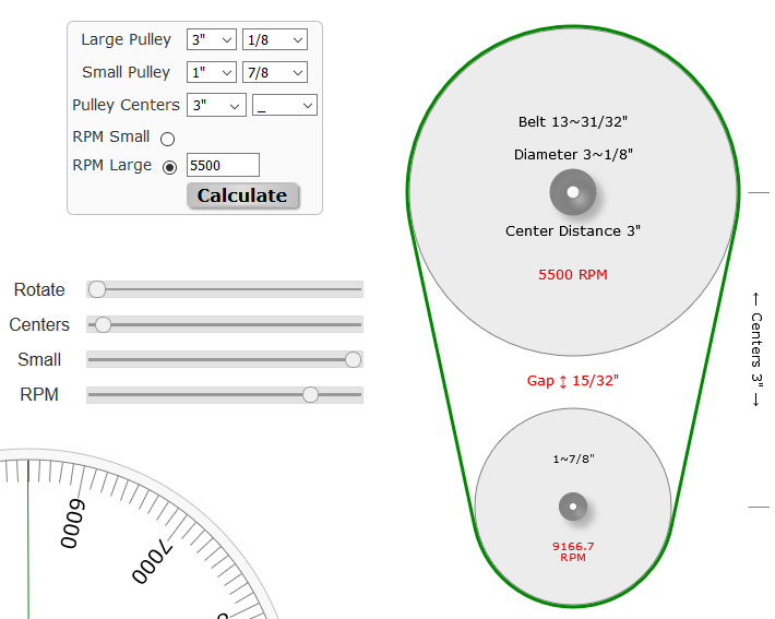

With what facts we are assuming, the numbers do not add up.wa2crk wrote:Set for 10,000RPM and measured 9523
Set for 1000 RPM and measured 961 RPM
Seems very linear to me.
I don,t think that actual speed is all that important for the majority of stuff we do as woodworkers, but the linearity of the measurements is impressive.
Bill V
Motor pulley diameter =3.125"
Drive Sheave pulley diameter = 1.8125"
Ratio 3.125/1.8125 = 1.724
Motor top "advertised" speed = 5500rpm
Max. spindle speed = 5500rpm x 1.724 = 9482 rpm
It is possible (maybe probable) that these differences can all be attributed to the fact that the critical neasurements are not all be taken the same way.
A tool that I found @ blocklayer.com/pulley
- Spindle Speed Calculator.PNG (53.07 KiB) Viewed 10559 times

We are dealing with poly-v pulleys. Each pulley has a root diameter, an outer diameter and an effective diameter.
The effective diameter is somewhere between the other two.* It is the offset from the other two that will be the same on all sizes, but will NOT change with the diameters that we measure.
So the effective ratio of a 1" and a 3" poly-v pulley will not be 1:3.
As an example, assume the offset is 0.1". The effective diameters become 0.9 and 2.9 and the effective ratio becomes 0.9 : 2.95 = 3.11.
We can chase around with the measurements of the pulleys until the cows come home. I for one pay more attention to the measured speeds that Ed did. I also think the 1.6:1 ration of the idler shaft:quill shaft is set in granite.
Using that I derived the 2.56 ratio of motor to idler speed.
Research has revealed that the effective diameter is slightly greater than the OD.
