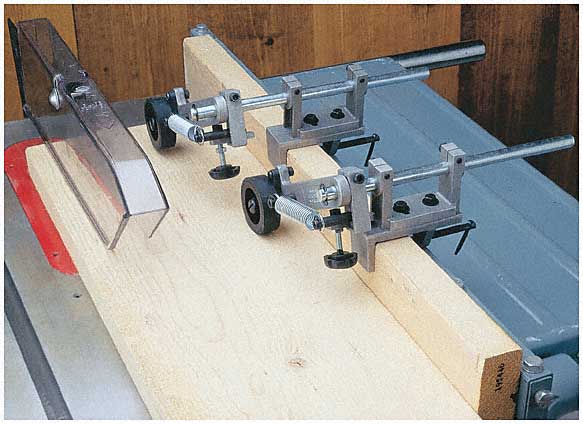

Thanks, Mike. I thought about doing this, but hadn't tried it yet. From your picture it looks like it works well. It does overhang in the pic, so any stock would have to be shorter than the fence height. Of course, I guess you could use the other T-track to fix this.Mike907 wrote:I took the guides off the Jessem rail and mount them directly to the 520 fence with T-bolts.

Excellent! Thanks Dennis. I’ve got the stock guides bookmarked for my next order.BuckeyeDennis wrote:
Although I mounted the router guides directly to the side T-slot on the 520 fence here, it would be easy enough to make up a more versatile mount. A board that mounts flat to the top of the 520 fence, via transverse T-slots, would just about do it. Maybe with a T-track attached to the blade side for the router guides, if you want to be able to change the guide spacing, or if you just don’t want to fiddle with changing the bolts when you move the router guides from one machine to the other.
Jessem pretty much had to design all that nice adjustable bracketry for their tablesaw guides, as it is intended for typical cabinet-saw fences that don’t have any built-in jig-mounting features. But the T-slots already designed into 510 and 520 fences give you a much more versatile starting point.
BTW, I replaced the standard hex-head bolts from Jessem with proper T-bolts from Woodcraft, and I like them a lot better. Now I can use an Allen key to really lock down the knurled clamp knob, without damaging the T-slot on my router fence.

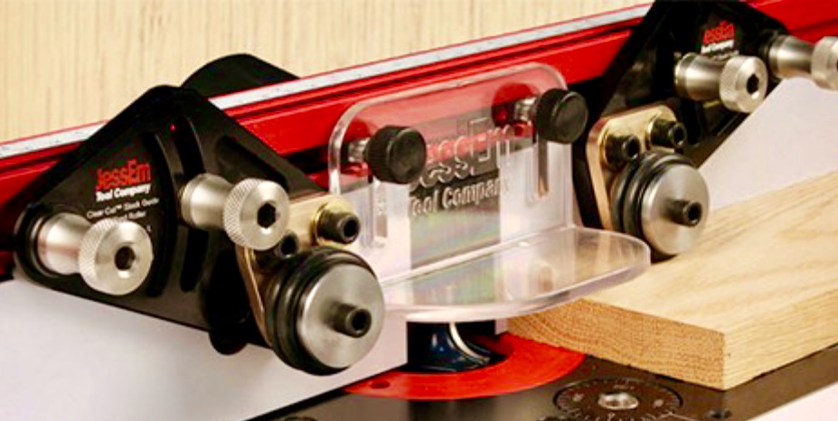

I have also have the Jessem guides for my router table and have considered using them on my SS. I have the big yellow wheels for it but also considered getting the Jessem TS stock guides. While looking around the web I found a similar setup on Woodworker's Supply. Has anyone tried their Anti-Kickback Hold Down Guide System? With their ability to clamp to an auxiliary fence, you could cut thicker stock.
https://woodworker.com/anti-kickback-ho ... -96974.asp

I have been using the Jessum system for years and love it. It's a very versatile setup and definitely adds a level of safety. I use it on the Incra fence on the big saw and the Incra on the SS. Jessum makes mounting brackets for the Incra so it a very easy mount.

I too have the JessEm Router Table guides and the maximum stock they show is 13/16 which works for 3/4 cabinet stock just fine on router table.
I too wondered about using them dual purpose in the table saw fence but never tried. Thanks for sharing how you did yours.
The Router version was about $100 and the Table Saw version over twice that at $250. No question they work well on Router and it’s nice to know you adapted them to Shopsmith fence with T-slot adapters.
I was thinking a 556420 Rip Fence Extension would allow one to get beyond that 13/16 limit.

I am considering a purchase of the table saw version of these stock guides and have a question for those of you that have used them...
If the distance from the fence to the blade is small (2" to 3" ??), do the guides get in the way of pushing the stock all the way through the cut?
Re: Jessem Clear-Cut TS™ Stock Guides on Shopsmith 520 Fence
I am not where I can check at the moment but if I recall 3" is ok. 2" probably not. They are a snap to move them out of the way when needed though. I have had them for several years along with the router table version and have not regretted the purchase for a second.
