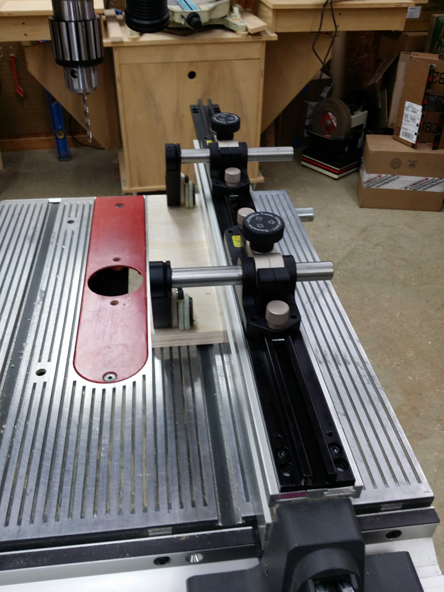

I installed the Jessem Clear-Cut guides on my Shopsmith 520 fence this morning and did a test run. It worked great on ripping some 1 1/2" thick cherry that is 6' long. The rollers are canted at 5 degrees so they pull the board into the fence. Pics below are my preliminary mounting, but I need to revise it. The T-track from Jessem is an almost perfect match for mating to the centers of the T-track on the Shopsmith 520 fence. I used Shopsmith p/n 514491 sliding t-nuts to secure the Jessem t-track. Unfortunately, to secure into both T-tracks (left and right) on the Shopsmith 520 fence, I will need to drill and tap some new holes in the 514491 sliding t-nuts. I will do that next, but very impressed with the initial test run for this and I believe this will make long ripping much safer. Pictures below for anyone interested.

Have them and love them! In fact I was using them yesterday.
I installed them just as shown in your picture using the shopsmith t-nuts on only the left track of the rip fence. I think you will find it unnecessary to add t-nuts to the right side.

algale wrote:Have them and love them! In fact I was using them yesterday.

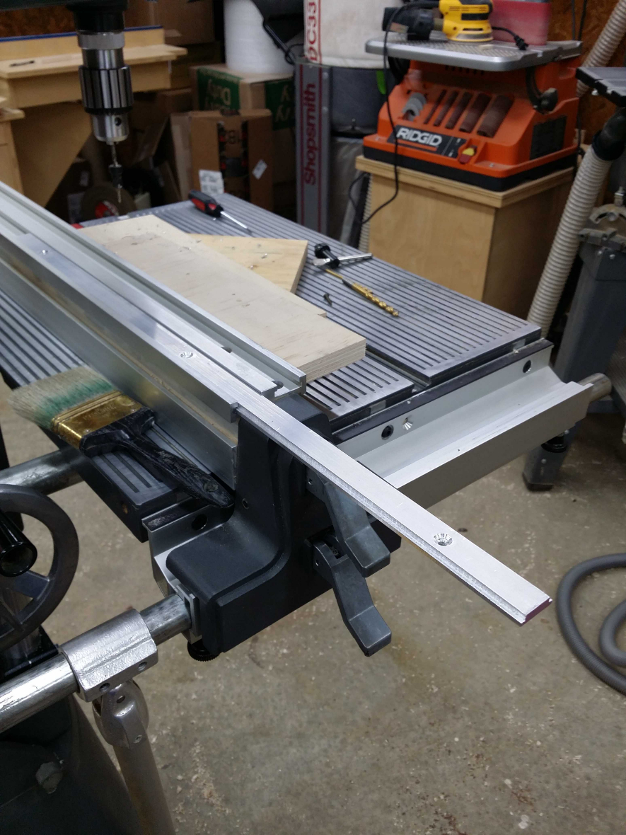

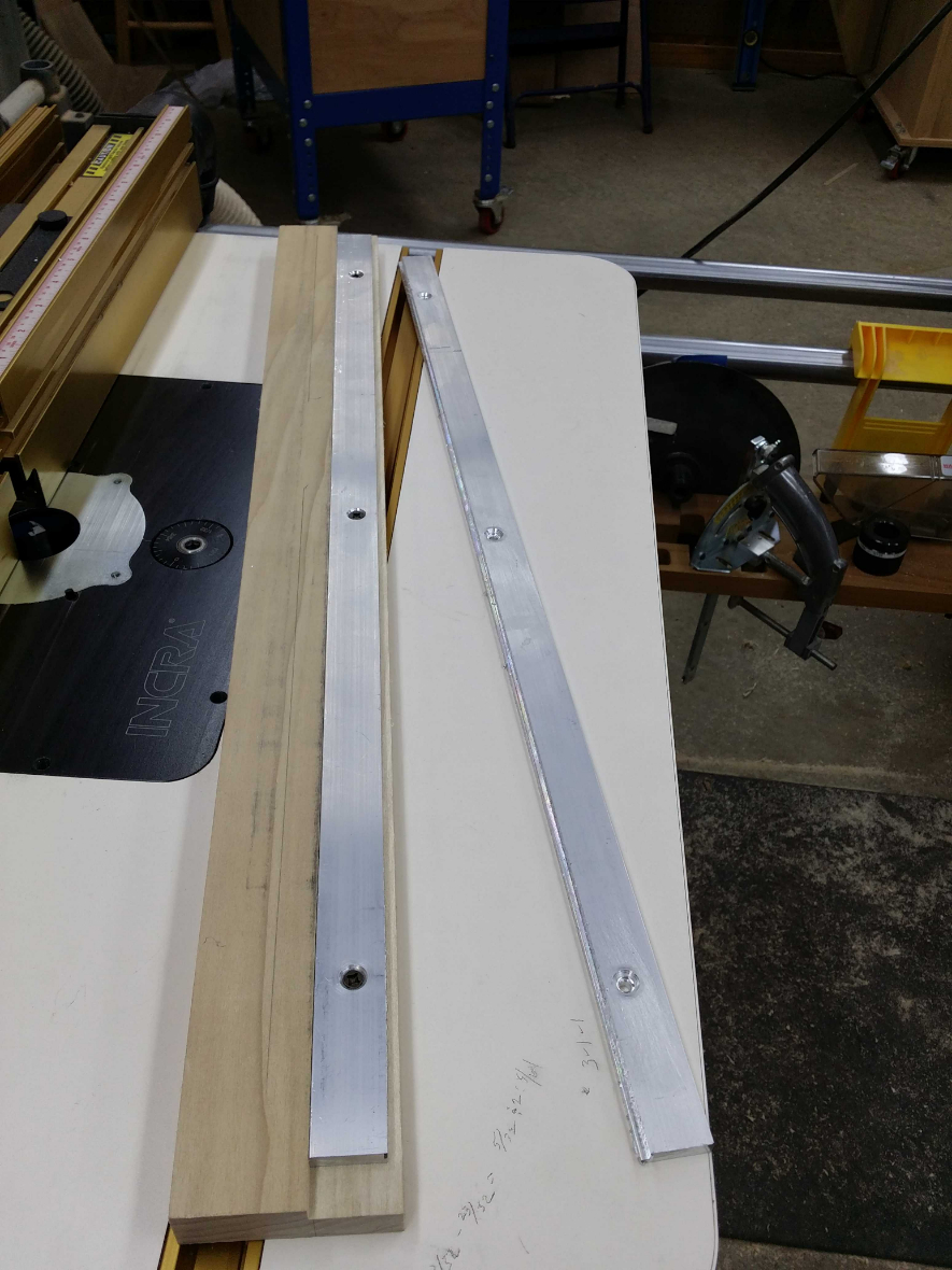

I made a mounting bracket from aluminum. I love the Jessem Guides! Two brackets one for each slot on the fence.
Jack

claimdude wrote:I made a mounting bracket from aluminum. I love the Jessem Guides! Two brackets one for each slot on the fence.
Jack
Nice idea using aluminum bar stock and routing it to mount in the Shopsmith T-track. Thanks for the suggestion.

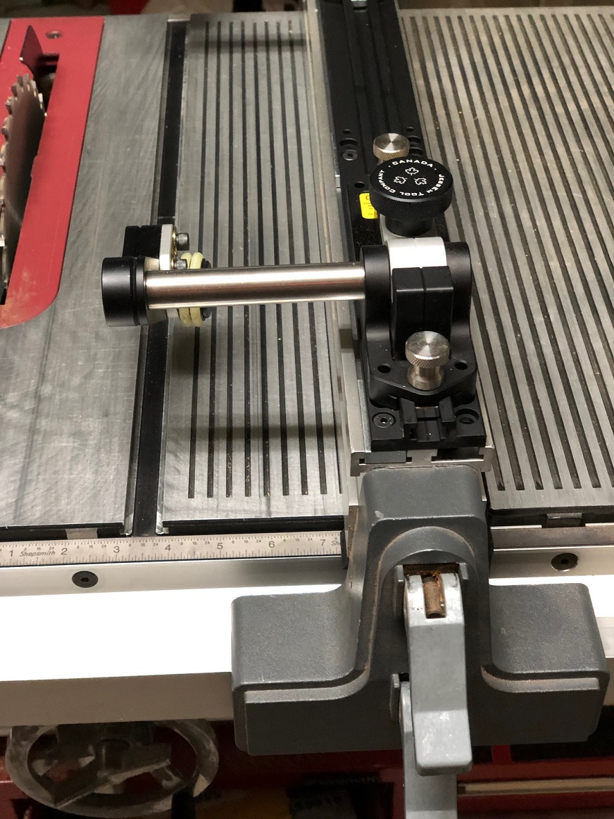

I took the guides off the Jessem rail and mount them directly to the 520 fence with T-bolts.
