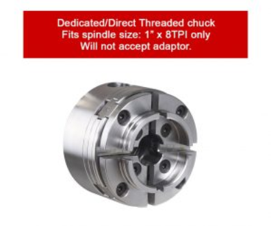

OK, I understand. I thought the G3 had a standard thread and then they made adapters for other sizes. It appears that is not true. I finally found it although not the standard G3 thread size which really does not matter.
So forget the "bargain". Sorry for the misinformation. I guess I put too much faith in Teknatool.

Do realize the thread size on their midi lathe is 1 -8.jsburger wrote:OK, I understand. I thought the G3 had a standard thread and then they made adapters for other sizes. It appears that is not true. I finally found it although not the standard G3 thread size which really does not matter.

Well no luck finding my post, but I know it is here somewhere. I did find references to 1-1/2 8tpi so it could be that is is. They sell lathes with several size spindles and depending on which country you are in you will get different ones.
Also note that they sell chucks that are designed for inserts and some that aren't. So while shopping you have to look close at what you are wanting vs what they have on sale.
I have thread gauges so if it ever warms up I can measure the pitch and it should be pretty clear if it is imperial or not.
