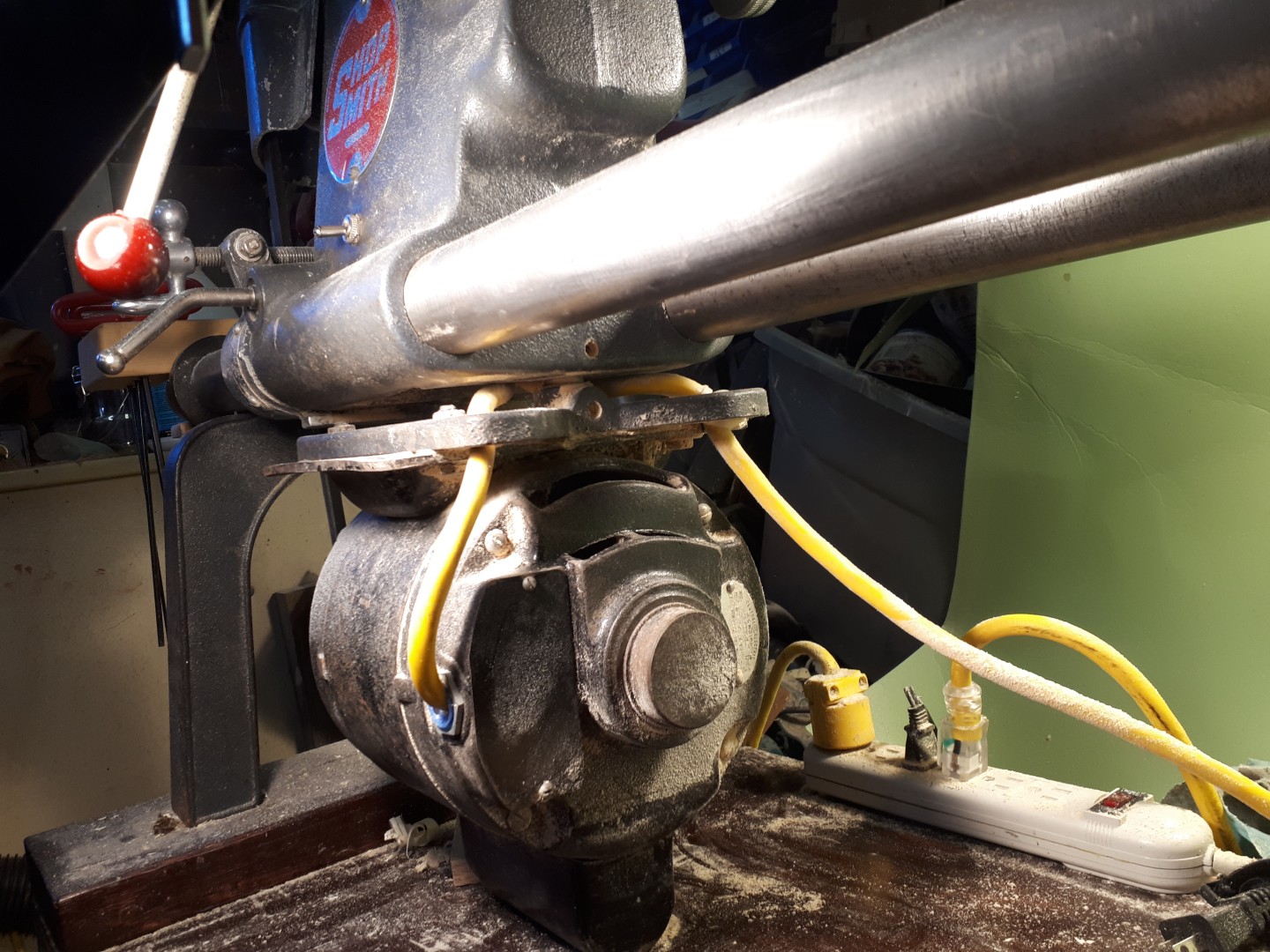

Similar to what John did, I ran my wires through the slots on the motor mounting plate and attached with a zip tie to provide strain relief.

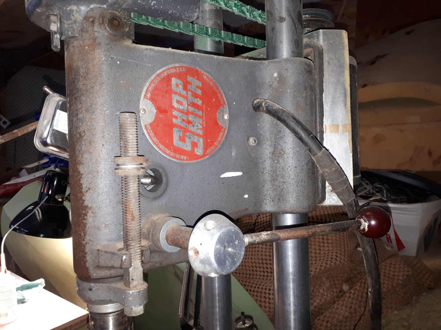

Of interest is the wire routing on my 10ER dedicated drill press. This is the one with the second logo plate on the back side, believed to be a demonstrator unit. The wire comes in through a hole in the back of the casting, The hole was made before it was painted so presumably done at the factory. Also there is a small nut and machine screw, can't remember if that is for the ground or if it is a strain relief.
I think the next time I rewire one, I will run a long wire to an outlet block (four outlets) on the bench, and just a short wire from the headstock that will plug into that receptacle. That will make it convenient to unplug when doing changeovers and also give a place to plug in lights and small power tools.

Seems simple enough.rpd wrote:Similar to what John did, I ran my wires through the slots on the motor mounting plate and attached with a zip tie to provide strain relief.
