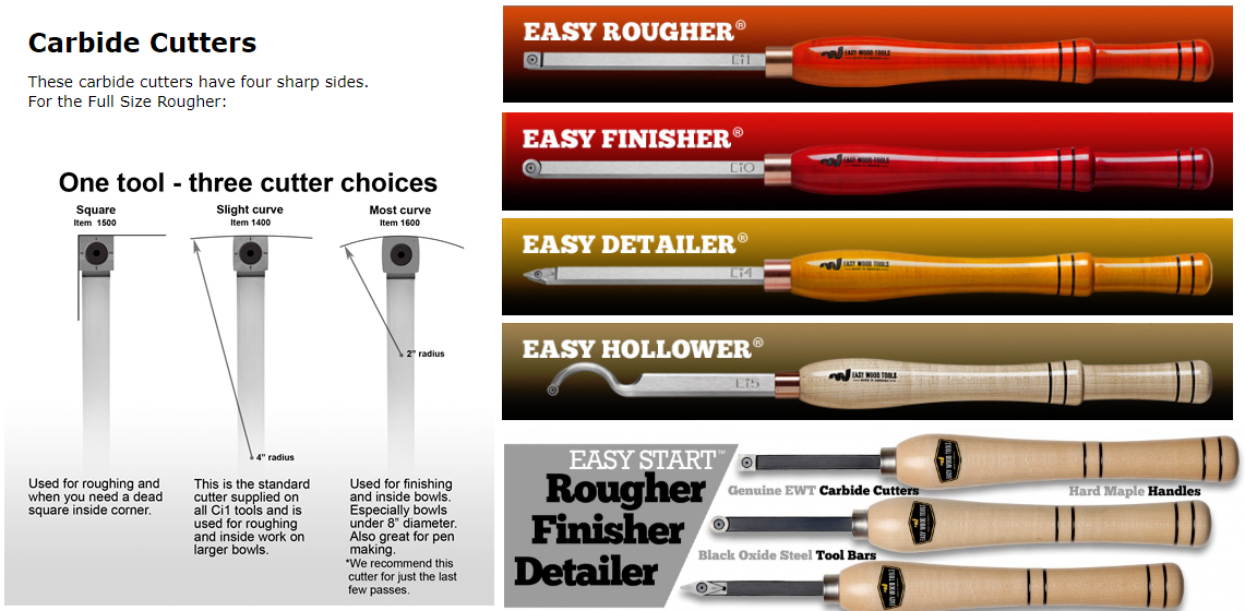

I like EasyWood Tools chisels, which have carbide replacement tips.
I don’t sharpen any more, I just turn the tip on the 4 sides til I use the last one, then screw in a new one and keep turning.
They also have a YouTube Channel https://www.youtube.com/channel/UC_0WUw ... YFqdQFr_Yw
What does it cost in time and material to stop and sharpen one, or have several sharpened chisels on hand and ready. I enjoy turning. I don't enjoy sharpening. The initial investment can be tailored to what you do.
I bought the roughing chisel first, then I was sold on them. They come in various lengths and configurations for different needs.
