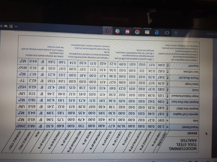

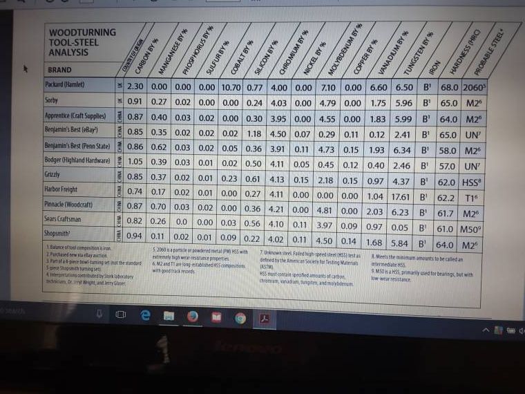

Boy,talk about a loaded question!!! There are a bunch of videos on You Tube about all aspects of turning. It would be almost impossible to tell you on this format how to sharpen tools. The American Association of Woodturners also has a large collection of videos some related to sharpening. The website is a membership site but does have a section for beginners. The sharpening system that I have settled on is the Rikon 1/2 HP grinder which comes with two of the white aluminum oxide wheels that are preferred to sharpen high speed steel tools. But, the SS tools that the company sold are not HSS but they are OK and will do an OK job. I also have the Wolverine tool sharpening guide from Oneway Manufacturing in Canada. That system works the best for me. If you are anything like me, you want to spend time turning not sharpening.
https://www.woodturner.org/default.aspx
Go slow at first. Try to find a turning group near you and get a mentor.
If you have any more questions just ask.

Thanks for the follow-up! Not sure why, but your attached photo is upside down.
