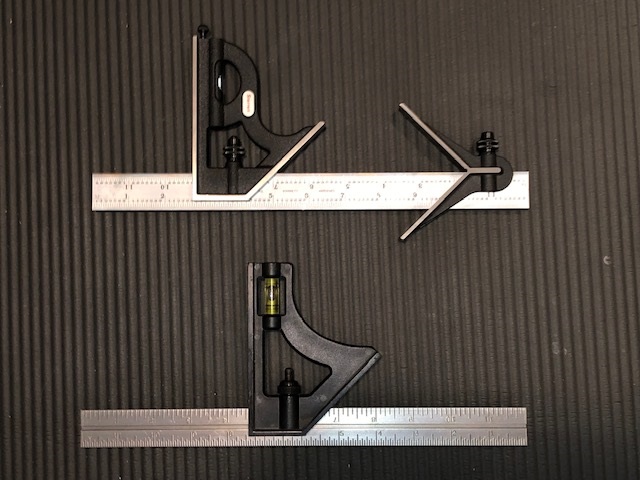

Well, my post on this thread certainly triggered a lot of feedback. I appreciate all of the responses and agree with a lot of what was said. I think though that the point I was making got lost here on this thread. The OP mentioned that he was setting blade height (depth of cut for a rabbet) using a combination square. While I love my combination square and have used it for several decades, I suspect the OP's choice to set blade height using a combo square "may" be causing some of his source of error in setting his blade height. I say this because of the difficulty in holding a combo square perfectly square to the table top in trying to set the blade height. Does anyone agree with me, or can you offer your tips for setting the blade height as precisely as you can to assist the OP? Do you use a straight ruler or a setup block of a known height? Please comment on what tool you use to set blade height.

I love combo squares so much that I own two of them. One is an inexpensive one I picked up decades ago and I have used and abused it for years. A few years ago, I picked up a Starrett one. Between the two, if I expect precision, I would lean towards the Starrett. It is not that I don't trust the inexpensive one, but rather that the contrast of black hash marks against a stainless ruler makes for a better contrast for my eyes to see and adjust to (sorry my picture doesn't do it justice). I have had good success in marking and layout on wood with these two combo squares, but I don't trust them for setting the blade height using the square part on it...simply because I don't trust myself to hold it perfectly orthogonal to the tablesaw. Now, I could use just the ruler part only (like any other ruler) and adjust the top sawblade tooth to it, or similarly use a block of wood of known dimension to do the same. If the OP isn't using his combo square like I described, then I apologize for this tangent on the thread.
P.S. The Starrett slides like a warm knife through butter, whereas the inexpensive combo square can be a little jerky in its movement when you adjust it. Just silky smooth to adjust the Starrett. Unfortunately it cost a pretty penny though...
