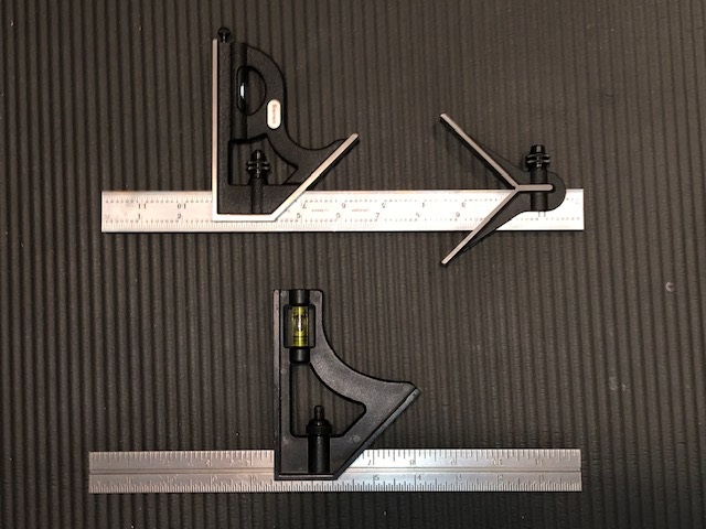

I love combo squares so much that I own two of them. One is an inexpensive one I picked up decades ago and I have used and abused it for years. A few years ago, I picked up a Starrett one. Between the two, if I expect precision, I would lean towards the Starrett. It is not that I don't trust the inexpensive one, but rather that the contrast of black hash marks against a stainless ruler makes for a better contrast for my eyes to see and adjust to (sorry my picture doesn't do it justice). I have had good success in marking and layout on wood with these two combo squares, but I don't trust them for setting the blade height using the square part on it...simply because I don't trust myself to hold it perfectly orthogonal to the tablesaw. Now, I could use just the ruler part only (like any other ruler) and adjust the top sawblade tooth to it, or similarly use a block of wood of known dimension to do the same. If the OP isn't using his combo square like I described, then I apologize for this tangent on the thread.
P.S. The Starrett slides like a warm knife through butter, whereas the inexpensive combo square can be a little jerky in its movement when you adjust it. Just silky smooth to adjust the Starrett. Unfortunately it cost a pretty penny though...
