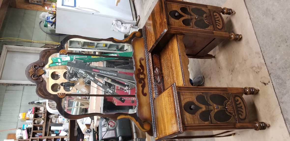

Restored to her former glory!

As to questions about how to remove the old stains in nooks and crannies, we use anything that works, we have small picks , like nutpicks , we have card scrapers and in some case's we make our own scrapers , I have flattened nails and sharpened the ends , just depends on what you need and what ya have available , small files ,what ever will work , I have had issues getting stripper from those nooks and crannies before ,so I shy away from i ton furniture with a natural finish , one suggestion I would give when it comes time to finish the project is to use a really good pre stain conditioner on the wood ,, then steel wool after every coat of finish .
if you use tong oil I would suggest using 1000 grit paper , when you use the tong oil you put it on using the sand paper , each coat increase the grit of the paper all the way to 2000 grit .like wet sanding a car ,, I think there are videos on youtube that describe this technique , it is much more durable and makes a good finish for antique tables . hope this helps .

BuckeyeDennis wrote:Restored to her former glory!
Thanks I dont think we could have matched the color any better , the mirror is all original finish.

I used the MKV for a couple replacement walnut brackets / strips that held the mirror to the vanity?? I used walnut instead of oak , it just looked more like it belonged and the walnut tree had to be close to the same age as the chestnut .

I love it when folks give an old thing a new life. (wish someone would do it for me :D ) Quite a few years ago my wife inherited some old furniture that dated back into the 20's from her grandmother. She was going to strip them and refinish them. I remembered that I had some stuff I think was called Bailey's Furniture Cream which consisted of an oil of unknown origin and some white cream that I think was a very fine polishing compound and some solvents. So, she used a white rag to apply some the stuff to the top of one of the pieces and the rag promptly turned black from the dirt she removed. The soil was a result of 70 years of using primitive oil burners for heating. Once the grunge was removed the furniture looked almost new.
So, a word to the wise. " try to clean old furniture before stripping it. You might be pleasantly surprised .

Hobbyman2 wrote:use of strippers depend on the situation ,I would try to save that for a paint removal , this one ,,sand paper,,, 220 grit and higher , along with card scrapers for the detail work ,then steel wool , strippers can be harsh and sand paper can leave marks . in this case after the wood conditioner is used it was stained again with American Chestnut to match the contrast of some of the grain , then a light steel wool and then we finished with a polly urethane ,,,since no one wants to wax their furniture any more,, , I would rather have finished it with shellac and wax , originally my best guess was it was a varnish or lacquer finish since it was done on a production line . also I like to mix and spray the finish using a gravity spray gun instead of a brush , the mirror was not touched in any way except several coats of paste wax to bring back its luster and amazing details . jmo
