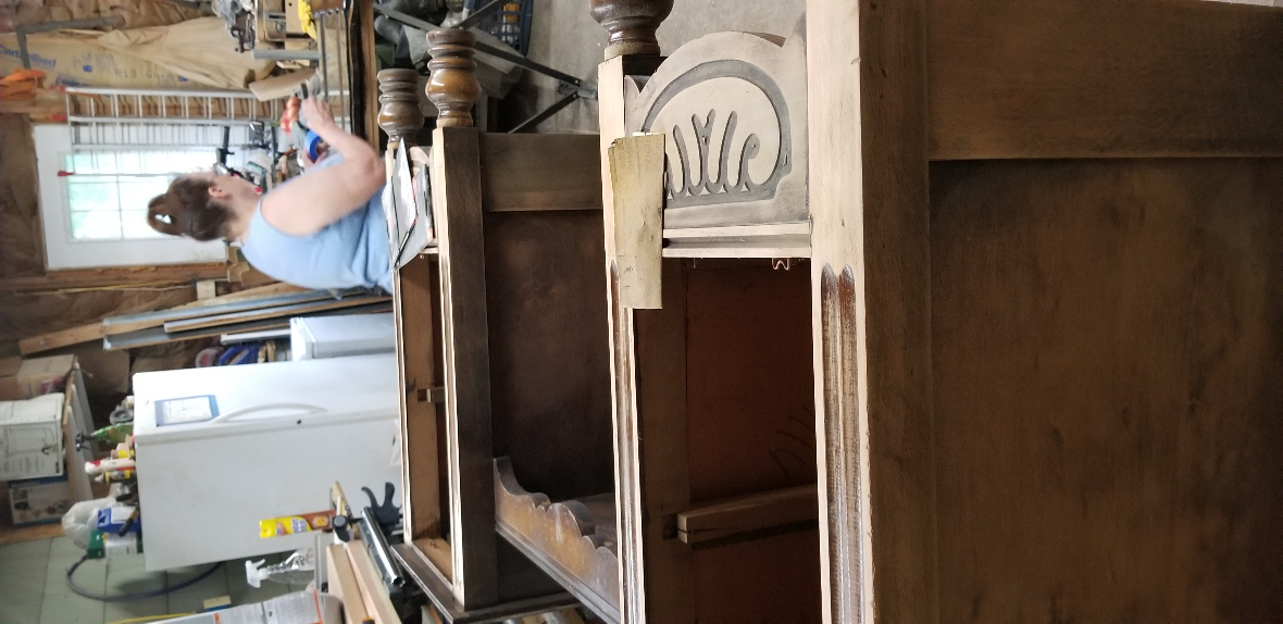

She is at it again
Post by Hobbyman2 »
Another family heirloom saved from the abyss

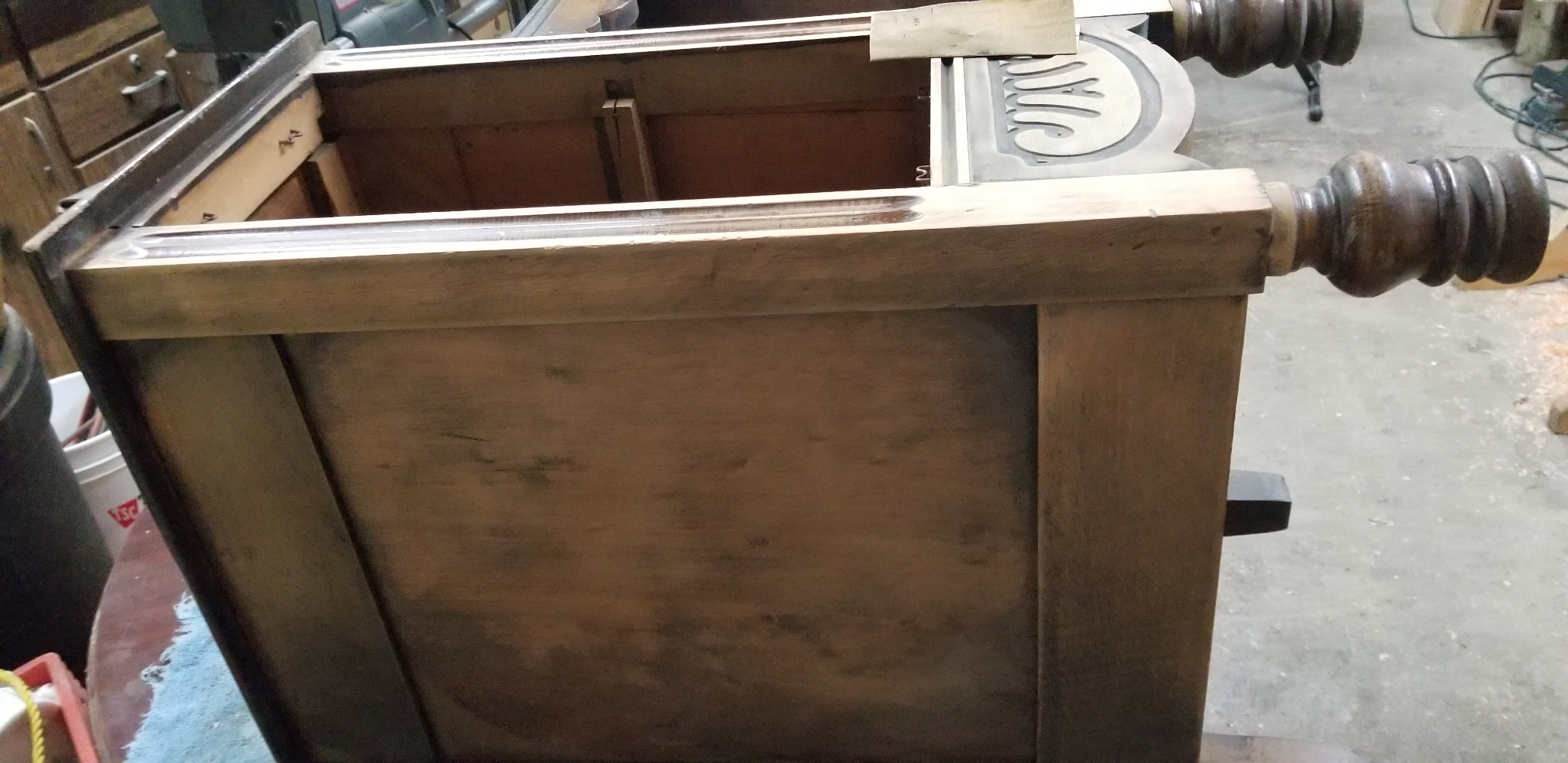

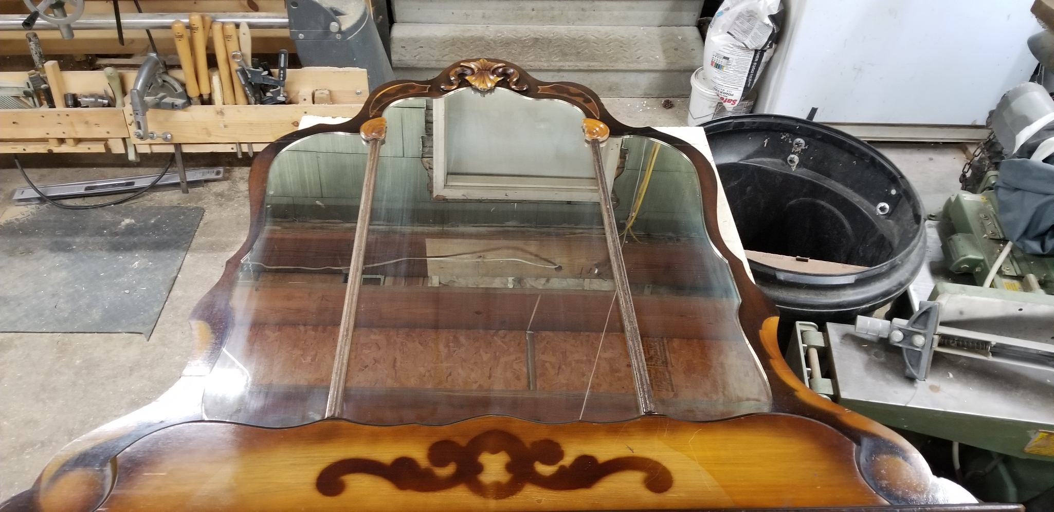

This is such a honor for us , this vanity was made by the Elkin Furniture co in Elkin NC , some time around the turn of last century ,,the only information I can find on line says they moved their original factory in 1907 the website has a picture of the building on loan from the in Surry county NC historical society , my guess is the piece is made of American Chestnut , My guess is the wood is well over 200 years old , what a honor to see some else's work from a century ago and to restore this thing in hopes it will last another 100 years . I cant begin to explain how fragile it feels , just received the new casters that are so close to being identical it is shocking . it had a couple lose glue joints{{assuming they were hide glue}} and the old wood casters were there but chipping away ,the stool still has the original material on it , we wont try to do anything to it until we can find matching material , I am afraid if we try to clean it it will just fall apart, the wood stool its self is in wonder full condition needing very little if any repairs We hated to take it down to bare wood but it did need it , we will sign and date our repairs and what small bit of information we have found to go with it . I have to say the quality is as good as anything that can be made today .

use of strippers depend on the situation ,I would try to save that for a paint removal , this one ,,sand paper,,, 220 grit and higher , along with card scrapers for the detail work ,then steel wool , strippers can be harsh and sand paper can leave marks . in this case after the wood conditioner is used it was stained again with American Chestnut to match the contrast of some of the grain , then a light steel wool and then we finished with a polly urethane ,,,since no one wants to wax their furniture any more,, , I would rather have finished it with shellac and wax , originally my best guess was it was a varnish or lacquer finish since it was done on a production line . also I like to mix and spray the finish using a gravity spray gun instead of a brush , the mirror was not touched in any way except several coats of paste wax to bring back its luster and amazing details . jmo

With out the mirror
