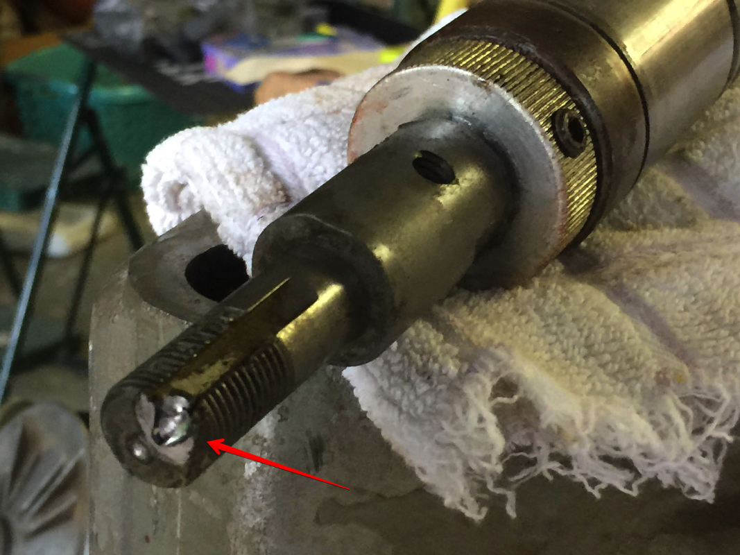

Yea, I was pretty upset with myself for being so dumb. I tried using my impact wrench to turn the bearing extractor with the thought that the impact motion might break lose whatever was holding that piece onto the shaft. But what happened instead, was that the end of the extractor screw marred the end of the shaft where the threads are. Here is a picture:
Looking at it this morning, it "might" be fixable with a bit of careful persuasion. I've seen antique tool restorers on YouTube fix far worse. But, of course, that is them not me. ;-)
One thought I had was that perhaps I could remove the shaft by pushing it out of the quill (am I using the right terms here?), but my recollection is that there is a snap ring or other retainer behind the knurled knob that has to be removed first. Am I correct about that?
Other thoughts, or ideas on how to proceed to either loosen up that piece or repair the damage I did?

Don't try to fix the adapter arbor. There are two flats for a wrench on the end of the adapter near the knurled nut Keep using the PB blaster or whatever you are using to dissolve the rust and put it through the hole and into the seam between the knurled nut and the collar of the adapter. With the splined end of the quill secured rock the adapter back and forth with the wrench on the flats until you get some movement. After you get movement keep working the adapter while applying pressure away from the knurled nut. It should start to move eventually.
In my opinion the adapter is toast. They come up on E-Bay but not often.
Yes there is a snap ring inside the quill housing behind the knurled nut but it is a standard hardware store item.

I'm having a hard time figuring out how you had the bearing extractor set up. You need to pull on that arbor, not push on it.
But then I realized that the arbor could serve nicely as its own jack screw. Can you still get a nut on those damaged arbor threads? If not, you could probably clean them up with a thread file.
You can cut a sleeve out of metal pipe to slip over the arbor, all the way down to the knurled collar. You'll need most of the arbor threads exposed when the sleeve is in position. Then slip a big heavy washer over the threaded end of the arbor, and thread on a hex nut. When you tighten the hex nut, all of the screw thrust will go through the washer, then the sleeve, then the knurled collar, then the inner race of the spindle bearing, and finally up against a solid shoulder on the spindle. You'll just have to restrain the splined end of the spindle so that the whole spindle doesn't rotate.
Unless whatever is binding the arbor to the spindle is stronger than the arbor threads, that setup should be able to break it free.
Edit: If you're lucky, you can find a pipe nipple that's already the right size to use for a jacking sleeve.
