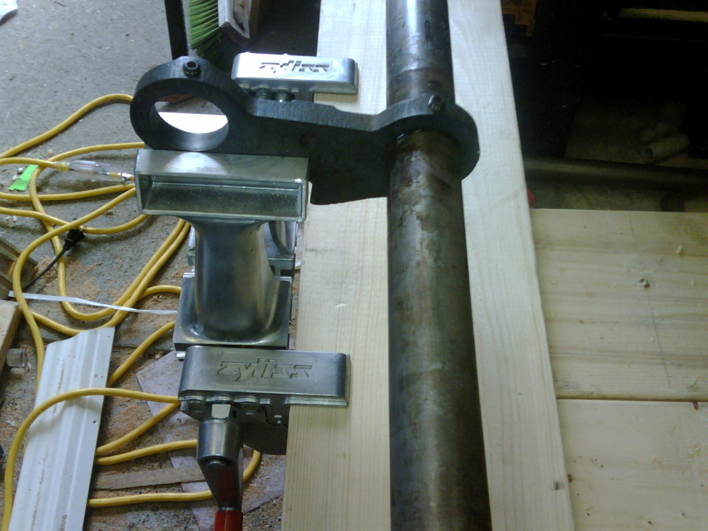

When I cleaned up my 10ER way tubes I used the tie bar to hold the outboard end.

rpd wrote:When I cleaned up my 10ER way tubes I used the tie bar to hold the outboard end.
Hey, that’s cheating!
But then, I do have a Zyliss vise ... :)
