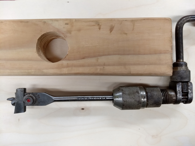

Plan D: Desperate times call for desperate measures. I have a cool old adjustable auger bit that came in a 10ER goody box. Sure 'nuff, it turned out that I can set it for 1-3/4". Next clean the sawdust off of my biggest antique brace, and give it a try. Wow -- that takes a lot of torque -- good thing the brace has a ratcheting mechanism. But with the workpiece held in my bench vise, the brace is up too high for me to add much down-force, and the screw pilot stripped out the wood after drilling maybe 1/4" inch deep. I could have rigged up some sort of lower-down workholding means, but the auger-bit cut was going to be more ragged than I wanted anyway.

Back to plan D. Could you mount the work piece in the vise so that you are boring horizontally. That way you get it at a comfortable height and use your leg muscles to provide the force (lean in)

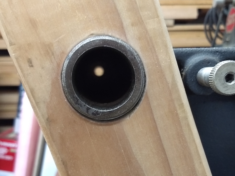

Ron, now I feel just plain dumb. I've even watched Roy Underhill use a bit & brace with that exact technique. So your suggestion gets the prize for most expeditious. I tried it after lunch, and now I understand why Roy was breathing hard! My hole came out a little rough, probably because the pilot auger is the only thing keeping that one-sided cutter on axis. After knocking down the ridges with a rasp, it was a mite oversize, but probably serviceable for my immediate application.

As you might surmise from the last photo, my immediate application is a quick and dirty bushing to support the outboard end of a 10ER way tube for surface-rust cleanup. I'll probably coat the inside of the bushing with beeswax, and then fasten it to my Mark V's aux table. I have a freeze plug that I could drive the tube with, but after seeing jsburgers setup a while back, I think I'll drive it with in my Nova chuck like he did.

I've got that same bit and a similar brace and used it many years ago to size some holes for the way tubes. I found that I had the best success if I clamped a sacrificial board behind the board I was boring (are you bored yet? :D ) so that the pilot had something to grip all way thru.
