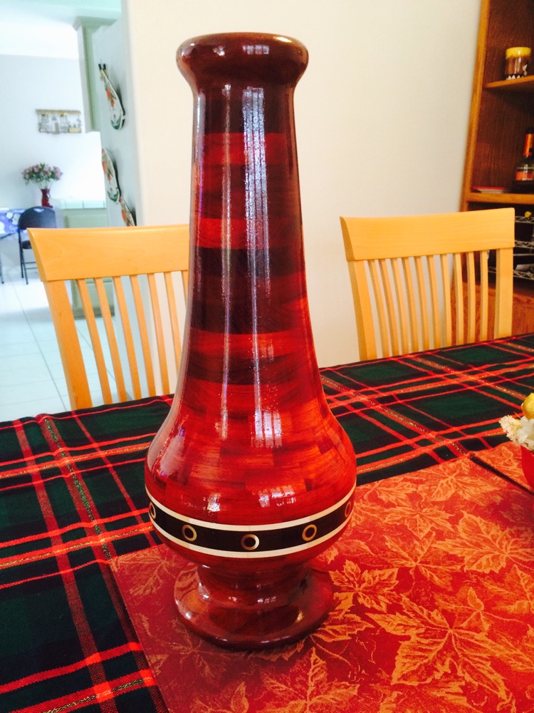

Thanks for the compliment Al. As usual it came out of necessity. At the time I was turning a lot of paduak which has really nasty dust so I had to come up with a way to sand the rings with minimal dust. The other problem I was having was consistency in the thickness. I was doing a really tall paduak turning and the thickness inconsistencies were driving me bats. I finally figured out I needed to be able to easily flip the rings and move them side to side as they were being sanded which gave me rings at the .01” accuracy level.

Absolutely beautiful piece! What material are the "O"s?

They are brass
