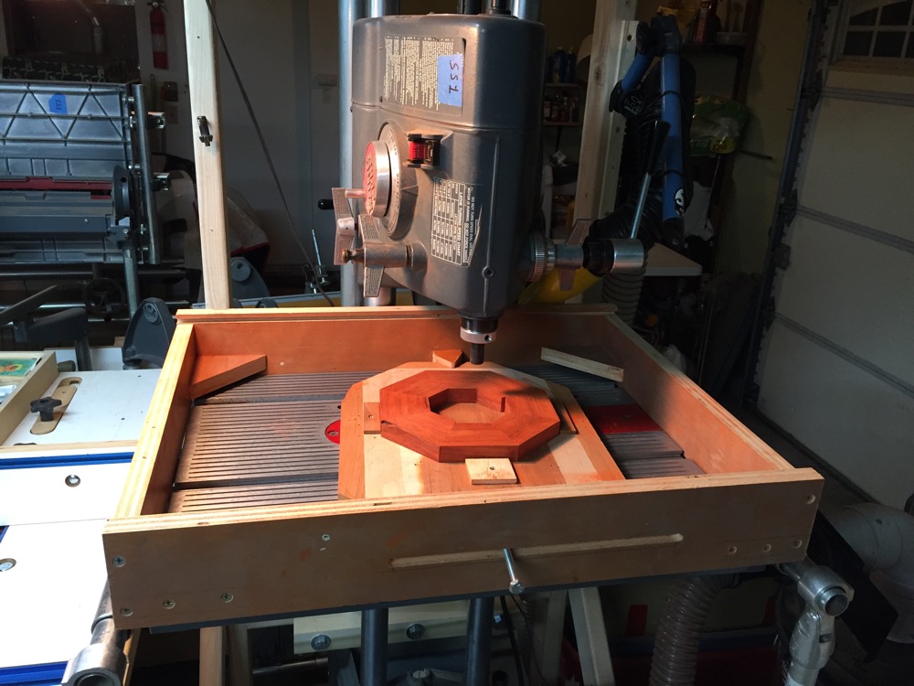

Here is one I have been using for a few years and it works very well. This one allows you to move the ring back and forth under the sanding disc while it is sanding. I also rotate each ring on the platter at least twice during sanding which tends to minimize any inconsistencies that can occur due to the sanding disc or misalignment of the table. Another trick is to use an 80 grit disc. It will give you a ring that has less variances in it. There is a two part dust hood that is not shown that fits on top with a dust port. Hope this helps. If you want better pics let me know.

Thats fantastic. I didnt think I was the only one ever to think of this. Yours looks much safer and that sanding shield would be a great addition..
