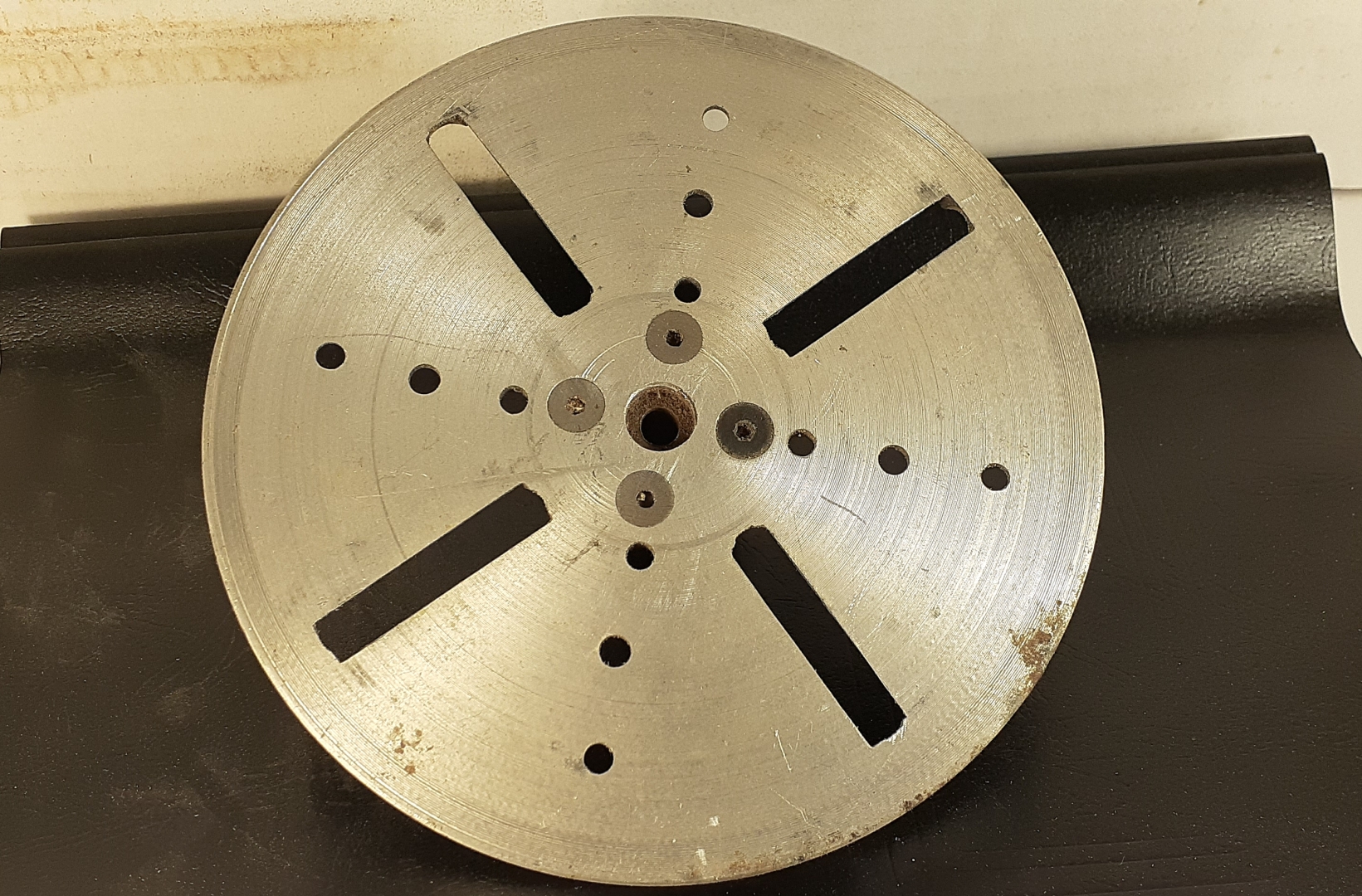

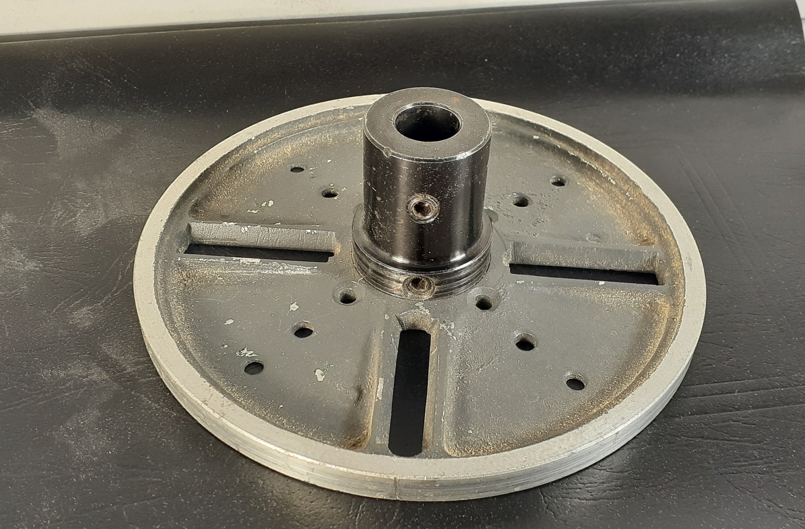

chapmanruss wrote:Going back to something you said in you original post.
I use a 6" face plate and the 4 screws are all tight.
Does this faceplate fit snugly on the Spindle before you tighten the set screw? Are the 4 screws all attaching the wood? I ask because all 6" Faceplates ever made by the companies making the Shopsmith Tool from the Model 10E to the Mark 7 today use sets of 3 screws to hold the wood being turned and have a single set screw as shown on the right for the 6" faceplate in the picture below. There is nothing wrong with using another brand faceplate as long as it fits properly.
I have this one, but I can't remember if it came with one of my Shopsmiths or if I got it from eBay, vintage unknown.
The arbor and the way it fastens to the aluminum face plate part look very like the way the steel sanding disk is made, so I am suspecting is is Shopsmith.

Posts: 4544
Re: lathe flexing
Ron,
The Faceplate you show in the pictures was not made for the Shopsmith tools by any of the companies (Magna's, Yuba, Shopsmith Inc.) that have made Shopsmiths over the years. All of them have been made out of either cast iron or aluminum in a one piece casting with a single set screw.
Re: lathe flexing
The faceplate shown looks just like one I got for my brother some years ago but it was not from shopsmith but some other company that I found online. It has been too long so I don't recall the name. BTW it was made very well and he has been very happy with it. It was also cheaper then the shopsmith version, well at least when I was shopping for it.

reible wrote:The faceplate shown looks just like one I got for my brother some years ago but it was not from shopsmith but some other company that I found online. It has been too long so I don't recall the name. BTW it was made very well and he has been very happy with it. It was also cheaper then the shopsmith version, well at least when I was shopping for it.
Thank you, that clarifies the matter. :)
Re: lathe flexing
Also the slots indicate to me intended use on a metal lathe. I think the bent arm that attached to round stock went through those holes and was called a dog.
