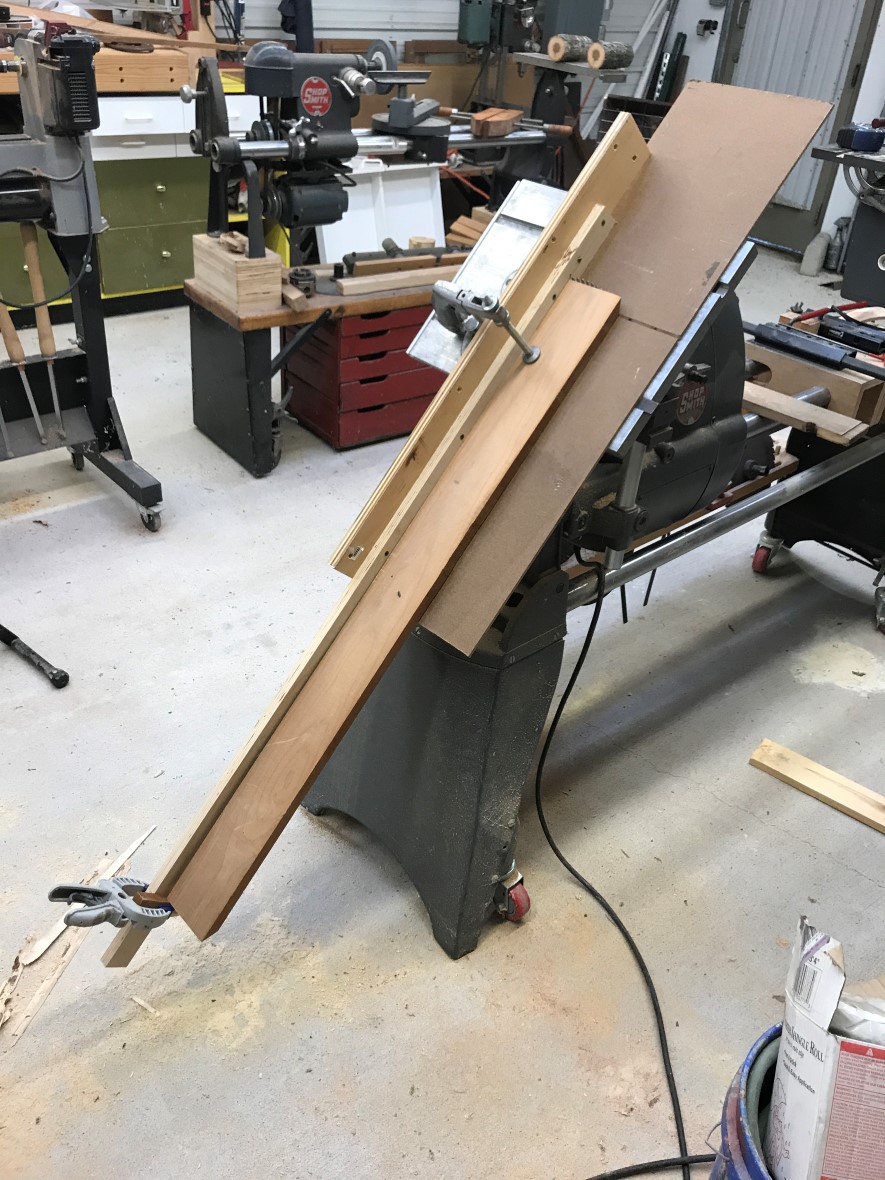

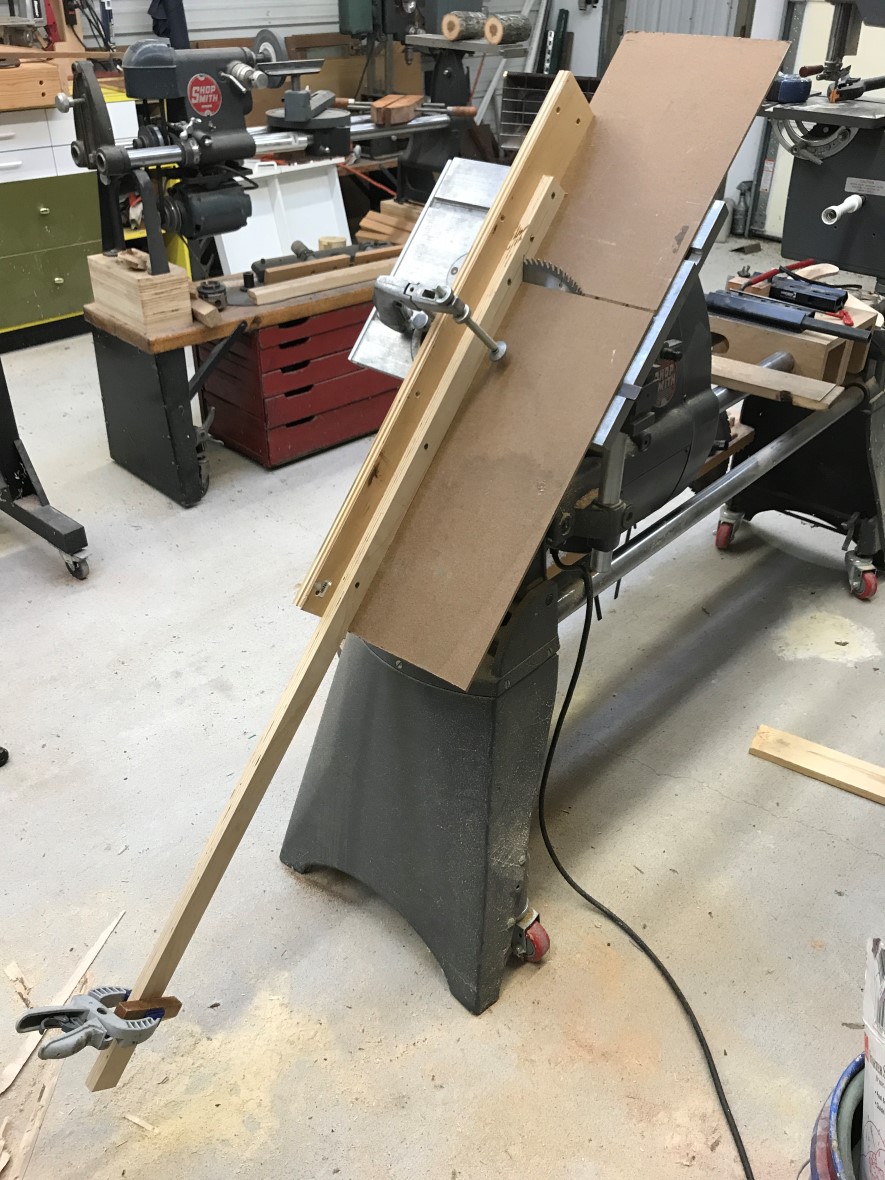

I like a small cross cut sled attached to my miter gauge. Easy on, easy off. I made this one longer than I usually do to help support the work piece the size Ed is talking about and give me something to hold down above the blade as it does want to tip a little. I used a 1/4" masonite base screwed to a 3/4 plywood scrap and added the small plywood strip for the stop. This piece is 45". I like the miter grip for helping hold things in place.
IMG_0751 (Custom).JPG (288.06 KiB) Viewed 12331 times
IMG_0753 (Custom).JPG (285.58 KiB) Viewed 12331 times

larryhrockisland wrote:I like a small cross cut sled attached to my miter gauge. Easy on, easy off. I made this one longer than I usually do to help support the work piece the size Ed is talking about and give me something to hold down above the blade as it does want to tip a little. I used a 1/4" masonite base screwed to a 3/4 plywood scrap and added the small plywood strip for the stop. This piece is 45". I like the miter grip for helping hold things in place.
$matches[2]
Very nice for the 500. BTW, a good looking Model 10 in the background.
Re: Cross-cutting multiple long pieces to the same length
A nice looking 10 on stilts! :cool:

larryhrockisland wrote:give me something to hold down above the blade as it does want to tip a little.
Larry - that is a really slick looking sled. I think I may have to build something like that. It really does extend the capacity of the table. Thanks for posting the pictures. It does seem like your sled provides support for the workpiece, sort of in the way that has been discussed of using the floating tables and extension tubes on the 510 and 520. I also like the way you can incorporate a fixed stop to get repeatable lengths.
I don't quite follow what you are saying in the quote I snipped. Are you saying you grip the miter gage with one hand and press the sled down with the other? Does that mean you are reaching across the blade during the cut?
