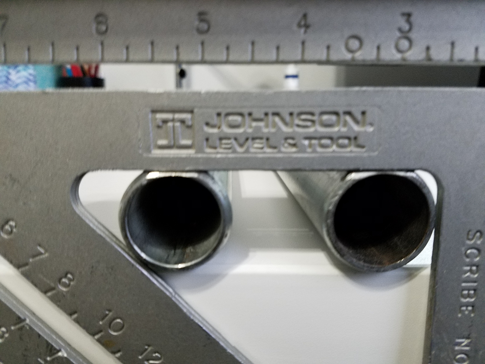

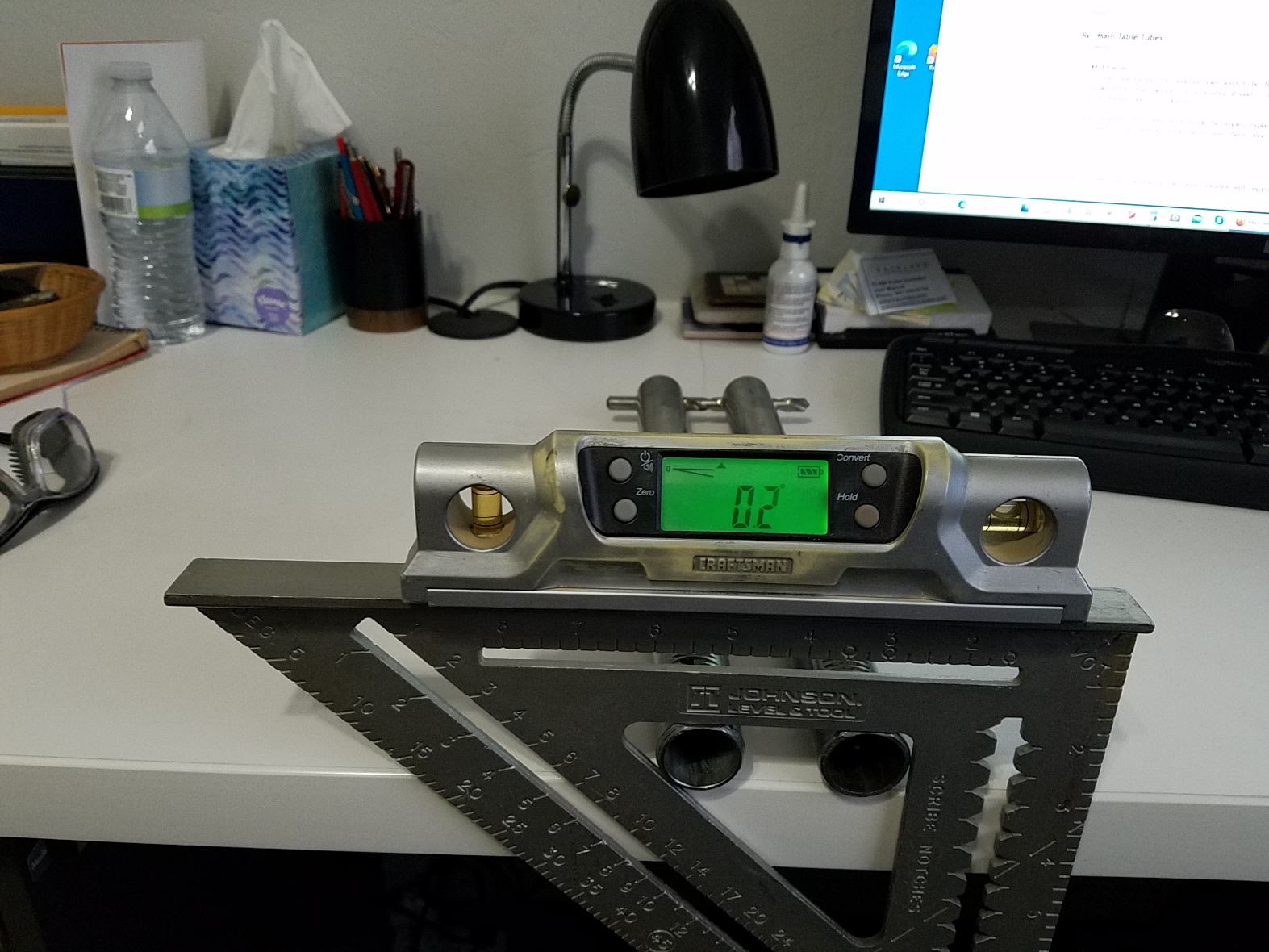

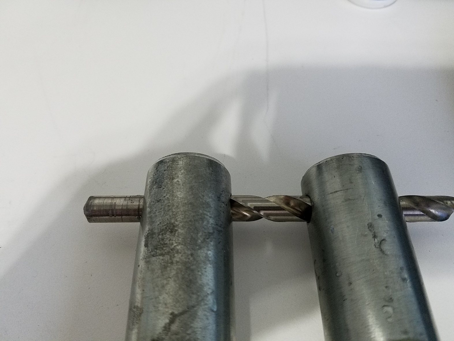

I zeroed my level on the bench top then laid the table legs on the bench top with a drill bit through the holes. Then, using a speed square across the flats in conjunction with the level I measure the flats to be about .2 degree off level with respect to the plane of the drill bit.

That is correct.dusty wrote:... So the holes were not machined at the correct location with regard to the plane of the flats???
.dusty wrote:I zeroed my level on the bench top then laid the table legs on the bench top with a drill bit through the holes. Then, using a square across the flats in conjunction with the level I measure the flats to be about .1 degrees off level with respect to the plane of the drill bit.
That sounds the same (functionally) to me as what I did, unless I'm missing something. I posted pictures of how I measured earlier in the thread when Ed (reible) asked about it. I measured other combinations, but in the pics I just showed an old tube compared to a new tube. The only difference I see in our setups is that I zeroed my level on the drill bit, which I think yields the identical result.
There's an obvious underlying question of what happened between the first ten years of DT/M7 production and now. I'm sure Jim knows, but he did not volunteer the information and I didn't ask. I got the impression of either a change in suppliers or a change in tooling employed, but I could be completely off on that. SS is 100% engaged in resolution of the problem, Jim described the process in detail and they are keeping a very close eye on it.

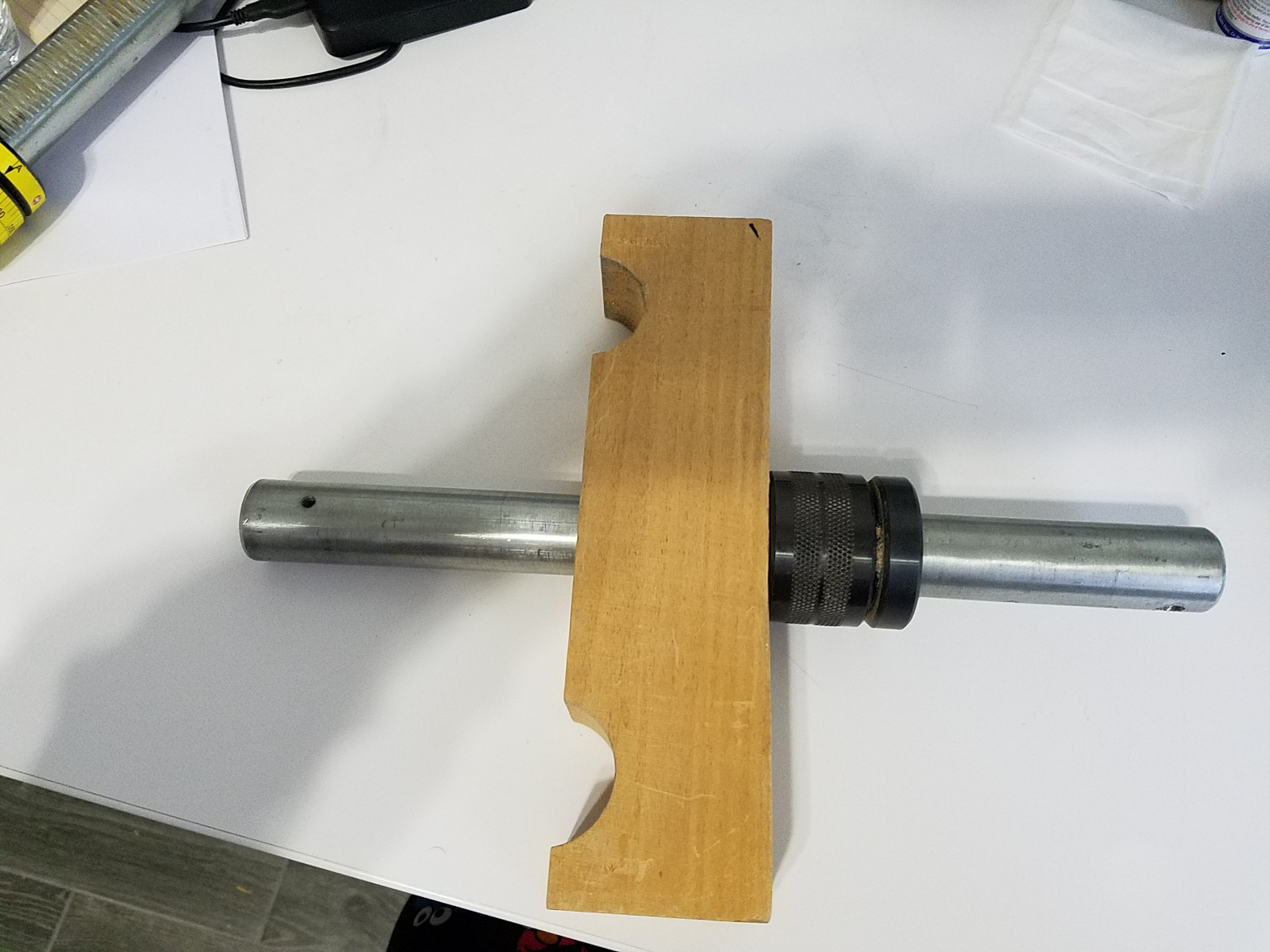

I have had the double tilt installed for about three years. The tables goes up and down in either configuration with no problem at all. Obviously there are differences that have occurred over time.
Don't discard your old table legs. They can come in very handy, I use mine along with the Adjustable Stop Collars frequently.

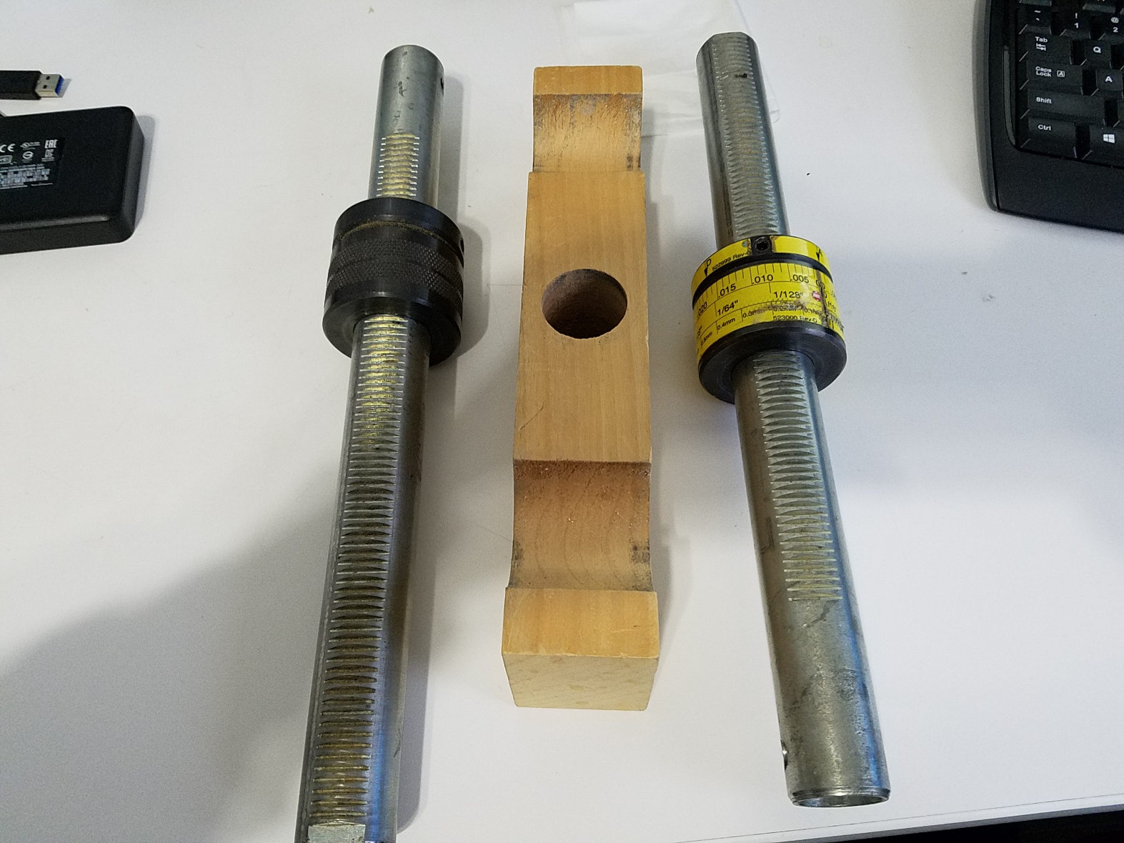

- 20200422_123620.jpg (1.28 MiB) Viewed 12864 times
- As a table height gauge or a table stabilizer
- 20200422_124757.jpg (1.13 MiB) Viewed 12855 times

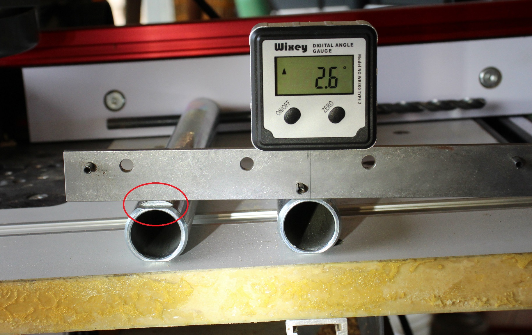

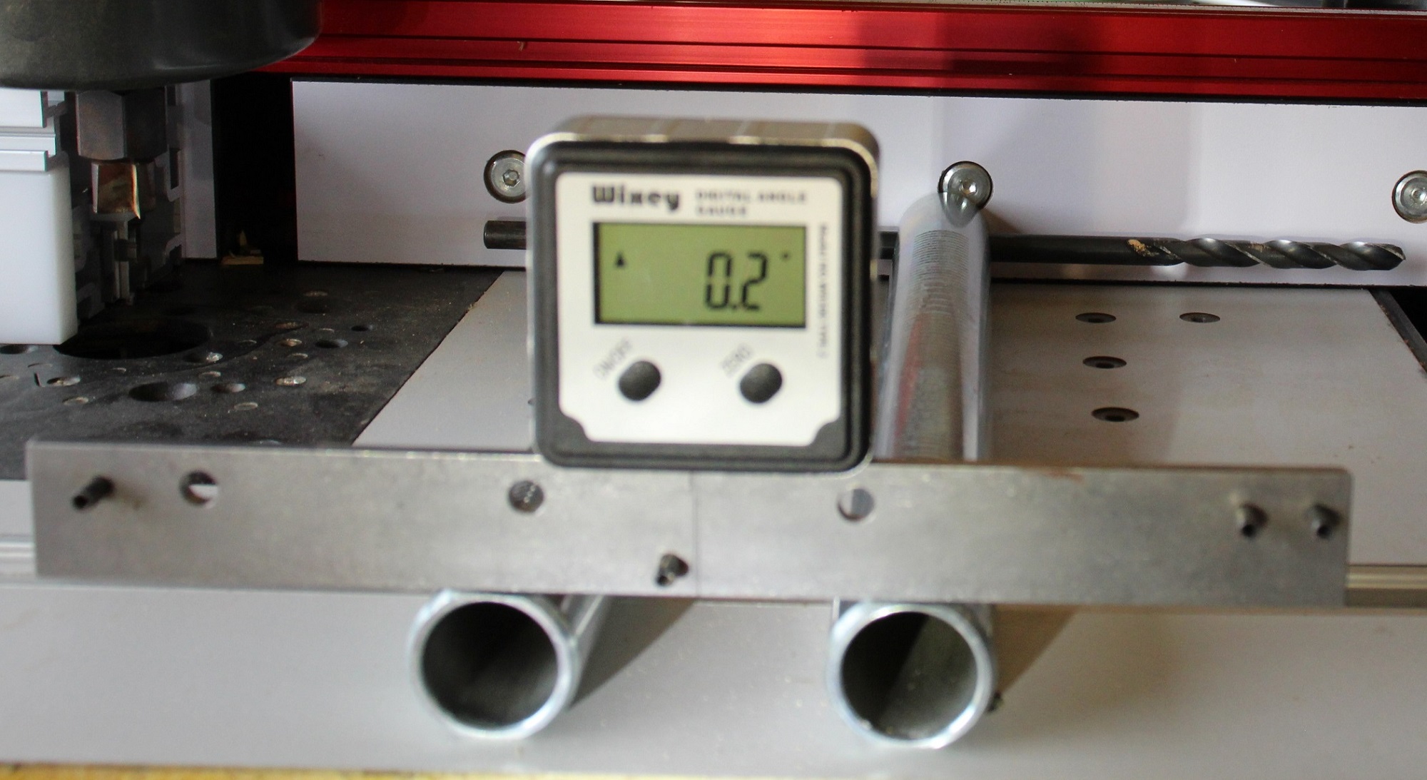

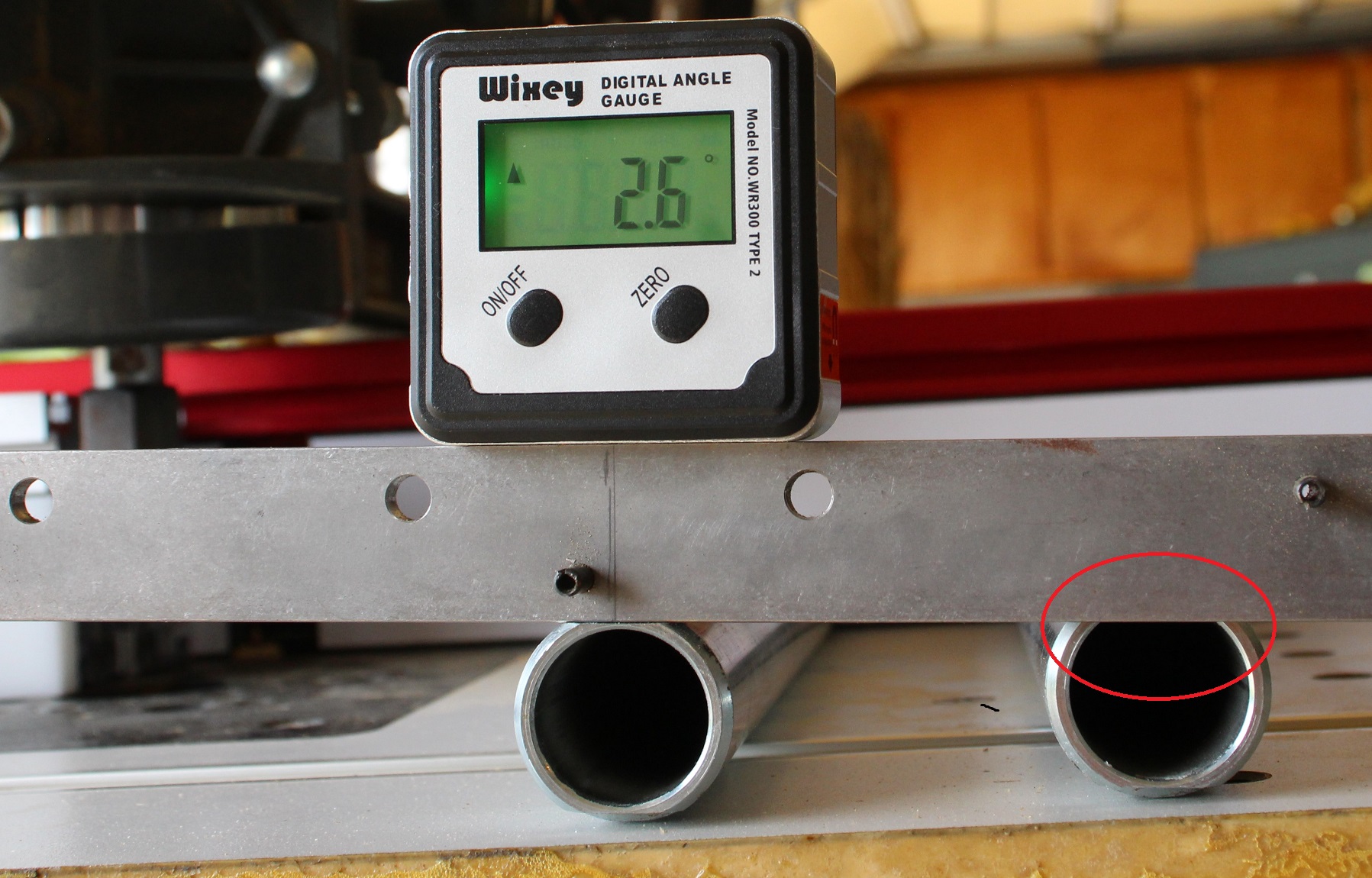

I should have waited for your pictures to post, now I see. Our setups are functionally different, but only noticeable with the bad tubes. Set up more like yours:
This looks good when in fact it isn't. The straight edge is not riding on the flats, but hitting one point on each tube. So your (Dusty's) case is normal, you can measure both flats at once only because they are in the same plane. But this version does not discriminate between good and bad. And it only measures the angle of the flats for good tubes.
In the next two photos the only thing I'm changing is the location of the straight edge to ride on each flat and circling where that puts the straight edge in relation to the other tube: - David

WOW
I admit that I thought your estimate of 2.4 degrees was likely excessive. This makes it clear that I WAS WRONG.
