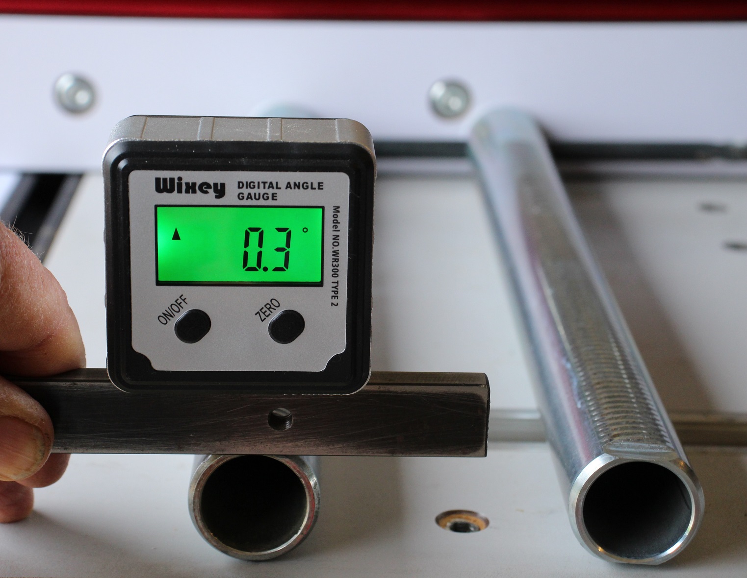

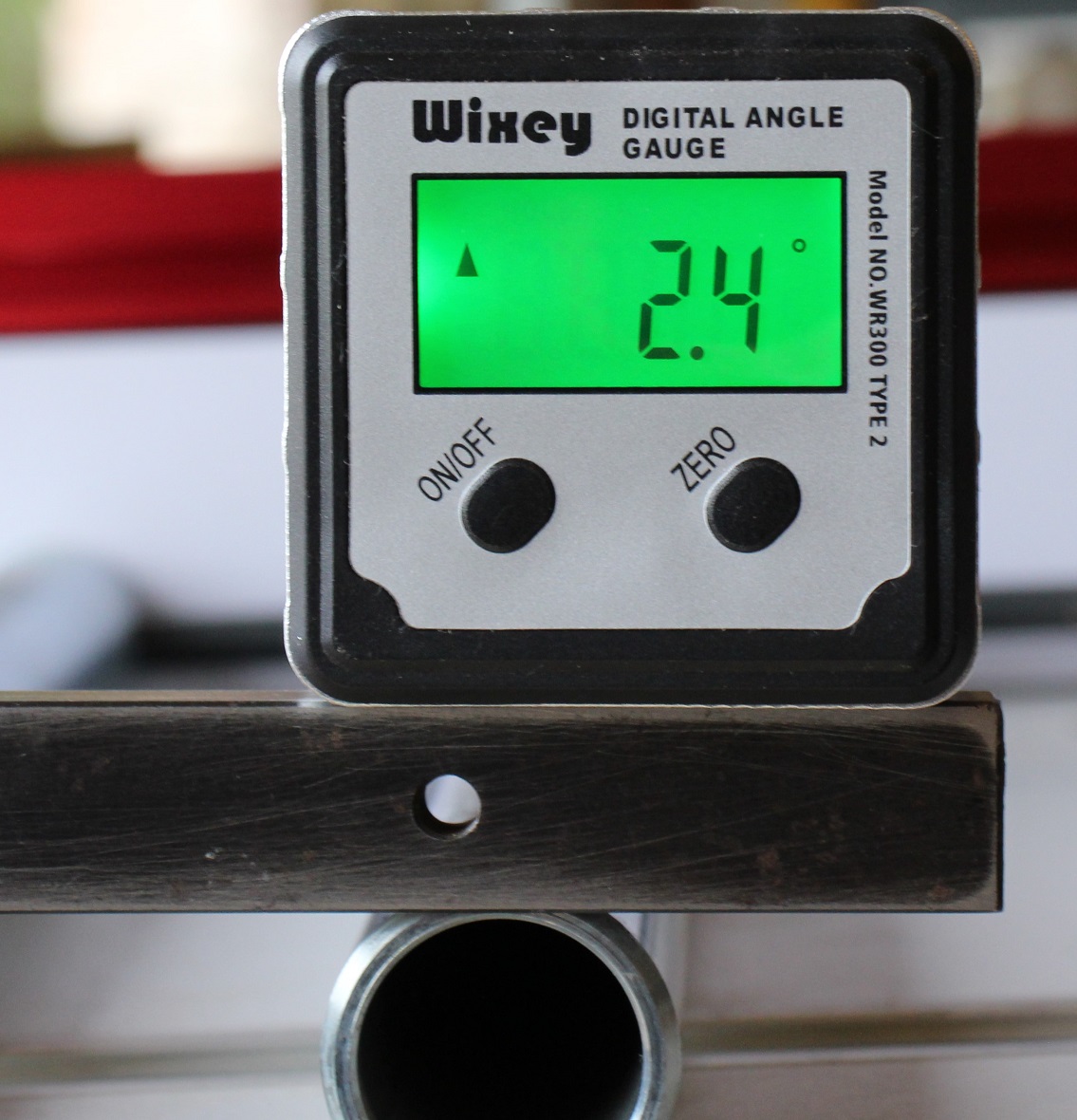

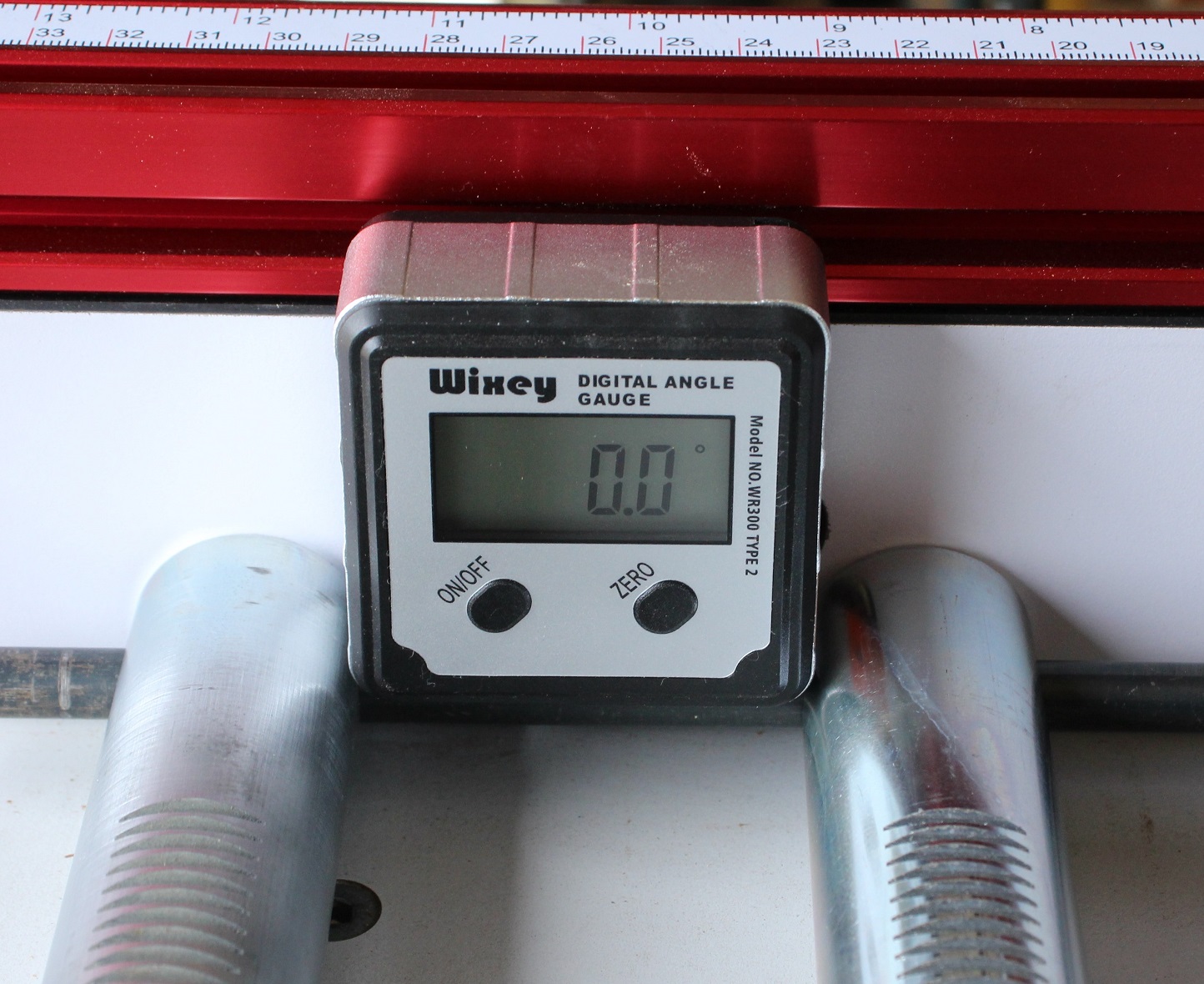

The tracks are parallel with one another. The part of this that has me dumbfounded, why I thought I was missing something, is that it can be wrong, i.e. not controlled by tooling/process/quality. This is how I measured, note that the second photo shows more of the complete setup. All pictures have an original tube on the left and a new tube on the right. I put the tubes on a table with a long 3/8 inch drill bit through both sets of holes and zeroed the Wixie on the shank:
Zero Reference
Zero Reference
I then used a flat bar to feel the flat at the end of the rack. I used a T-Track guide that was handy. First measurement is the original:
Baseline
Baseline
Then the suspect new tube:
New Tube
New Tube
This setup isn't perfect but gave me repeatable results. It was easier to do than to photograph, that 'three hands' thing rearing its head. The sequence of events led to this being a confirmation and quantification of what I had already determined was the problem.
Note - my earlier comment about the original tube error being in the opposite direction appears to be incorrect.
- David

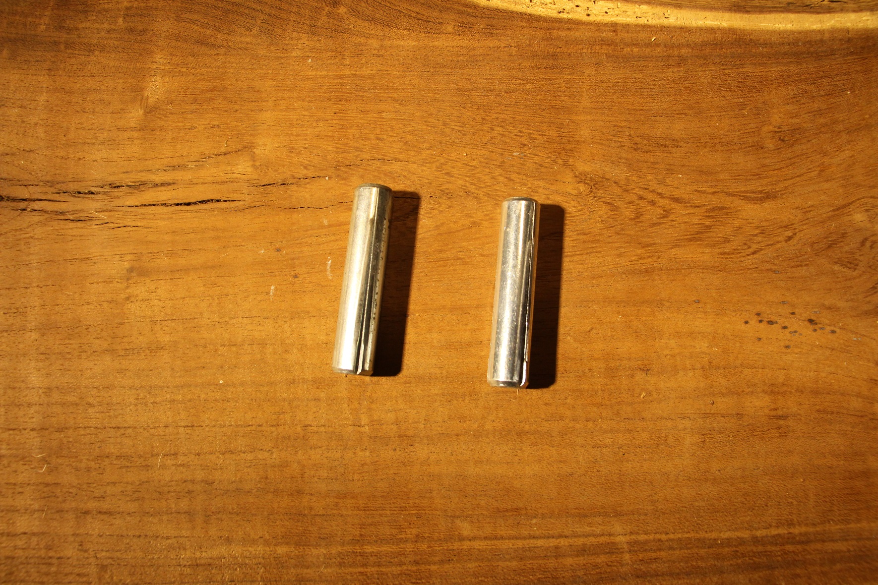

I wanted to add some info to expand on my last post, possibly useful to others. The pins are tapered and also have three grooves down the sides, similar to flutes on a fluted dowel pin. These 'flutes' dig into the metal as the pin is driven in.
Tapered pins
Tapered pins
Since these pins are used you can see near the bottom that the edges of the grooves starts out sharp, then that sharp edge has flattened out some where the pin was driven into the steel leg. The part that remains sharp near the bottom is the portion that only goes into the aluminum tie bar.

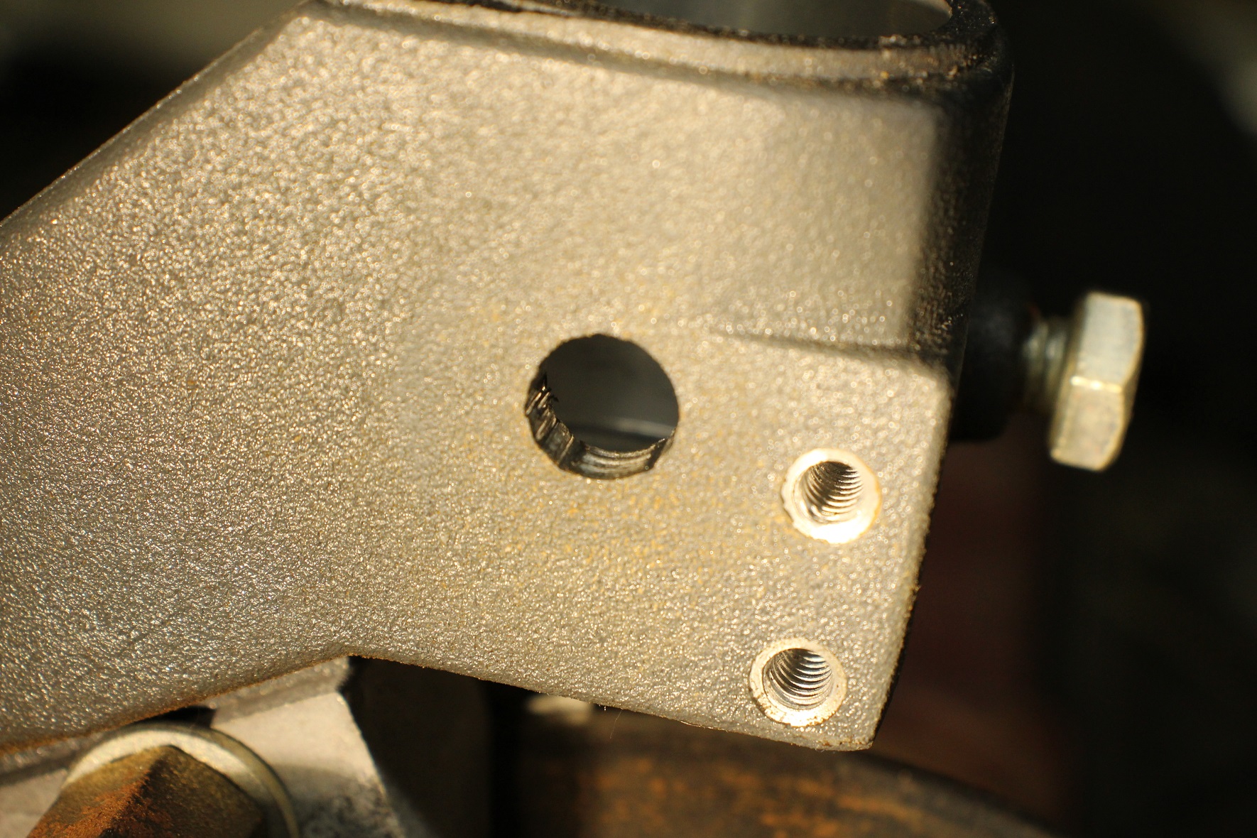

Since the pins are tapered both the 'flutes' and impact are more pronounced at the outside of each hole. And since the tie bar is aluminum while the pin and leg are steel it is more pronounced on the tie bar. This is what my tie bar looks like from being pinned twice:
Tie Bar (Front Outside)
