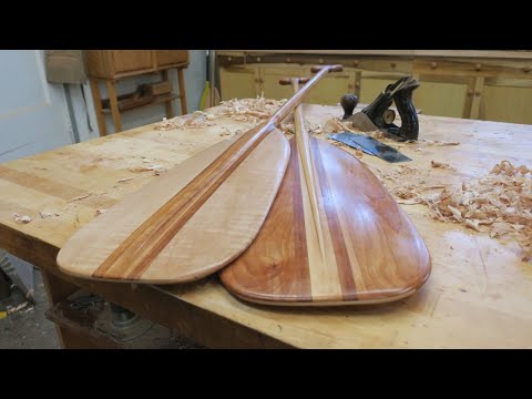

Making a Canoe Paddle Time-Lapse
Post by Chad »
Nick Engler's Workshop Companion
Watch it here: https://www.youtube.com/watch?v=HEk8vbUHw2Q
The strongest canoe paddle ever! Author/craftsman Nick Engler builds a wooden paddle with a reinforced tip, reinforced grip, and a unique spine that buttresses the blade for those occasions when you need to push off. Just what you need if you must occasionally use your paddles for poling as well as paddling. Additionally, this is (mostly) a hand tool project that you can make from scrapwood. Nick glues up the paddles from small bits of contrasting hardwoods, then shapes them with planes, rasps, and scrapers.
If you enjoy this video, check out our Workshop Companion Channel: https://www.youtube.com/channel/UCk480B ... hMfkBjhDpQ
And if you want clear, concise information on any woodworking topic, visit our Workshop Companion web site: http://workshopcompanion.com/

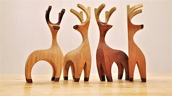

Scrapwood Reindeer
Post by Chad »
Watch it here: https://www.youtube.com/watch?v=W335wRy ... =11&t=123s
Get the patterns for these reindeer sculptures from our store at:
https://workshopcompanion.selz.com/item ... USYPRRQ4uE
Nick shows how to make a deer with just a few quick cuts on a band saw. It’s a handy technique called “compound cutting” and it can be used to make all sorts of three-dimensional shapes. These particular reindeer are sized so you can cut them from scraps of 2x4s. Or, glue up blocks from different species of scrapwood.
