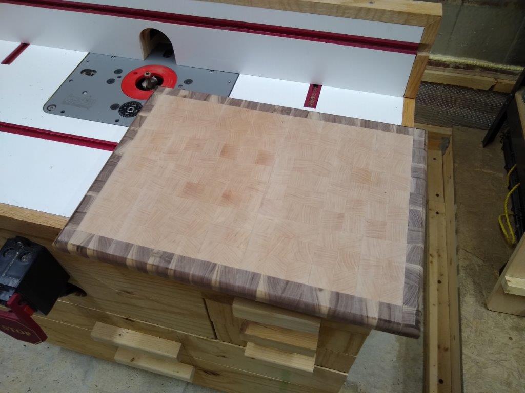

Thanks everyone -
Since i had already mounted the conical sanding disc, I gave that a try first.
Taking really thin passes, I was able to lower the worst offending steps I had without breaking any glue joints.
I then flattened both sides a bit more aggressively and I'm back in business !
I did create a few tear outs on the end walnut pieces by going to fast at the end of the strip..but I think those are fixable.
Fingers are pretty tired from pressing all those strips past the sanding disc in a 1 inch gap, but i still have all my fingerprints- so no harm done :)
b

bainin
Posts: 569
Location: NC
Re: Suggestions needed ..
Post by bainin »
Getting closer now.
The conical sanding disc (atleast the one I have mounted) is prety rough..I'd guess 60-80 grit.
Im surprised everyone was cordial enough not to ask how my boards ended up different thicknesses given that I said I had a planer ...
Anyways- In my excitement, I forget to plane everything prior to glueing haha.
Now I burned the cherry a bit making drip channels (not shown)...
