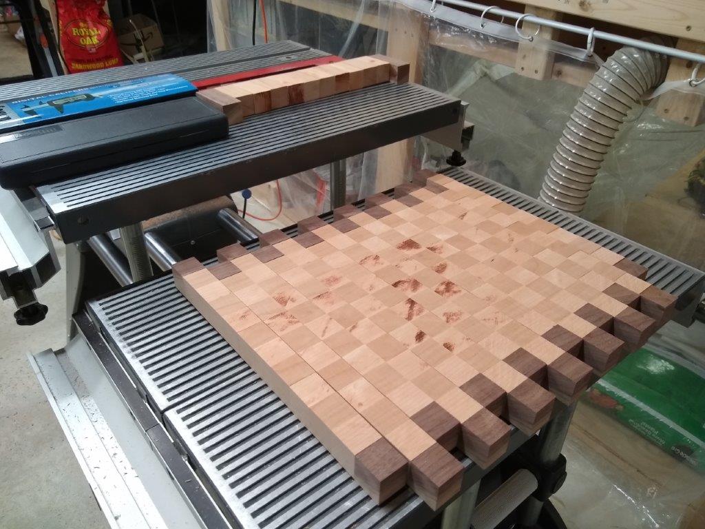

I want to build walnut/cherry end grain cutting board..so after cursory views of the process on various youtube videos I dove in.
I ended up at this point where I have strips (1inch wide by 12 in long) made from roughly 1 inch cubes of walnut/cherry glued together which i have rotated to misalign the end grains.
The end grain surfaces are smooth and well aligned to each other, however the edge grain sides (which ultimately get glued together along the 12in length) have some small steps along the 12 inch length where the 1 inch cubes didnt completely align on gluing.
So I'm looking at my saw, jointer, planer, and disc sander and wondering which approach would be the least stressful on these wimpy little 1nch glued surfaces to flatten those 12 inch sides to allow for a good glue up ?
Your thoughts are appreciated.
