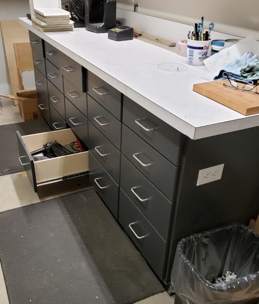

Wow, 3/4" sides and bottom! You will be able to fill those drawers with gold bars - as long as the slides you choose can hold the weight. I used 1/2" sides/front/back with 1/4" bottoms (all Baltic birch plywood) and I would have no problem filling those drawers with lots of heavy stuff. Guess it depends on how big your drawers will be. The ones in my shop are about 15 x 20 and plenty strong enough.
