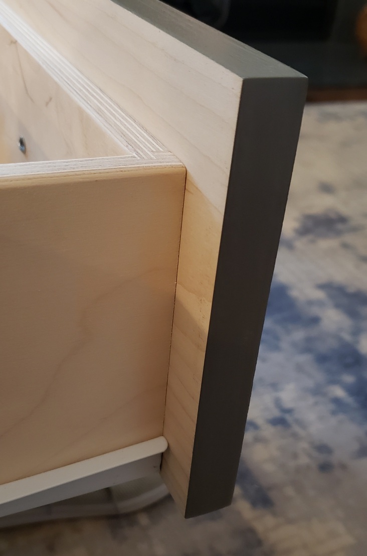

I am thinking I will try this and maybe scale it up to 3/4 Baltic Birch from 1/2” using 3/8 - 3/8 - 3/8 for 3/4” for some drawers holding heavier materials.
The ratio would still be half the stock thickness.
Very helpful. Thanks for the pictures

What do you do with the exposed ply edge on the right hand side ? Veneer?
b
Re: anyone done quarter-quarter-quarter drawer system
bainin wrote:What do you do with the exposed ply edge on the right hand side ? Veneer?
b
You attach a 'pretty' front.

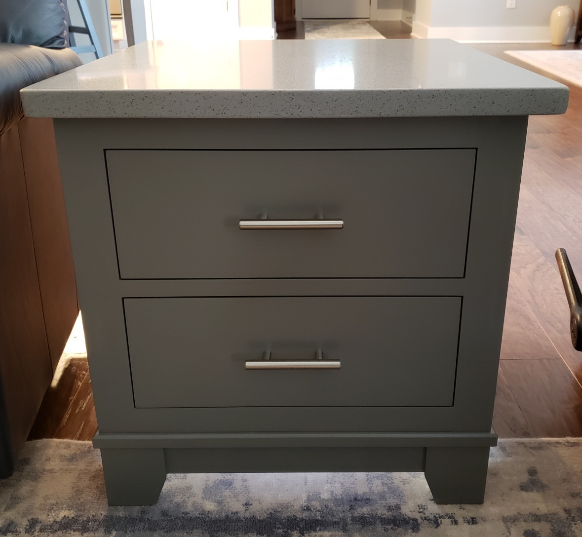

This is a small table I finished about a month ago where I used these joints for the drawers.
