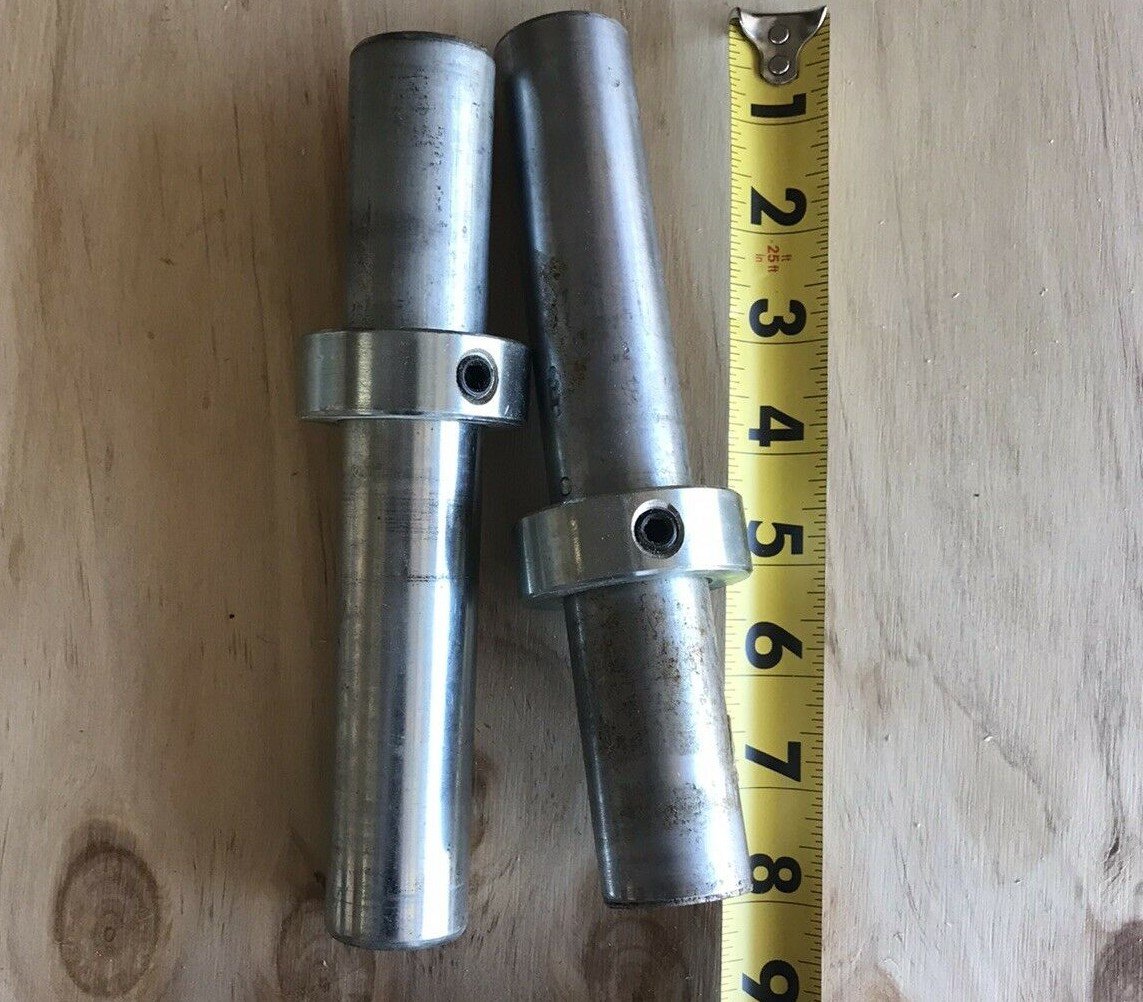

JPG wrote: Tue Nov 10, 2020 8:22 pm The short straight jointer mounting tubes have a snap ring that provides a vertical stop/support(as do longer straight spt mounting tubes).
Snap rings - makes perfect sense. I've never seen those. My Bandsaw tubes look just like these from ebay with stop collars: https://www.ebay.com/itm/Shopsmith-Stra ... SwidZfobfp
Straight w/ stop collar
Straight Tube.jpg (259.98 KiB) Viewed 1054 times
The only difference I can think of is that the stop collar tubes allow the tubes to seat all the way to the stops inside the bandsaw.
- David

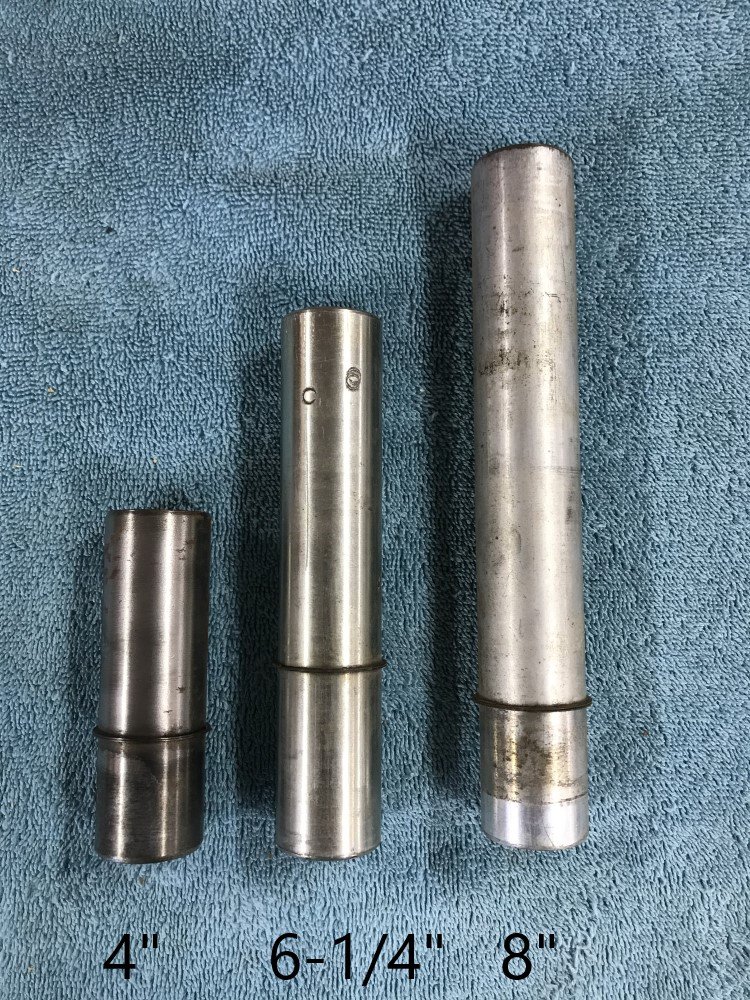

We started talking about Jointer mounting post but have continued on to the Bandsaw. My 1956 Bandsaw has straight posts with stop collars as David showed above. As far as I know these were the original posts for it. This type of post would then likely be the original one used for the Bandsaw which came out in the Summer of 1955. I also own a 1996 and 2006 plus I owned and sold a 1985 Bandsaw which all have the standard eccentric posts. Straight Posts with snap rings were common early on but were later replaced by the eccentric posts in most cases. Below are three different lengths of the straight posts with the snap rings for different SPT's.
Lengths given are overall length
Straight Mounting Posts.jpg (312.51 KiB) Viewed 1031 times
